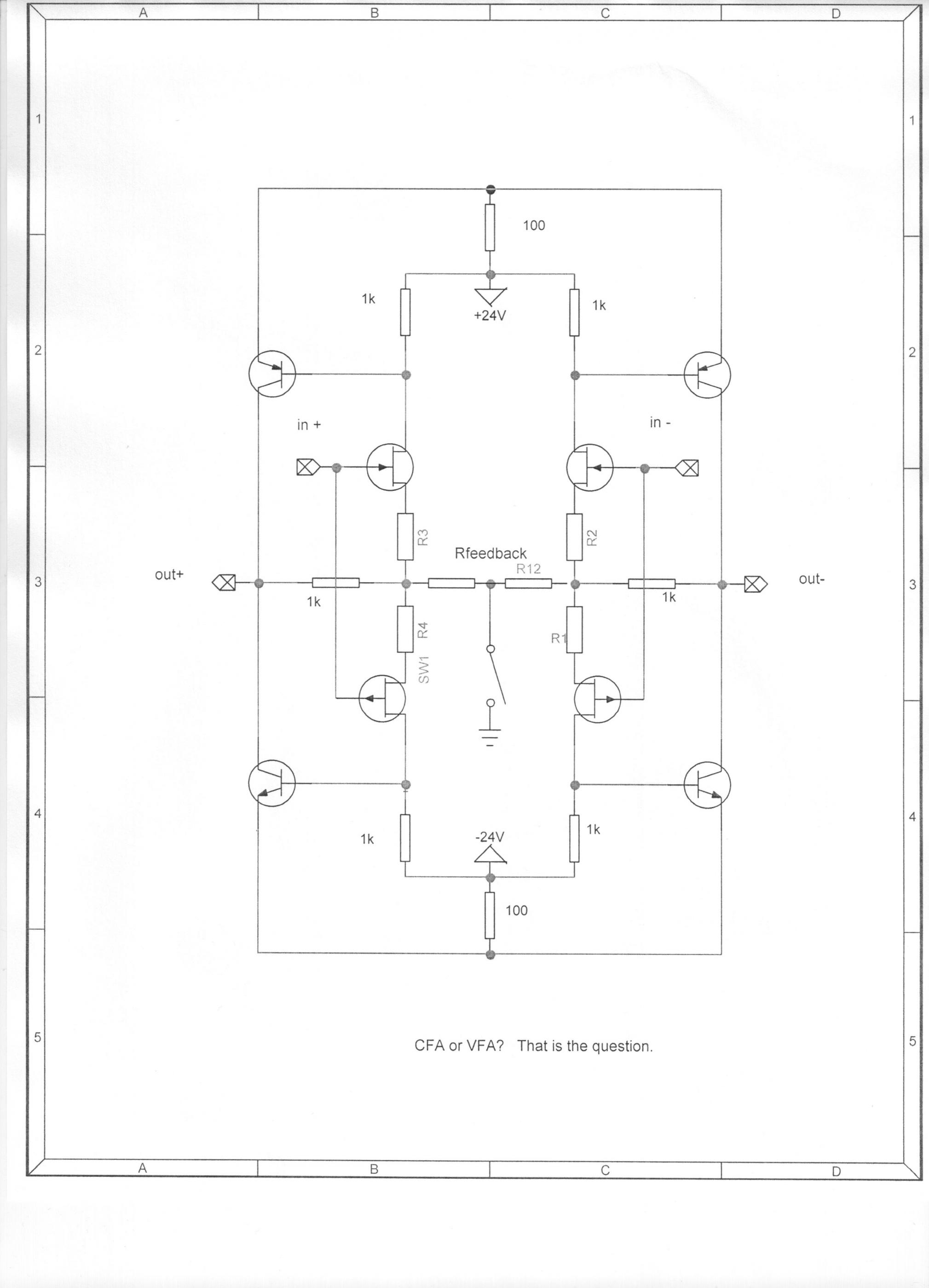

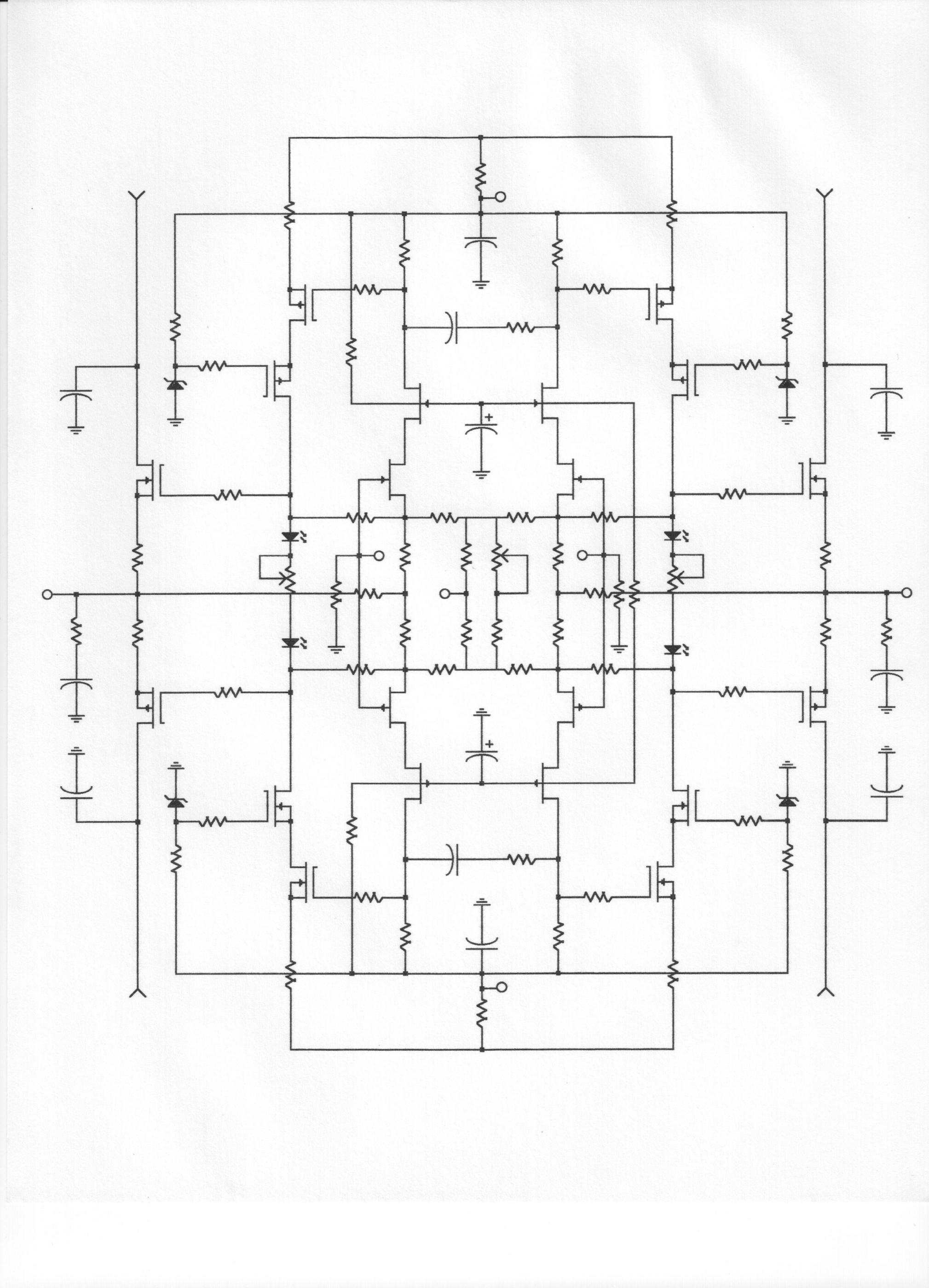

I agree with Richard (I think). This topic has pretty well run its course, except for petty squabbling about definitions and such. The inherent simplicity and slew rate advantage of the CFA has been diluted by excessive complication and added features, like balanced input. The schematics that I put up should have shown this to you.

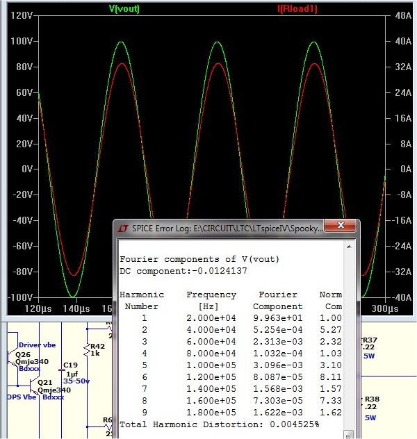

Done as well ?? Ha.. -120 is normal at 2-300W ??
Got other ones that will do 50ppm at 1Kw. 😛
AND at THD20 , as well ...

its hard seeing the novelty in the THX patent claims - the 1979 JAES Vanderkooy, Lipshitz Feedforward Error Correction in Power Amplifiers paper expresses the combining impedances/balance equations as abstract Z terms - clearly allowing interpretation as R and C, and networks of the same as well as the more common Walker/Quad L,R output combining part types
nor as mentioned does 1 ppm 1 kHz thd spec impress any competent high feedback amp designer

You mean a competent armchair designer, right? Or you mean the numbers achieved with a real amplifier, real product?
