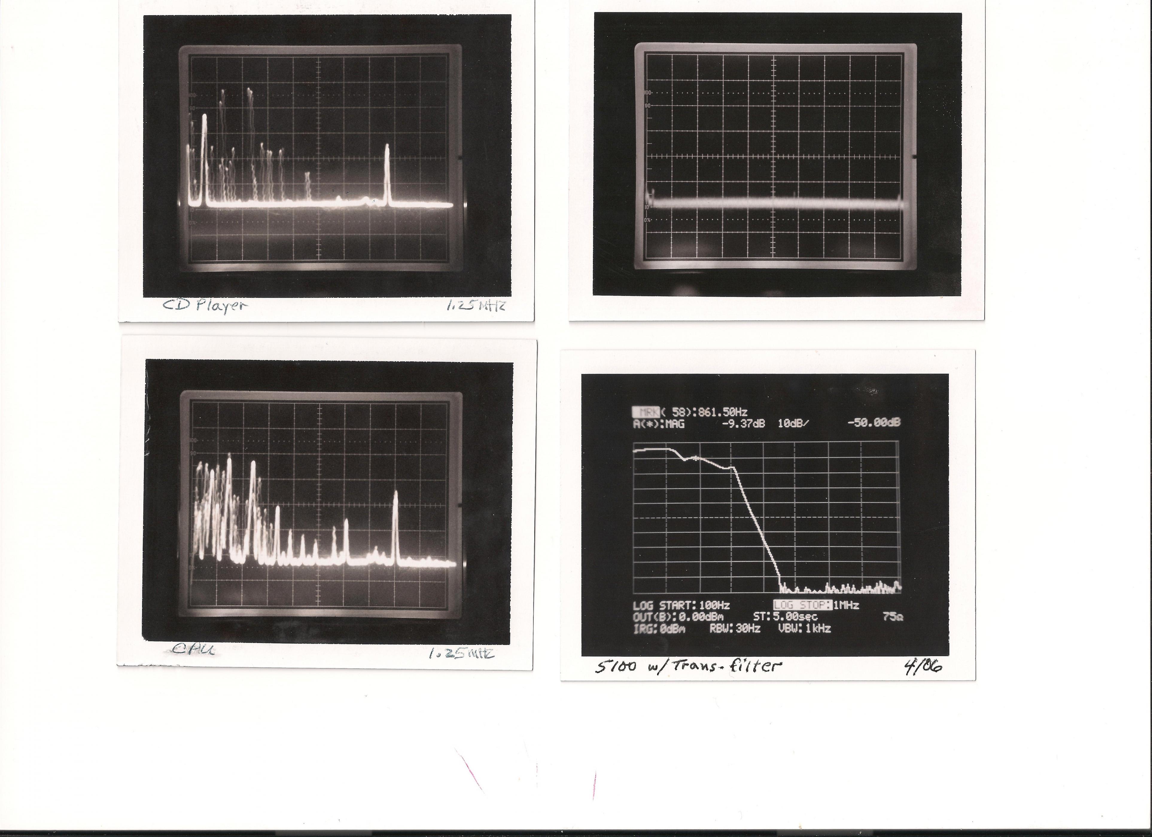

More and more equipmnt have smps inside. TV's, computers, of course, and it produces a LOT of emi/rfi on the ac power line.
Filtering and equipment to equipment isolation is required if you do not want to spread and distribute that all over the ac lines where other equipment is also plugged in to it.
Thx-RNMarsh
Ignor these pictures.. I dont know how to remove them.
Christophe,
I may be wrong on this point but I think what Richard is saying about the EMI/RFI of a smps is not its own inherent immunity to those things passing through them.
You mean switching frequency residues and their harùonics ? Well, good SMPS (poor exists like the one witch was in my Brehinger 2496 ;-[ ) can have a very good noise factor, on my point of view. Care has to be taken for good cabling, filtering AC lines side as well as output side and shielding, of course.
Christophe,
Yes my concern is that with many smps units they will produce their own radiation that we have to watch out for being picked up by a cable or even a board trace and injected into the circuit. Like you observed with the Berhinger you just mentioned. This was always such a common problem with audio cards inside of PC computers in the past I just shy away from those power supplies for audio use because of this.

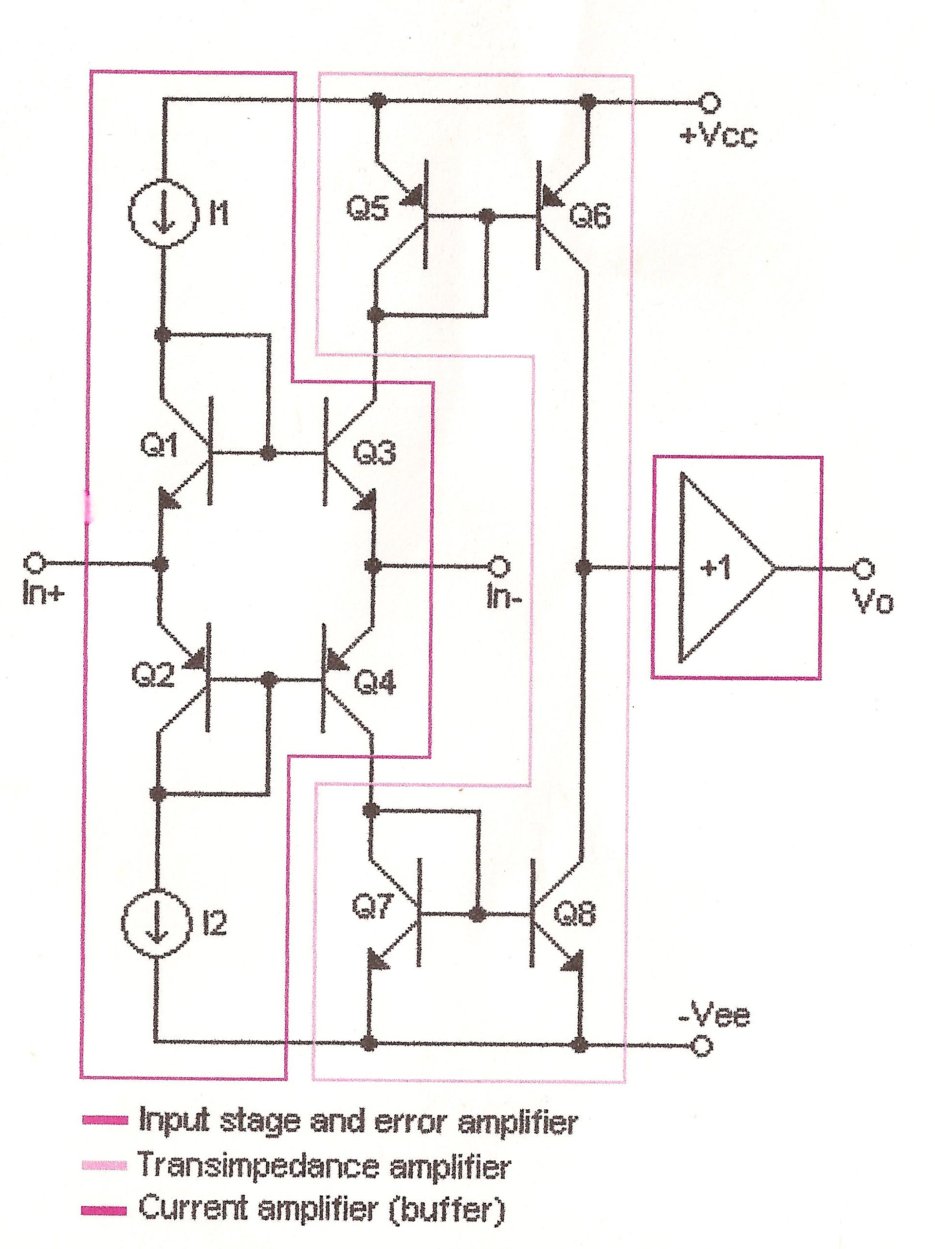

Hi Richard !
I like that schematic ! ,
I see there one Very Stable circuit !
I think that for simple power Amp application Current Conveyers ( +1 ) part can be very easy formed from two standard power N/P lateral Fet`s pair , directly driven from Q6/Q8 .
Best Regards !

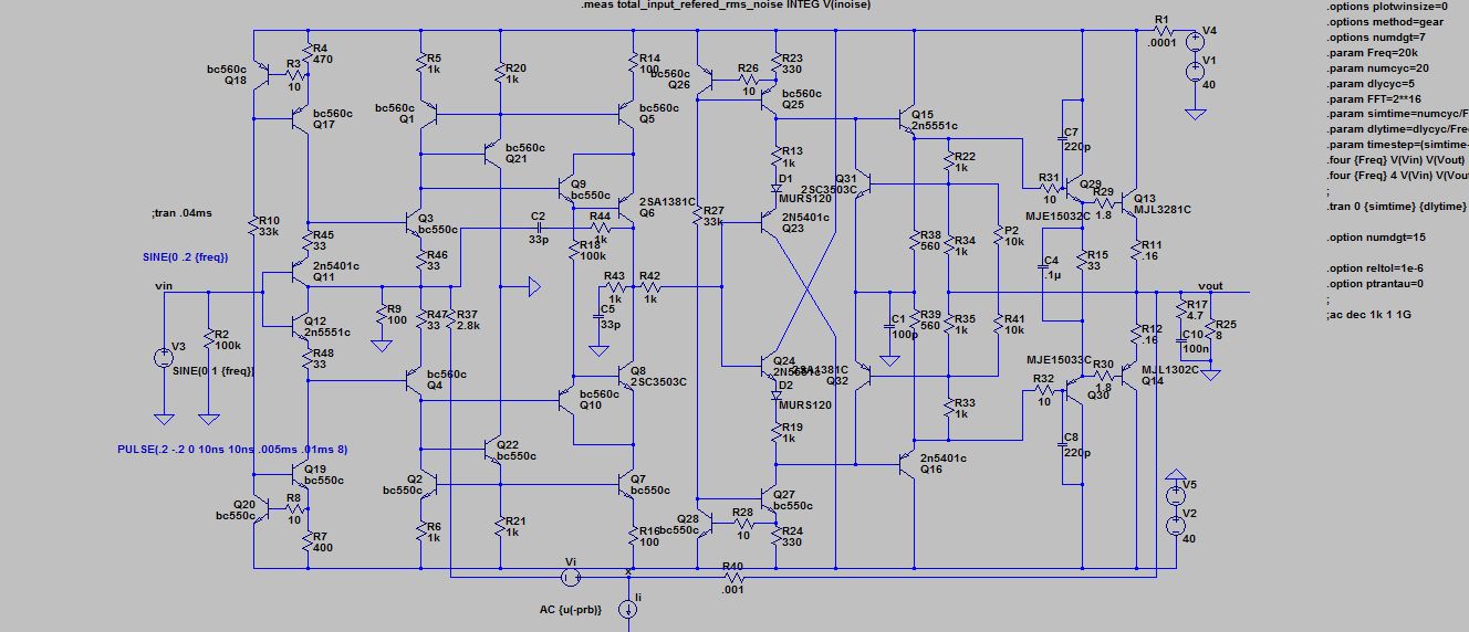

The circuit in post-375 is at the heart of many power amps Yorkville Sound designed for PA use, beginning with their AP500 mosfet output amp, and continuing in various forms to their current model range.
Dadod's circuit in post-380 is nice, embodying nested feedback and HEC.

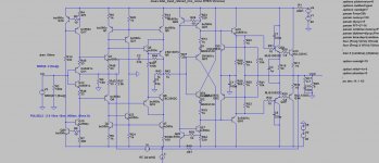

Damir,
As noted in one of your threads, nice work.
It would be beneficial to show the high loop gain, and since it's always a topic the slew rate with and without the 2nd order compensation.
With a cfa what is the motivation to encompass the input stage within a nested loop, or is there a significant advantage given its linearity to start with?
Don't mean to pile on work for you but could lead to interesting discussion.
