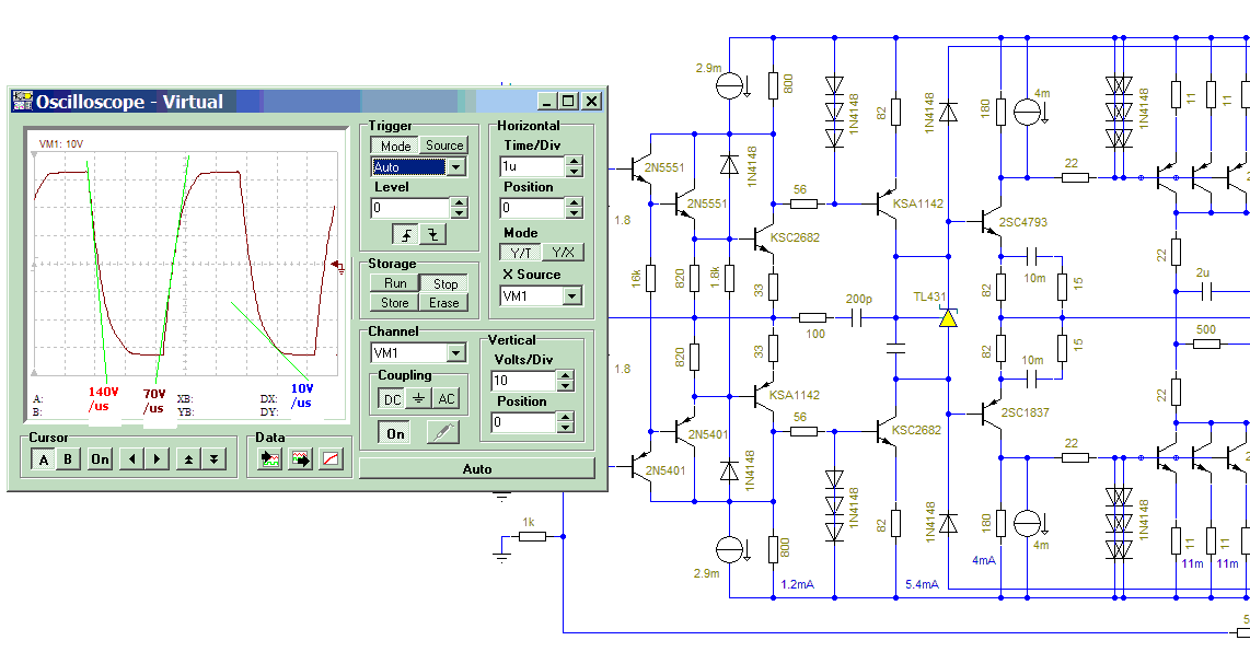

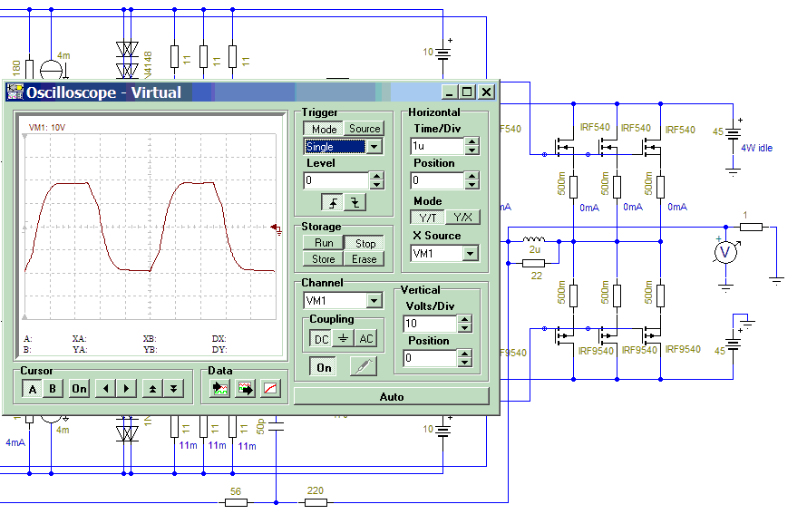

Bob
1V/uS for each peak output is good enough for your ears, not my ears. Absolutely, your ears and my ears is different. I know the different how my VFA amp with 0,06% THD sounding againts VSSA.
The need of 1V/uS for each peak output is marketing only 😀.
It is rather 1V/us/Vpk , about 40V/us for a 100W RMS amplifier
and still Waly is quite generous since even half this value is enough.

Hi wahab,
You are correct; 1v/us/Vpk is fine. At that SR, there are other, much more important, things to focus on in amplifier design.
