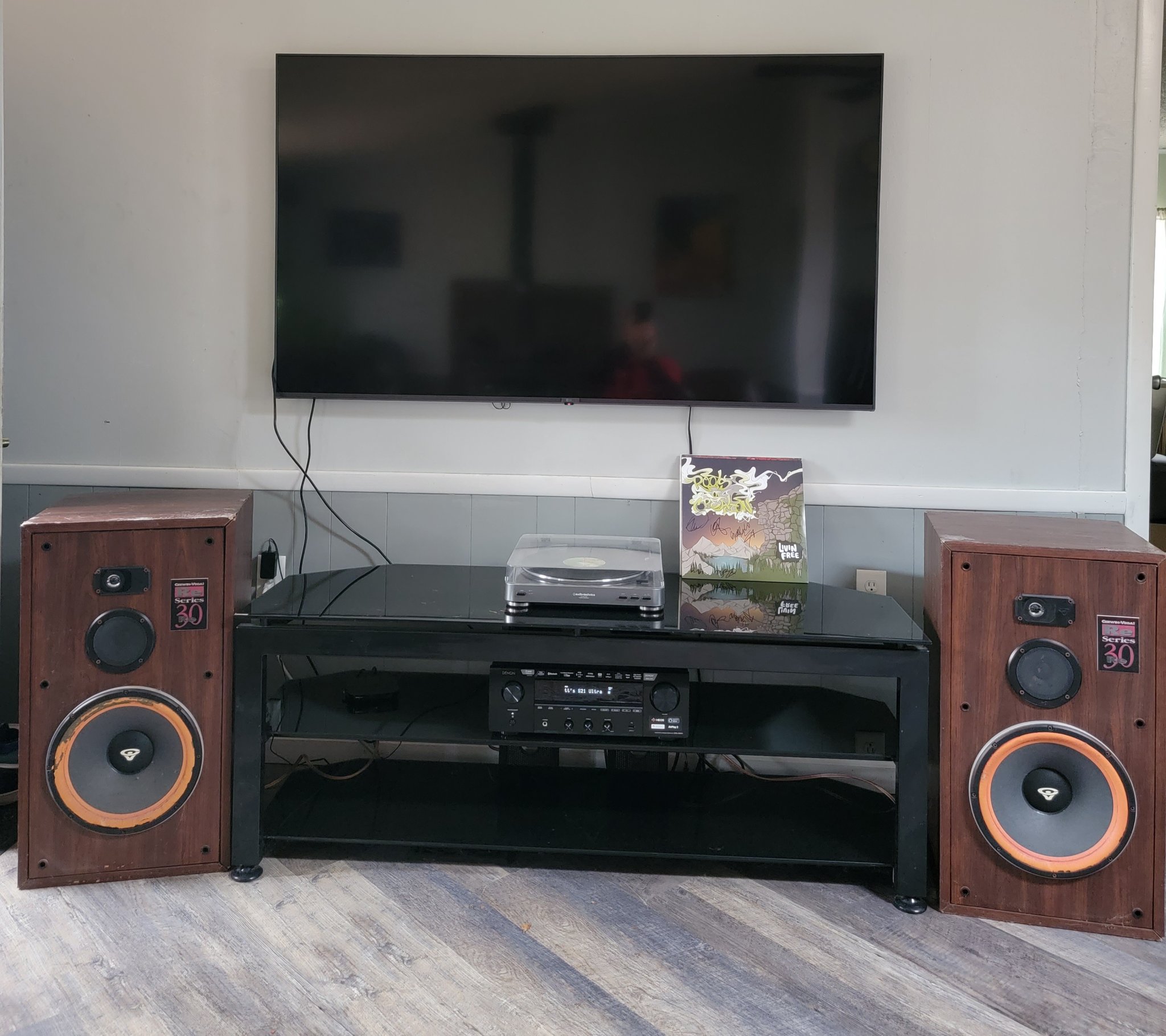

While playing music outdoors for a friend's kid's grad party, a rogue storm rolled in fast and blew the tent covering my system off while it was playing before I could get to it to turn it off. Strangely the amp still functions, but both speakers are completely dead. They appear dry inside, I checked both fuses, and they seem fine, and still no sound from any part of the system. It breaks my heart to think they are done for this world, so looking for ideas on what I can check or try before giving up on them. Thanks!
Set multimeter to measure DC resistance and check the loudspeaker terminal. Assuming midrange and tweeter have any kind of high pass filter, the measurement would show you woofer voice coil dcr and any LP inductor dcr that may be in the circuit. Check drivers separately also. While doing that, push woofer cone to see if it makes any scraping noise.
How do you know that the amp still functions? Did you try other speakers with the amp?
It's very unlikely that both speakers would suddenly develop the same problem at the same time.

Thanks guys. I'm no electrician or tech guru, but managed to take a driver out and got this reading.
No scraping when pushing the woofer cone, but I did hear a clicking each time meter probes connected. Also, not sure what this means, but there is no reading when I touch probes to the speaker input terminals on the back of the speakers (where speaker wires connect) but when I did that with a working pair of Pioneer speakers I did get a reading. Could it be in the circuitry behind the back panel (see 2nd pic)? As mentioned, the fuses don't appear blown, but does that necessarily mean they aren't?

This means that the woofers (and likely the other drivers) are ok, but the fuses may be bad. Replace them.
Test the fuses by replacement, not by looking at them.
If that does not fix the problem, look inside the speakers for loose connections, broken parts, etc.
But it's probably the fuses.

The clicking sound is GOOD when you're measuring the woofers out of the box....sounds like the fuses are bad, did you measure them directly?, looking for a dead short, many times they can look OK, but aren't.

Ok, I think the fuses may be bad, which would be a godsend. I'll pick some up tomorrow and try. Tempted to wrap the fuses in tin foil to test, but Don't want to turn a simple fix into a nightmare, lol. You guys are awesome, thanks. I feel a little dumb, but wiser for the comments. Appreciate all your input to help out. I'll post results tomorrow night.

All is well after replacing the fuses. They didn't appear blown but apparently were. Next is to refoam these babies and restore the original sound (although they sound really good as is). Thanks everyone for your input!
