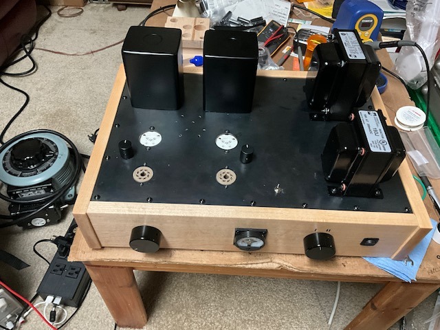

Tubes won’t fit. These are Audio Note, from Parts connexion (I’ve written them moments ago), pricey little beasts, silver-plating, UK craftsmanship (probably sourced outta Sri Lanka or some former colony) bought ‘em Sept 26, 2023, never thought to even TRY ‘em out until today. Curious if anyone has ever had this issue.
Locator pins on every tube from 1940’s-modern mfr (Sylvania, NU, GE, Tung-Sol, various Chicom and Russky tubes) will not go into the Audio Note too-small locator holes.
What’s worse is, tube-savers, and 6F8G/6C8G adapters don’t either. At all. Don’t even make pin contact.

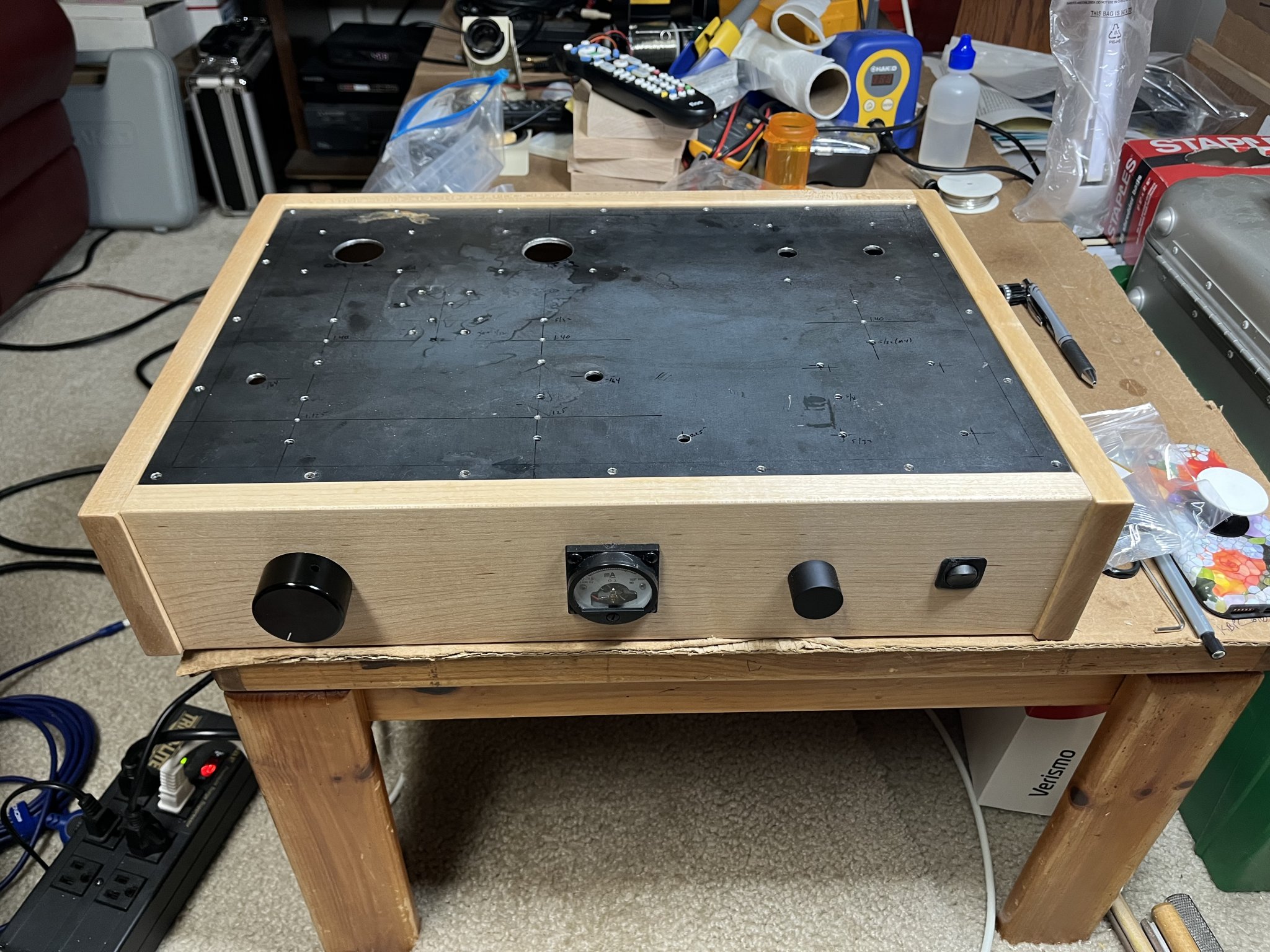

I just got all the socket holes cut out this weekend, I have some other ceramic sockets but the tops are closer to 1”, not 1.125” and distance from mounting screws is too close to use.

Just get some Belton sockets. They're a little on the tight side, but fit perfect.

I just looked these up, measured the deck on my amp. Hole center-center is ~ 1.47” - these would work. I’m not in THAT big of a hurry, can order and have them here middle next week or weekend.
Going to wait to hear from Parts Connexion. If they can sent ones that WORK, I’ll still use them, but otherwise will order some Beltons.
Thankfully the AN UX4 mounts are just fine.
Never did hear back from PC. I’m making a trip up into Ontario in the coming weeks for something else, I’m seriously considering starting an international incident by taking the sockets directly to their store (do they HAVE a storefront?) and demanding a refund.
Bought the Beltons. Had to enlarge holes in mounting plate just a little, but otherwise good stuff.

I HAD several sets of those "saddle ring" sockets on hand, but had already cut the steel upper deck/plate for the other sockets' dimensions.
Moral of the story is, DON'T trust that something will fit, work, based on reputation alone; test everything, trust no one.

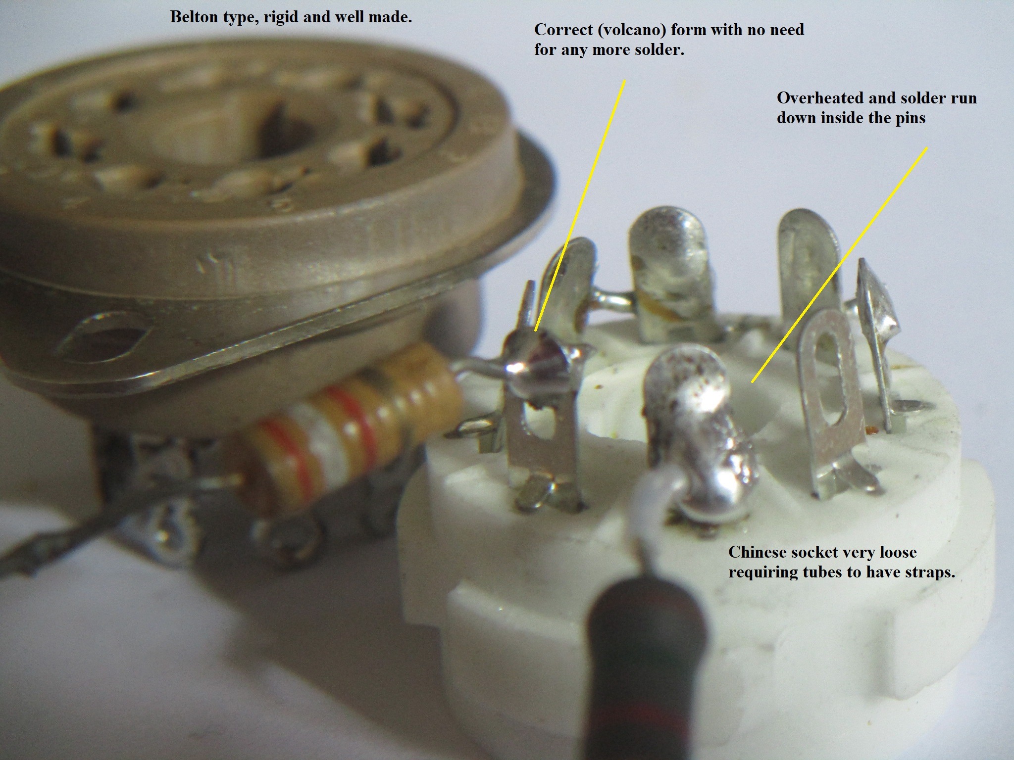

Quick pic; one of the big faults of the Chinese versions, they are too sloppy so don´t overheat the pins as the solder will run down in amongst the pin tension creating a dodgy contact. I cannot count the number of times I´ve had to replace them when HiFi amps start making odd noises.
