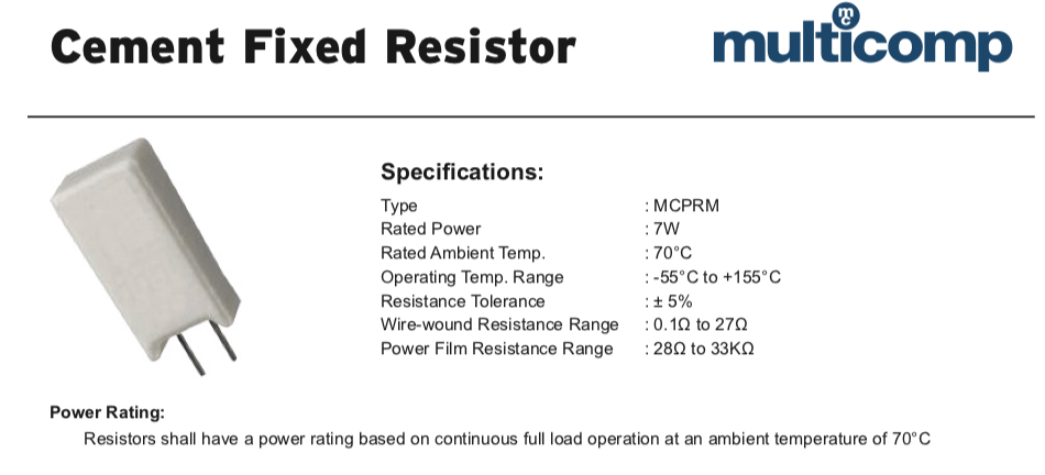

Hope this helps. According to the attached spec sheet, Cement resistors are rated at 155 degrees C based on continuous full load operation.
The usual issue is the leads are clipped too short. The resistor should sit about 1/4” above a PC board. That extra lead length allows some heat to dissipate before it reaches the solder joint. It also creates a higher thermal resistance to the joint, also decreasing the solder joint temperature. The other benefit is the increased heat dissipation from the resistor body. The longer leads often solve the unsolder problem.
