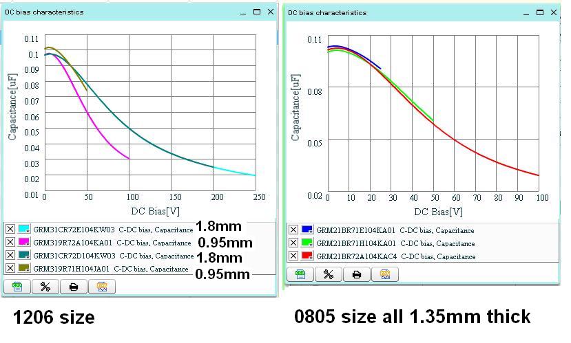

X7R has advantages as an HF decoupler in two ways: small so low inductance, lossy so damps any resonances. Its poor thermal stability and high voltage nonlinearity are irrelevant as a decoupler, but make it almost useless for many other purposes.
Temp and voltage variation of ceramic caps, or why your 4.7-uF part becomes 0.33 uF
View attachment Temperature and Voltage Variation of Ceramic Capacitors.pdf

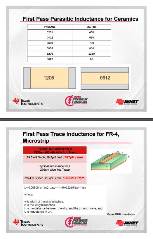

Dan the value of the decoupling capacitor is in a way irrelevant... there is a wealth of information regarding decoupling capacitors out there, having spent 30+ years messing with decoupling and power delivery systems for both digital and analogue circuitry I can tell you nthat on EVERY design I have worked on the decoupling capacitors have been X7R ceramic capacitors, with the odd COG/NP0 in places and on some designs X5R larger reservoir caps to get the size that will fit near the devices (when you are using 0201 decoupling caps the circuitry is pretty dense).
The critical factor for a local (next to the pins) decoupling capacitor is inductance and thus size of the package. If you look at the graphs for certain caps and their size once they go past the peak point in the graph they are essentially inductors and are of no use at higher frequencies.
DF96 says the use of class 2 ceramics (X7R,X5R) is limited to certain areas of the circuit where their tolerance is not going to have a detrimental effect on the circuit function, as also your links show as well... But this is what engineering a circuit is all about choosing the correct parts for a particular part of the circuitry, for domestic audio this is easier because of the limited operating temperatures, when you get into the -55/+125 temp range things become even more problematic.
There are a wide range of capacitor types available, for DIY where cost and space constraints are to an extent quite relaxed you can engineer a circuit and choose parts that are suitable for the job...
Further on high speed digital designs even the position of the vias connecting the caps to the relevant pins/planes can have a huge effect on the end result of the decoupling caps, get the via placement wrong and the cap inductance is so great that it becomes useless at the required operating frequency...

From manufacturer' website.

As said inductance is the problem when decoupling, even then the caps are only good up to a few MHzs (20-30), the BEST option is planar capacitance created by using power/ground layer pairs with very thin dialectic between the plane pairs. Many of the newer BGA devices will also have some decoupling in built on the interposter PCB that forms the BGA device.
If you are doing Class D designs the 0612 type devices are a good design choice for both resistors and caps used as they minimise stray parasitic inductance on the layout leading to a better design. I have done a couple of layouts using these packages, not only do you decrease parasitic inductance ( a benefit in these high dI/dT circuits) but you also get improved thermal benefits for resistors as you have a lower thermal resistance due to the longer solder connections to the board relative to device area.
