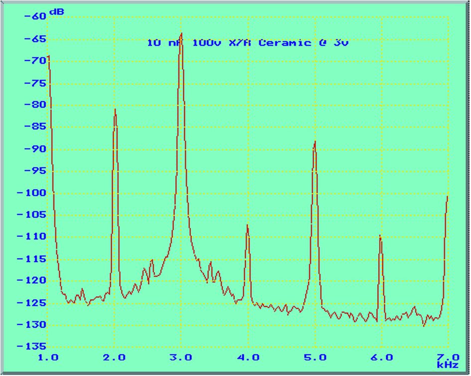

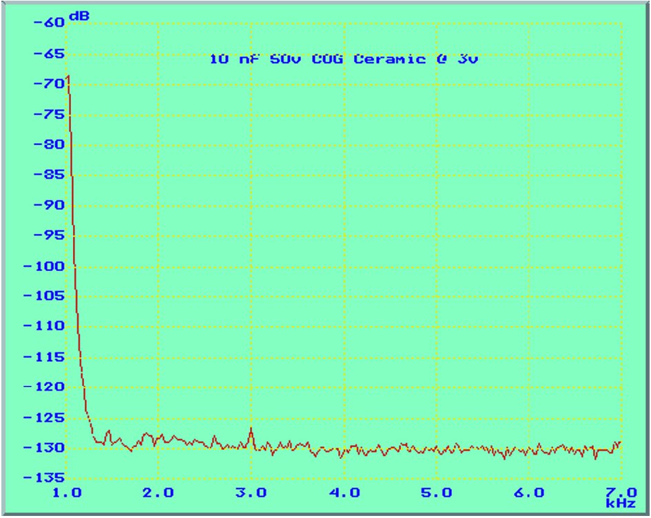

C0G capacitors have excellent dielectric characteristics which compete with better film varieties: low distortion, low DA, low DF. X5R capacitors, and its siblings, are another matter entirely having dielectric characteristics that compete with the worst of electrolytics for Worst Capacitor Ever.
Seeing as I mentioned the dreaded X5R, here's a distortion plot of an X7R. Says Cyril Bateman who performed the test generating the plot:
"This 10nF X7R ceramic was made by a CECC approved, European manufacturer. It was tested at 1kHz and 3 volts, in series with a 10k ohm current limiting resistor. Measurable distortion exists at all voltages down to 0.5 volts – my lowest test voltage."

that's some difference -63db (x7r) reduced to -127db for the C0G.

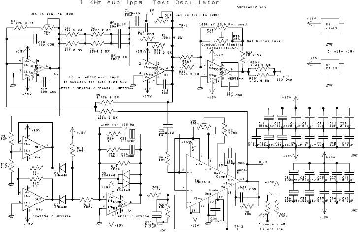

Thanks for the plots. Do you have the test configuration diagram?

Yikes that'll break my eyeballs. Way too much detail. Couldn't even find the DUT. Would it be possible to draw something highly simplified? do it have DC bias with resistor impedance? AC generator levels/imp @1KHz, spectrum analzer used, etc
Alternatively if it's really a bother links on the web for tests like these that are handy. sorry this is interesting for me.

Cyril's circuitry isn't the best for the application - considerable simplification can be had with indirect nonlinearity measurements of IM differences - no need to build a low distortion oscillator, better recent 24 bit sound cards can also add ~ 20 dB resolution vs his setup - esi juli@, emu 1212m are < us$200
