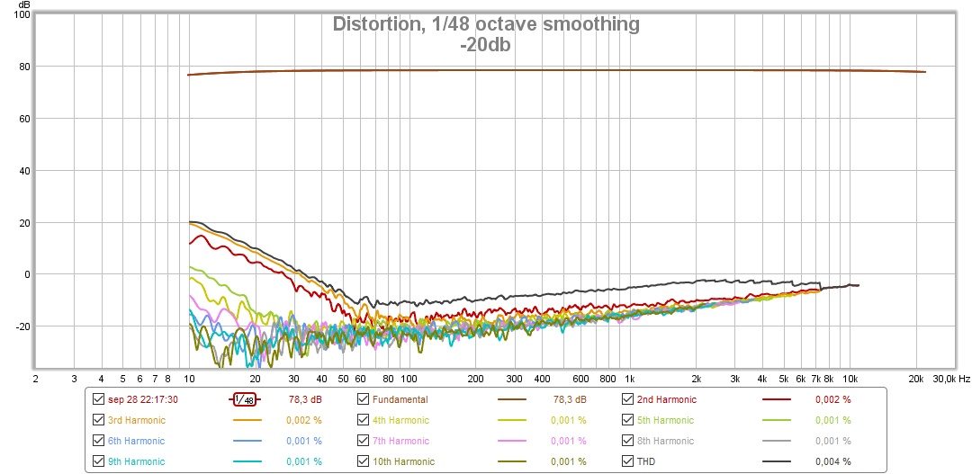

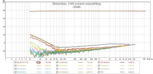

A diversion:
I have bought some of these and removed the output cap and muting.
IT002 Digital to Analog Audio Converter DAC Converter (EU Plug) - Free Shipping - DealExtreme (or eqal)
Original they are quiet, but with the 0604 output cap they have a lot of distortion at max out. (guess it is class 3 cap?)
As you see the distortion is nicely spread. Maybe it sounds i little warmer?
'At -15dB the distortion is at -80dB which is OK.
(Modded I now remove the DC at input of a multichannel amp. The input is a MiniDSP nanodigi)
(The SPDIF receiver and DAC are from firms that has been in the game for a while.😉)
