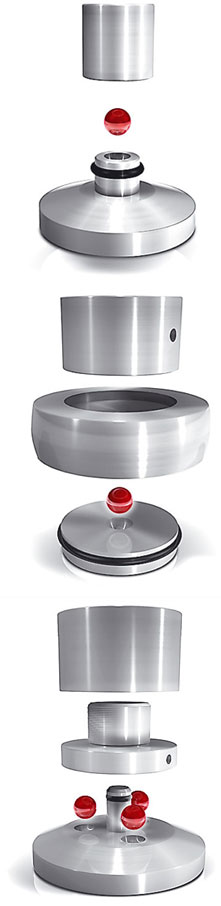

Decky, thanks a lot for the offer. I have send you an email.
The reviews are really enthusiastic about this product, so it could be interesting to try something similar.
The company also makes this Resonator:
http://www.finite-elemente.de/en/products/resonator
Thats a new concept for me and seems even more "snake-like" to me😕 The price is a bit scary too.
Good or not, the feet looks pretty cool.

It is not only the balls. Finite elemente have good ideas but their implementation is not the best. I was planning to build something different (that is why I bought the balls in the first place). To save some words please see the attached drawing. I can go in details why in theory ceramic balls are better then steel but in this geometry even steel balls have a considerable effect.
As you can see - the lateral stability very low but the balls cannot roll-out because of the spherical seat.
Regarding the price - it depends a lot on SIZE then the material and the precision - surface roughness. Mine AL2O3 balls are class 25 roughness and they are around 5$ Silicone Nitride ones are class 5 and they are $8. For comparison - precision steel bearing balls most usually come in class 100. The higher the class the looser the tolerance.
Smaller ceramic balls are readily available but I had a bit of problems to find something around 10mm for this price.

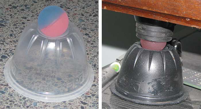

I have been playing with a frugal-phile(tm) variation on this idea. I haven't gotten around to trying steel or ceramic balls yet -- i have been using the 10 for a loon mini-super-balls from the dollar store.
I plant these on top od a Dole fruit cup container that i fill with solid (mostly been using left-over Silent Running SR-500 damping compound (i use it for stiffening/damping frames)).
Picture shows the basic bits and the 2nd one of the ones holding up my Rega.
dave
