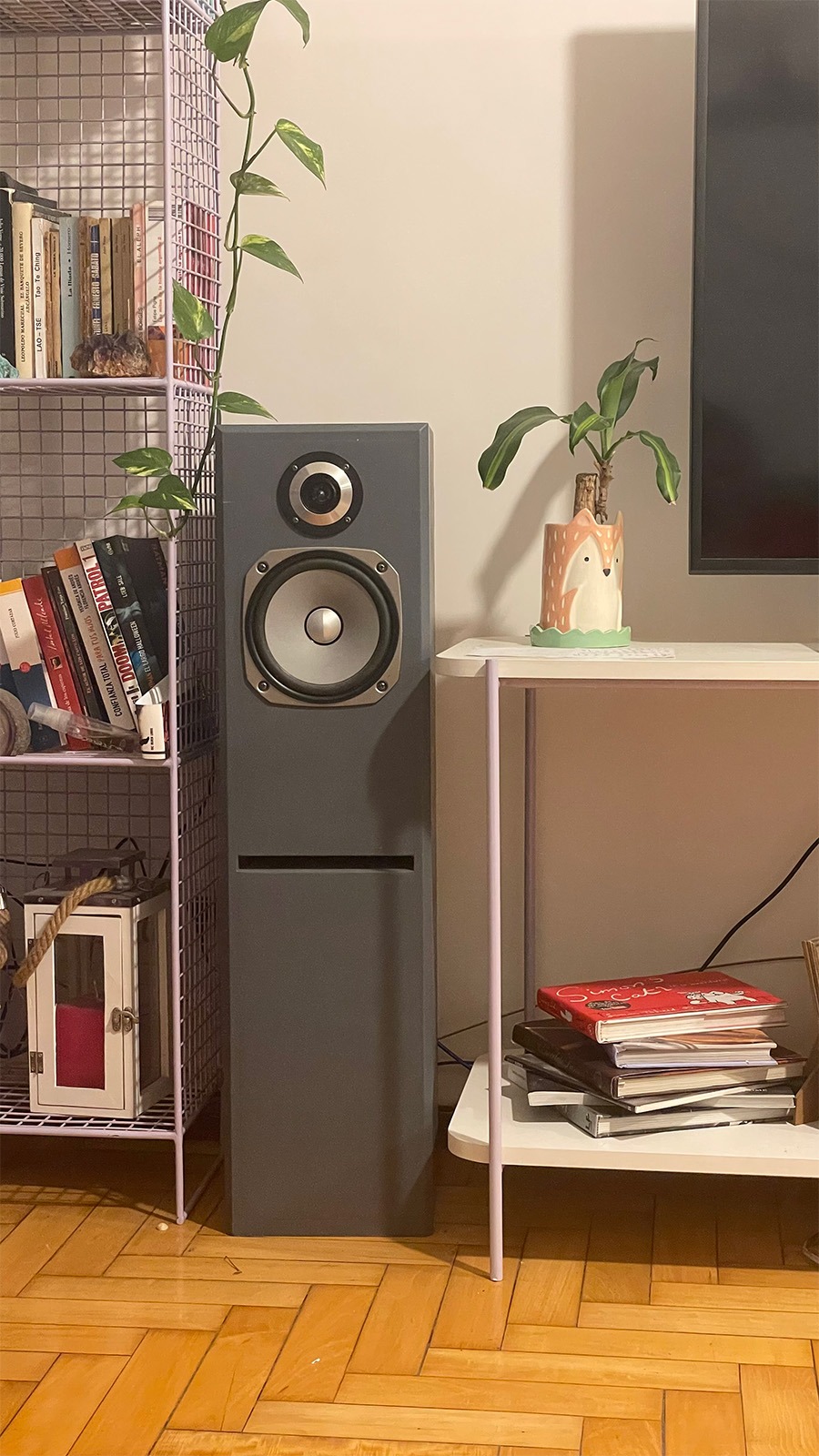

Some time ago, I built a pair of Fostex Speakers (picture below). The drivers are FF165WK and FT17H super horn tweeter and the design is bass reflex following the FF165WK bass reflex enclosure recommendations.
http://www.loudspeakerdatabase.com/Fostex/FF165WK
https://www.madisoundspeakerstore.com/bullet-tweeters/fostex-ft17h-horn-super-tweeter/
Now I want to build the center speaker (and in a near future, the two back speakers to complete the 5.1 sound for my living room).
I've never built a center speaker with two drivers, so I need some recommendations. For the center speaker, I have two FF125WK and another FT17H.
http://www.loudspeakerdatabase.com/Fostex/FF125WK
Shold I double the volume recomendations of the FF125WK or there is a more complex calculation for bass reflex with two speakers in series?
Thanks 😀

There are substantial reasons why you don’t want a side-by-side MTM.
And given the FT17 crosses as high as it does, the combo does not make for even a good vertical MTM.
The FF165wk doesn’t really need a tweeter, but it does from having some of its rough edges smoother off.
Here is the FF165wk centre channel miniOnken that accompanies teh FHXL.
https://frugal-horn.com/downloads/centre/Fonken165-smCentre-130813.pdf

Greets!I've never built a center speaker with two drivers
To reiterate, not a good plan unless you design based on polar response and IME cross fired on a bifurcated baffle based on desired coverage angle, which in turn makes it pretty much limited to that one HT layout. 🙁
Right 2x net Vb, 2x vents.
Every center speaker that I saw in the past was a MTM
Yes, marketing department over the engineers. Given the oft-needed centre with a low height, and the penchant for 2-ways, the tweeter beside the woofer would work better but look strange. so mtm-h. better, IMO, to just use a FR,
