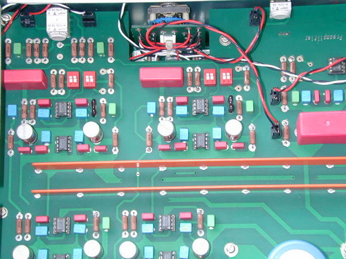

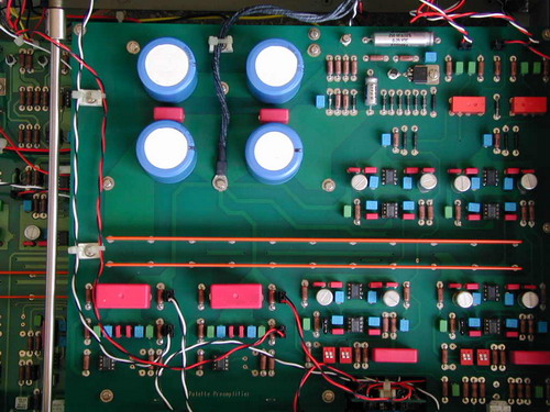

I see................ a lot of opamps
You care to tell us the type?
[The strong point of John Curl and Tom Colangelo was their discrete circuit designs]

yes, yes, the types of the opamp please - if possible ... and better quality pictures would be more than perfect.....if there is a possibility for that..... 🙂

I’m so glad to see those pics of the Cello preamp internals. Considering the money they fetch, I’ve always wondered if they were built with truly exotic and unusual methods and parts, or if they were just hype. I see they are just hype.
Not to impugn the design, but jeez, look at all the sockets, connectors, op-amps, loosely twisted wire pairs, bundled wires, etc. Sorry, but this simply doesn’t look like a low/middle-four-figure piece of equipment. Sorry if (that) I offend, but this looks like a $500 preamp smothered in subjectivism and sales hype. I’ve read purists totally condemn op-amps, let alone dozens of them in a signal path who would probably worship this. Considering its age, wanna bet those PCBs are copper – oh wait, isn’t copper completely audible and sounds horrible?
Anyway, thanks again for posting the pics. This just further confirms my feelings on op-amps and subjectivist whacko’s.

The Cello shown here full of opamps seems to be from the shaft of James McCullough.

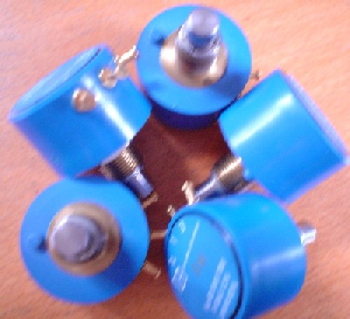

It's very surprising to see Sfernice pots on a unit costing that much money... From the channel tracking tests I've done (I once worked for a firm that used Sfernice PA11 in commercial quantities), they're really nothing special tracking-wise, even the 10% variant. The feel isn't up to much either. There are many pots I'd put in front of the PA11, not least because of the PA11's fragility (ask any Tech who repairs Focusrite gear).

The Palette is not the work of Matthew-J, but still Levinson/Colangelo's wrong doing.
The critical eye would have noticed that the Cello manufacture adress on the back of the Palette is the same as Viola Labs, Viola also offered upgrades for the original Cello products in later years.
The Palette was intended as a consumer model at a third of the Audio Palette cost.
Cello sold only 5 dozen of the +$20K Audio Palette, even in the late 80s that's a poverty figure.
The cheaper palette was likely an attempt to enter a niche market with bigger sale numbers before the financial doodoo hit the fan at Cello's.
The rotten potentiometers were highly criticized by the audio reviewing press at the time when Cello introduced the Palette.
I recall it as a major dissapointment after having seen and heard the fully discrete modular Cello pre-amp a few years earlier.
The 1/6" front plate of the mega expensive Audio Palette already raised an eyebrow or two back then, stuffing an opamp clone in the Audio Palette case with cheaper knobs was a very foolish thing.
Even amateurs used nicer precision pots then, why stick crummy ones in a pre-amp that cost the equivalent of $12.5K overhere.

thermionic said:There are many pots I'd put in front of the PA11, not least because of the PA11's fragility (ask any Tech who repairs Focusrite gear).
Or Amek. 😉

The pic is of the Palette Preamp which is distinct from the original Palette.
On Monday I visited the location in Southern Ct. where the fellow who bought the Cello inventory has the remaining parts. Picked up the remaining Palette and Audio Suite modules PLUS most of the schematic drawings. Will return for more
The Palette preamp was a scaled-down version of the original using a couple dozen OP627's and a few OP633"s. Got two sets of boards for it.
