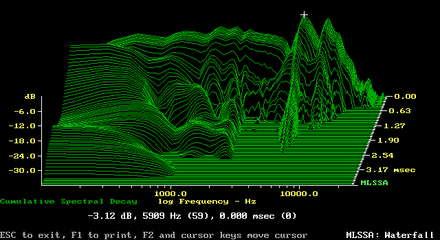

Retro 30, measured close.

That path leads to madness: the peak is a physical resonance off the cone. Damping the electrical part with either a) not work, b) suck the life out of the sound or c) all of the above.
A bit like why pony tails swing sidewards when one runs in a straight line, simply trying to not put energy into the resonance band won't work: this ain't a linear system we're talking about.
Probably the best route (short of swapping the speaker) is to try attaching bits of felt or similar to the cone to damp out the resonance (expect the efficiency to fal). It'd help if you can lay your hands on some very expensive laser intereferometry test gear or a copy of whatever MLSSA is called these days.
Here's an example of the sort of problem you're looking at (page 5 of the link above). Later on there's one where the resonance frequency varies with time - try filtering that out

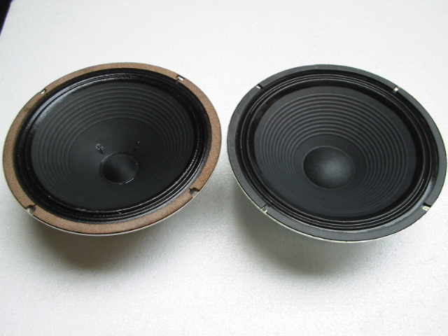

I got it SO clearly that VERY pissed off by not getting the sound I liked I started building my own speakers from scratch.😱
Celestion at left, Fahey G12 at right. 🙂
FWIW long ago also experimented with band stopping resonant LRC filters inside cabinet 🙂 , although stopped doing that because being able to mix and match different cones, voice coils, doping, etc. allowed me to address the problem at the source.
Only "unsolvable" problem in Guitar speakers and you´ll see ALL show it, any brand, is the typical dip around 1500/1700Hz , which is geometrical in origin.
It´s caused by sound wave starting at voice coil, reaching edge and being reflected back; at that frequency the delay makes it appear cancelling, out of phase.
Doping only partially attenuates it.
PA speakers don´t, because way thicker typical cone stops it. also attenuating the typical 2000/3500Hz peak.
