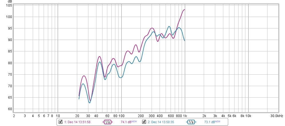

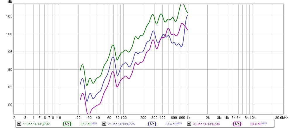

Just went through my measurements, and found the ones I made for the test described above. It was quick and dirty test (with room influences...), but it shows the trend, I think.
The most interesting is the curves shown for single unit (violet), compound (blue) and side by side (green). One sees that compound has indeed 3dB more output than single, and the side by side 6dB more as the single.
Also, unfortunately I saw this later only, member Bolserst mentioned that for the compound woofer dipole peak goes one octave up. I measured to 1000Hz only, and the dipole peak should form around 700Hz for these 12" drivers, but one sees that the compound woofer output goes below the single unit from 450Hz onwards.
Last, a measurement taken at 90° of the single and compound woofer. While at ONaxis the output was about 3dB higher, at 90° the outputs are much closer, so does the compound really output less to the sides?
Indeed, the drivers were connected in parallel. These drivers are 16 ohm, so good for connection in parallel.
So, for same excursion (same voltage coming from the amplifier), the output of the compound dipole is 3dB higher. Eventually it is the excursion that is the limiting factor in determining the dipole SPL, so I am quite sure that it does not matter if the drivers are in series or parallel to obtain the 3dB increase... the difference between series or parallel connection will be mostly dictated by the amplifier's capability to drive the speakers. One can also use two amplifiers, one for each speaker.
