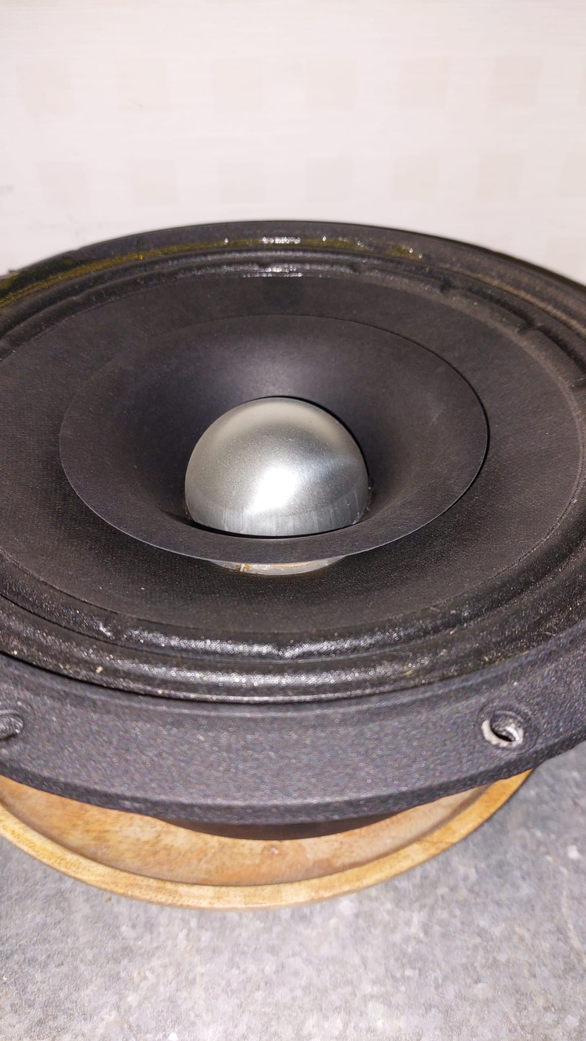

Recently found 4pcs 8" drivers from Celestion RS1 mk2 and the Celestion SRC1 mk2 limiter/dsp that goes with the original speakers.
The drivers are called T4579 but I can't find much info on them other than that they are quite impressive full range drivers rated at 8 ohm with a power handling of 175W and a sensitivity of 99db. I believe they would be up for the job as booth monitors together with my full size club system.
The original SR1 enclosure for two of these drivers, is approx 30litres with two maybe 2,5" diameter ports.
Then there is the half size 15litre SR3 enclosure for one driver and this is the one closest to what I want to build.

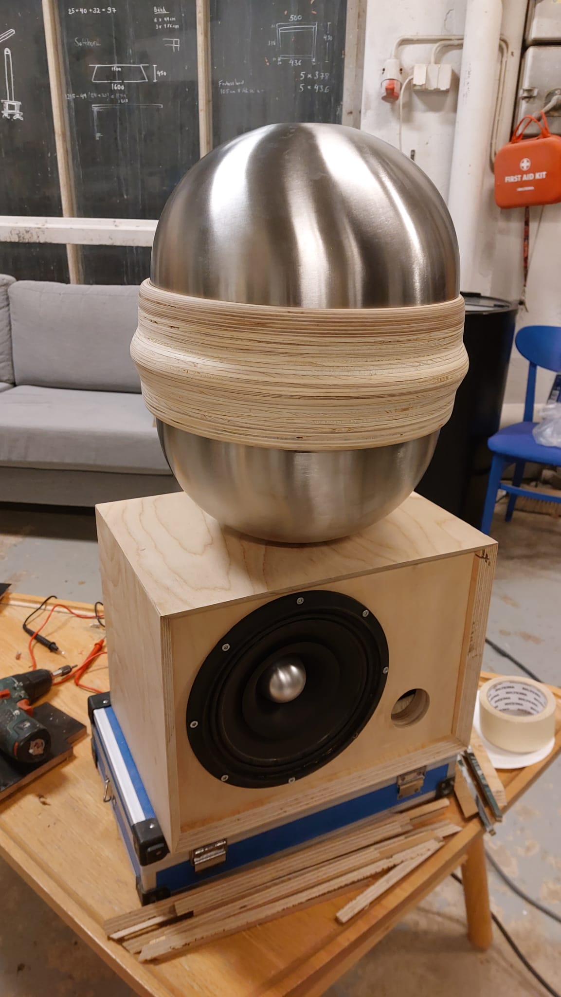

Went ahead and made these based on assumptions, copying the volume and port size of the original enclosures! What do you think?
Still need to find the right tool for cutting the metal bowl! Figured I'd just mount it in my lathe and cut. Still haven't decided on how to make the port of the egg.
