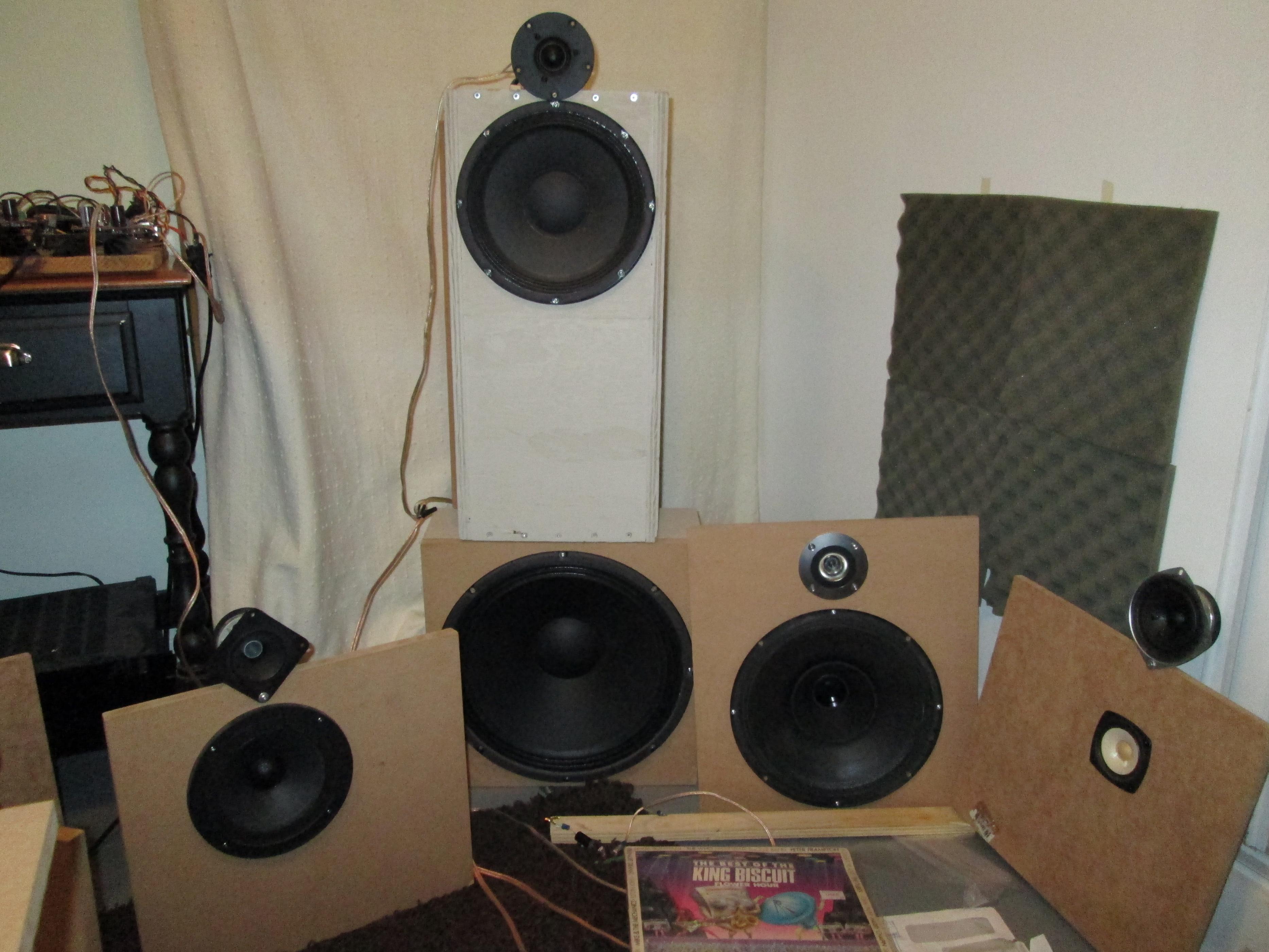

Tell us more, kind sir!
(This and other threads are makin' me dig my 12LTA out and finally finding a phaseplug for the removed dustcap. Some sort of plastic easter egg, trimmed and filled with putty ... )

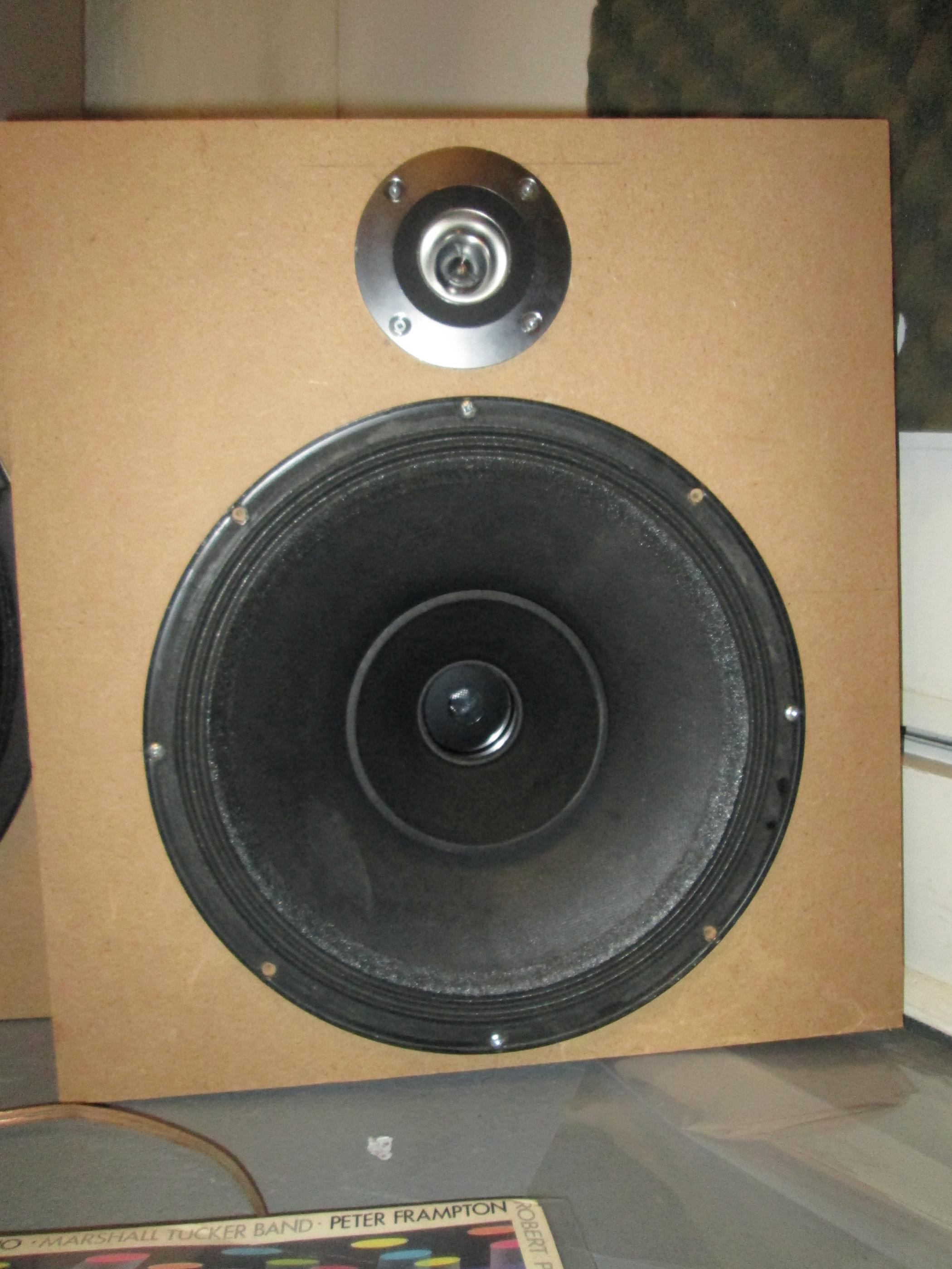

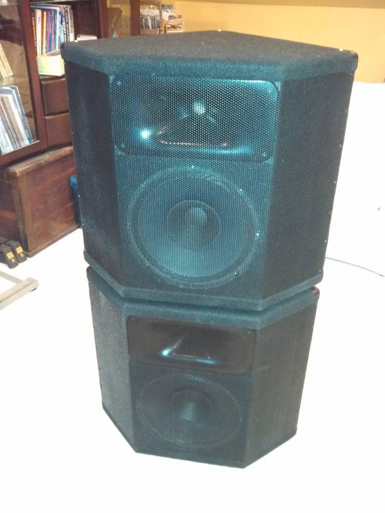

I have my 12LTA in a sealed enclosure with "extended horizontal baffles" at 45 degree angles. The angle is to accommodate more of a PA form factor, but it does two things: Reduces baffle diffraction compared to 90 degree angled side-walls, and reduces internal standing waves. I have since forgotten the exact internal volume of my sealed enclosure, but I would be glad to calculate it if someone cares to know.
I've been playing with the xo point to the SEOS-12 horn loaded CD on and off for almost a year now. I think I've decided I like the 12LTA "full-range" (crossed ~80-100hz to a sub) and the CD acting more like a super-tweeter with the xo somewhere between 4k-10khz, first or second order. At the moment, I like 7khz second order the most, but I'm considering swapping CDs or diaphragms for a titanium one. Right now I have the Dayton Audio D250P-8 which I have had very mixed success with. I think the 12LTA is held back in the high end by the D250P-8, but the LTA definitely needs something there.
Despite CD dissatisfaction, these speakers have phenomenal vocal clarity and overall musical reproduction. I receive glowing compliments regularly-- I credit the LTA on that!
Since I cross to a sub, the sealed alignment with the LTA is perfect for what I do. Mostly wedding receptions and a little small live sound reinforcement stuff. I like doing the live sound reinforcement more though :D Mixing bands with these speakers is a lot of fun.
The cabinet walls are 1-1/4 thick, made of 3/4 birch plywood on the outer face, and 1/2 MDF on the inner face. I ran oak bracing from the front baffle to the back corner. All joints and the gaps created by steel handles and pole mounts are filled in and sealed with Bondo. Basically zero air leaks.
If I could do it again, I wouldn't make the walls so thick. :D Perhaps I will do it again, with the Celes next time. Legis, do you think the Celes will suit a small PA type enclosure? How about sealed?
Edit: Forgot to mention: xo provided by Balanced 2x4 miniDSP
