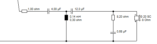

Well, the bottom line from all the agonising in that thread, is that Kat Manton used a 1R/10R attenuator at the SEAS 87dB tweeter. That's about 2dB reduction.
I think the below is a better way to do things. Better impedance, and flatter response.
Probably a 3W for the 1R, and a 7W for the 8.2R. Small Loudspeaker tags available at maplin along with everything else.
The issue here, is that the Celestion filter is for a near DCR= 4 ohms driver. Impedance of a filter tends to be root L/C. Here it's 140uH/4uF=35. Which gives about 6 ohms.
Whatever. If we use a DCR 6.2R tweeter, it's slightly underdamped, which takes impedance low. And makes it a bit peaky. IDK if you'll hear it.
Anyway, 1:3 is your regular 3rd order butterworth filter. It works well, hence my suggestion of 4uF/0.14mH/12uF. But you can keep the 6uF if you want. I like a RC Zobel on a tweeter, particularly with metal ones, because it gives an easy load to the amp and sounds nice.
We then might have to adjust level a couple of dB. Many ways to do that. Below is another way. Whatever you do, nothing is going to blow up. Every ohm in front of a filter takes level down 1dB.
TBH, it seems to me that people have made this far harder than it really is. You can probably fit any tweeter you like. Just adjust the levels. Harbeth use 91dB 104mm SEAS metal domes in this situation. I like them.
H1212-06 27TBFC/G
