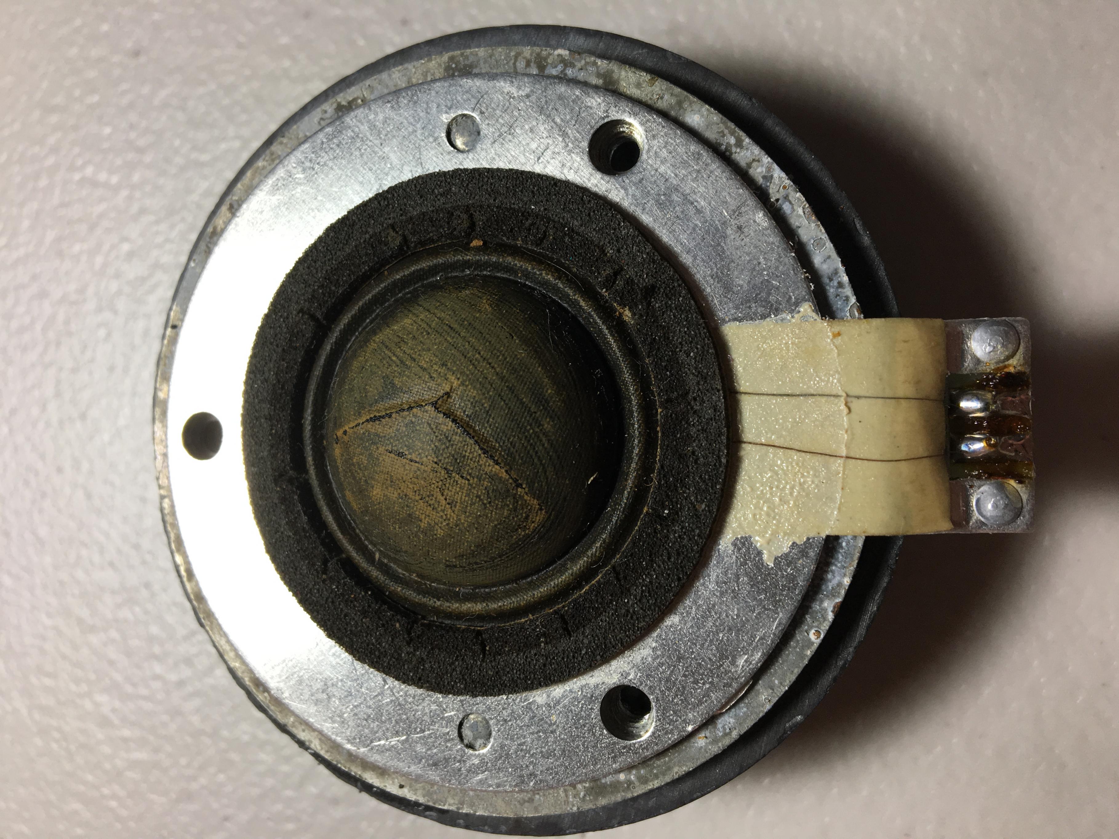

My Dad's beloved CELESTION DITTON 250 speakers have blown a tweeter - open circuit.
(Photos attached...)
As I'm not familiar at all with delicate tweeter internals, I have resisted the temptation to open up the damaged unit and attack with the soldering iron.
I probably need to do both speaker tweeters - whilst it still works okay, the good one looks pretty ratty too - so I want to renew the tweeters on both speakers.
So, I'm looking for a drop-in replacement for a pair of Celestion HF1003 tweeters. They appear to be very hard to get for sane prices, these days.
I'm hoping someone can help with: -

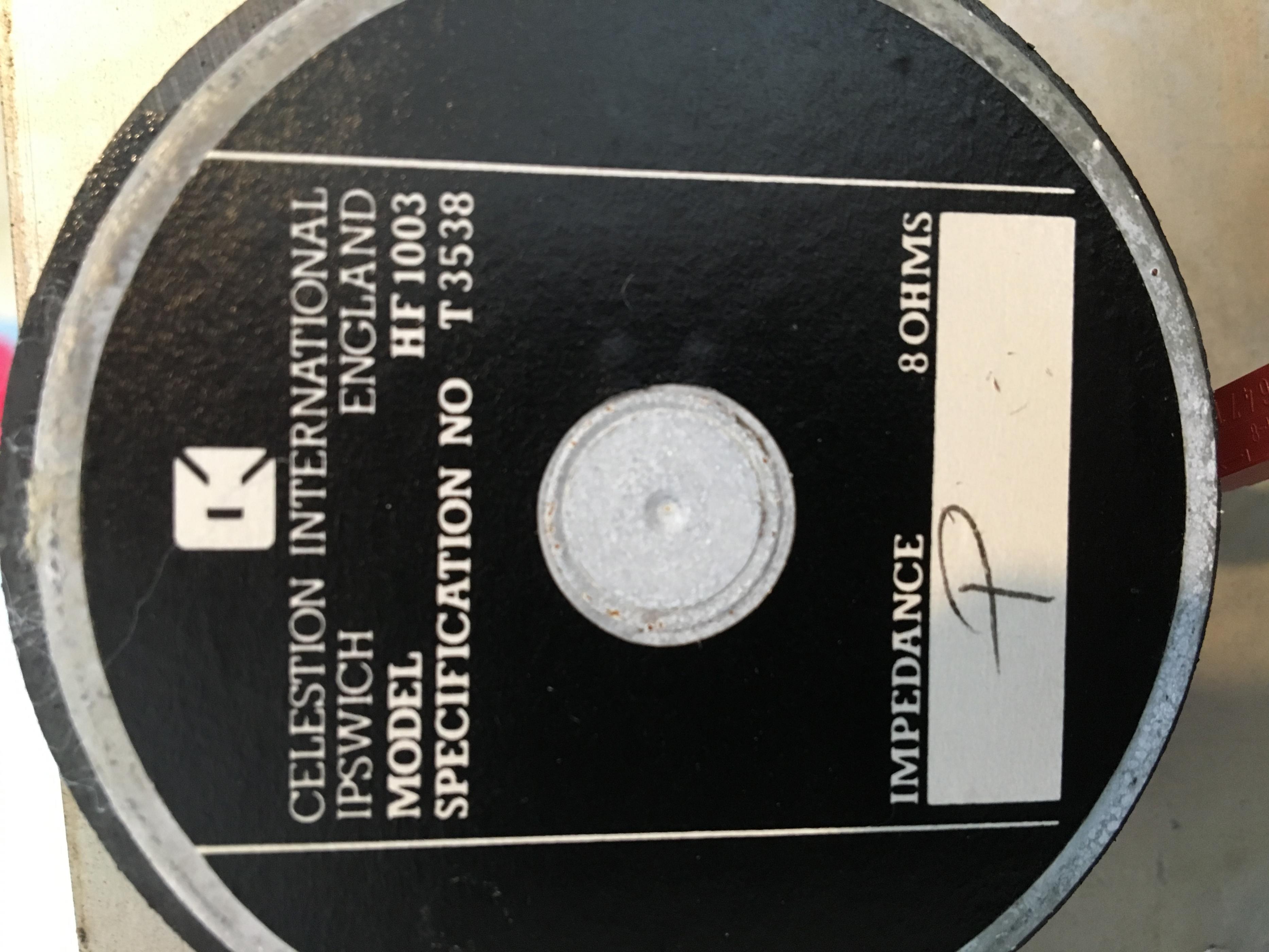

Incidentally, Can anyone confirm what the "P" designation refers to on the rear of the tweeter below?
(I have seen similar HF1003 tweeters with a "D" designation, also...)
Appreciate all your help.

P.S. Could The 'P' just be a quality control sign off?

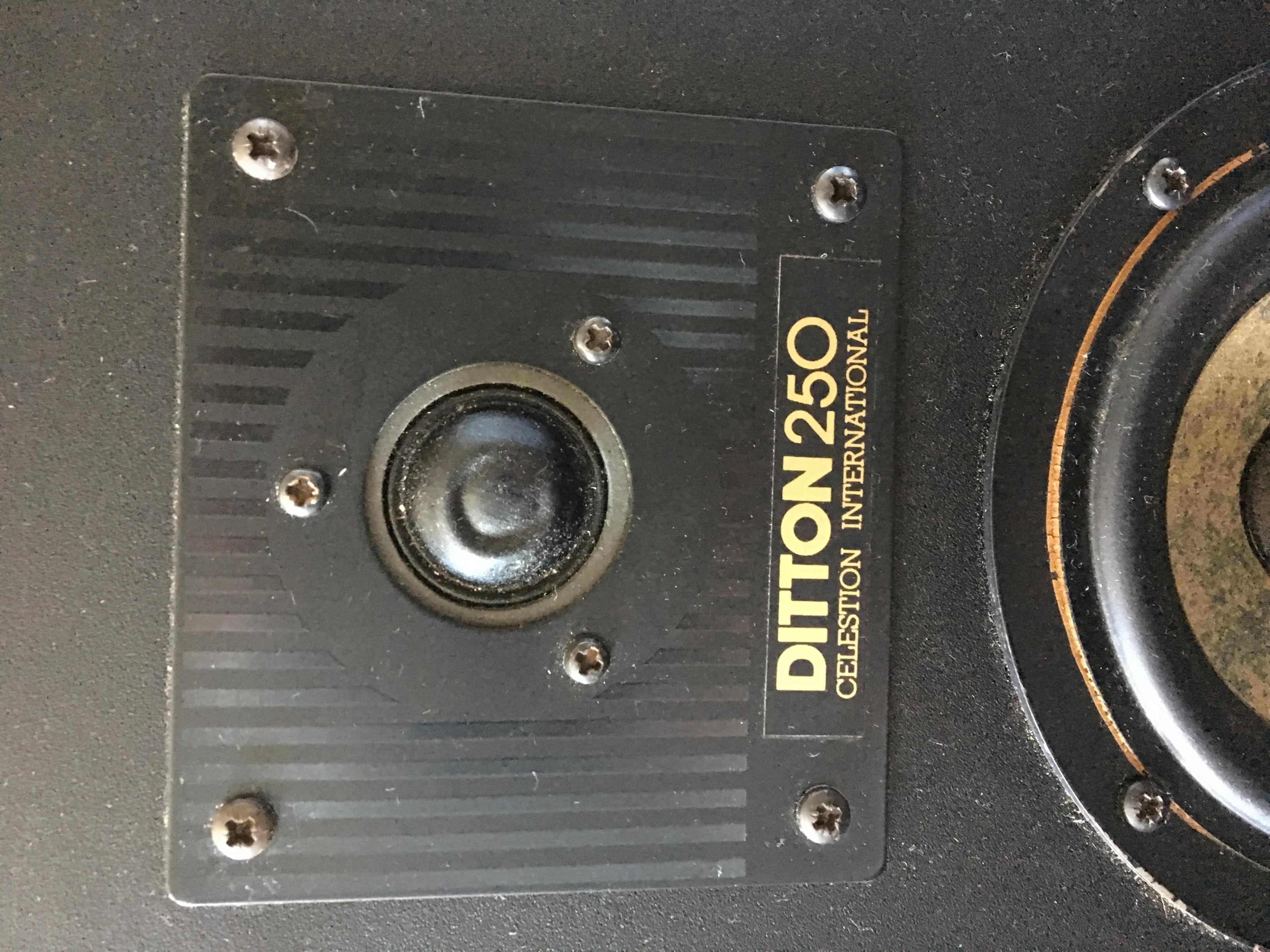

I have attached some more photos of the CELESTION HF1003 tweeters that I need to repair/replace and how they need to be mounted.
I'm not sure the FALCON models previously recommended will fit the need here... Plus the steep price becomes prohibitive.
Galu
Many thanks for your prompt reply. Appreciated.
I saw this thread, but I believe that this member is seeking different tweeters from those that I require for the DITTON 250.
As you have discovered, there is a paucity of information on the HF1003 tweeters.
It appears that you have nothing to lose by attempting to repair the o/c tweeter.
It is possible that one of the pair of lead in wires has broken just short of where it enters the voice coil. If so, this may be an easy fix.

Thanks Steve.
The reason I asked is that I think SONDEKNZ wants to keep the original look by retaining the Celestion faceplates - and probably doesn't want to drill extra magnet mounting holes into them.
Looks like the mounting plate isn't even rebated:
You could fit almost anything there. Bit of black indelible marker would see off any cosmetic issues. I think New Zealand is a tough place to get hold of stuff, but almost any 8 ohm tweeter ought to do. But almost certainly you'd need to adjust level. Even 1dB wrong is very audible. Which usually corresponds to an ohm at the filter input.
Mounting a small tweeter (like the Visaton DT94 which Steve mentioned) onto the Celestion faceplate sounds a good option in cosmetic terms. Would just need some enlargement of the faceplate opening - easy enough if it's made of plastic.
