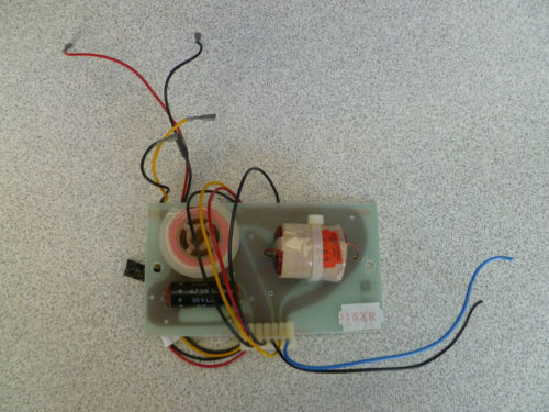

OK, so I got brave and pulled the crossover out the back... There are two coils... the large one has "732" written on it and the one large capacitor has a rating of 12uf... If I understand this correctly, this means that I have a crossover of somewhere between 16 and 1800 hz... since 1800 is the lowest my new tweeter can go, then if I want it to kick in at 2,000hz, then I need to change that capacitor to a 9.95uf and leave the coils alone?

HeeHee, Brave is actually just what you do with old speakers. Have 'em in bits and check it all out. 😀
Presumably first order slope coil on the woofer and second order 12uF capacitor and coil on the tweeter. You're right it's crossing over quite low, maybe 1800Hz.
The Morel CAT 298/MDT 29 isn't going to like that too much and you'll lose some maximum power headroom. The old 12uF is probably due to be replaced by now with a new 50V electrolytic non-polar. This monacor HT-22/8 might be a good replacement too:

Also a look at modelling 1800Hz 10uF first order crossover for a typical dome tweeter using 10W wirewound resistors:

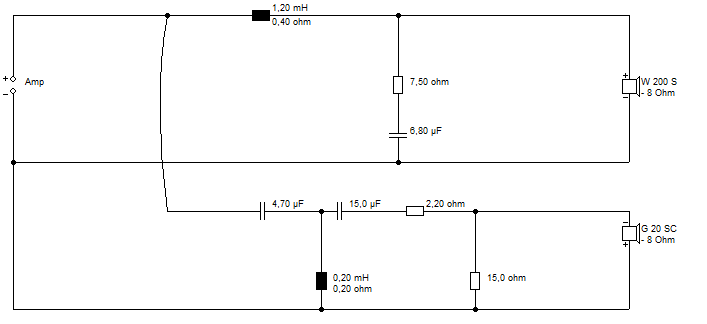

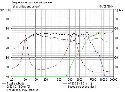

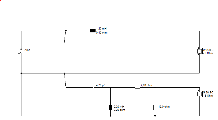

I think that what you are running into here, Louis, is the Ditton 15 used the Celestion HF 1300 Tweeter, and the later 15XR used a more regular soft dome.
The Ferrofluid Morel CAT 298 soft dome is a good replacement for most of the old tweeters, being available in 94mm, which can help.
BUT, the HF 1300 crossed over much lower than regular soft domes. Maybe 1800Hz as opposed to the sort of 3.5kHz that would suit the Morel better.
So the 15XR had a different crossover. 4.7uF rather than 12uF in the treble section. I can't comment on coil values unless you measure them.
This is a very simple filter, and really not the last word in refinement. What you need to do is get a capacitor around 4.7uF on the treble section, then fit an attenuator to get level right. Say 7W wirewound or ceramic resistors.
Typical values:
1R/22R for 1dB.
2.2R/15R for 2dB.
3.3R/10R for 3dB.
41 year old bass units often sag and rub, sounding harsh, and turning them 90 degrees can help.
I include the sort of filter that I employ myself in this situation. A bit more sophisticated. 🙂

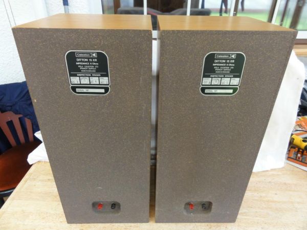

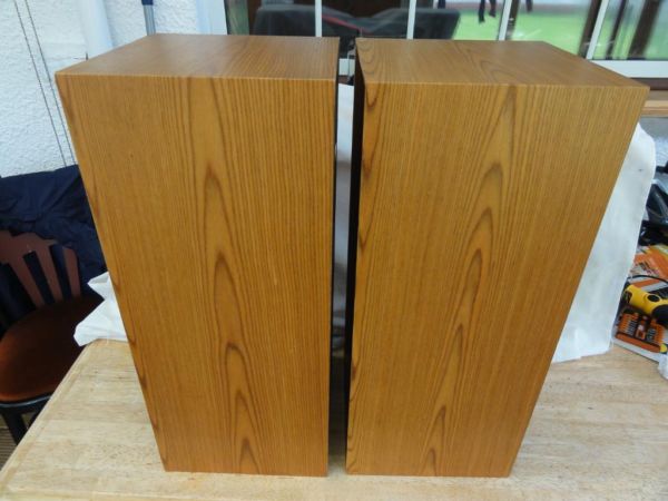

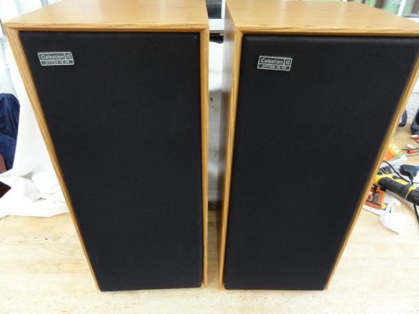

OK, been to see a guy locally yesterday who is selling a pair of 15XR. Some years ago this chap used to ran a second hand Hi-Fi shop and after closing it down apparently he had theses in dry storage and now have decided to sell them on.
Have to say they are in nice condition for the age only with a few small bruises here and there. The biggest fault would be a cracked grill on one of the speakers which has been stitched together with some aluminium plates and actually cannot be seen from the front so not a big deal really.
The guy had them hooked up to Rotel RA 921 amp and i listened a few different tracks from a CD and have to say i quite liked what i've heard. Music was a bit of mix and i had a go at Classical, Jazz & Pop.
It's the 1st time i actually encountered these speakers and quite liked the sound. The lower end wasn't really jumping at me but yet it sounded somehow good but what i really liked is the high end on these speakers and them tweeters were really selling them to me. 🙂
The guy explained that the speakers are not really suitable for bass heavy dance music and are best to be used for more relaxed genres like Classical, Jazz, ect and my understanding from what he said is that a bass heavy stuff is not mechanically healthy for these speakers.
I just would like to get some second opinions on these as no doubt there are some old owners around on these forums.
I like to listen to a variety genres of music, i like House music a lot but also listen to stuff like Pop, Jazz, Classical, Rock, Reggae, well basically a little bit of everything. He is asking £79 for them.
My ultimate question probably would be: are they worth the asking?

Hi, looking at your photo's i would say yes they are worth the asking price given what you see on ebay for more than that, so they are worth a punt.
If you are interested in improving them there are a few relatively straight forward things you can do to improve the sound: Firstly replace those nasty little brass terminals with something better, secondly replace the internal door bell type wire ( i used cat 5 ), the 4.7uf crossover capacitor must be the best part of 40 years old replace it with a modern electrolytic cap of the same value. I did all three of these things on the standard 15's and was amazed at the improvement in the sound.
Good luck.
Good luck.

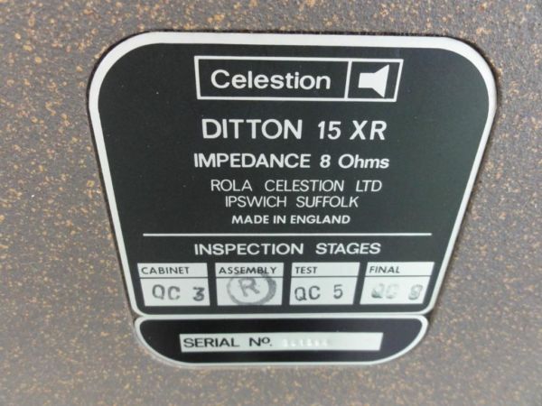

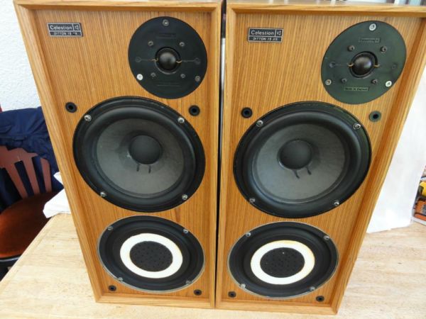

I was so close to commit buying these but then someone elsewhere pointed something out... Look at the 8" drivers in the pic i attached to my previous post and then look at the version i've attached to this post. The drivers in the speakers i'm looking at aren't originals. 🙁
Taking that into consideration i could still buy them and source the original drivers separately but then again what should i be paying for them butchered ones. 😕
Just walk away from speakers with non-original drivers,
always. Get the real McCoy or just don't go there.

HI, yes I see what you mean, have you given them a listen? May be worth negotiating over the price if the sound is decent?
If those are replacement bass units, they look like Maplin's own cheapie £17 8" units!
80W 8in Shielded Bass Mid Range Speaker | Maplin
Which don't look bad at all, as it goes. 😀
The Celestion 15XR was a decent speaker, if not an exceptional one. Build quality is excellent, and you can certainly upgrade the crossover and drive units down the road. So they could be a fun buy if you get the diyaudio hobby bug.
But £80 is too much. I'd pay £50-60 for them. My local second hand shop regularly has these type of 8" two way speakers, and he never charges more than £60.
