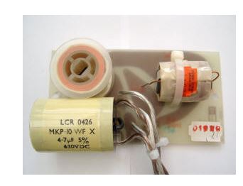

IIRC, the Celestion Ditton 15XR has a mere bass coil on the simplistic crossover.
Wire the basses in series after the coil. Now technically you ought to double the bass coil value, but in practice, it might sound OK. 16 ohms bass, of course, but all the power and authority from doubled drivers.
Maybe it won't go quite as low in bass performance, but nothing will break. Just my taste, but I'd shunt a 22R 10W or 7W wirewound across the tweeter and after the LC filter too. Usually sounds better. Amps like it.

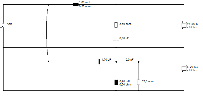

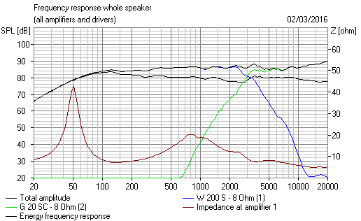

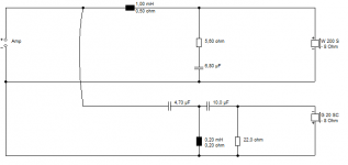

If it was my speaker, I'd do something like below and I reckon it would be rather good. But that's just me.
