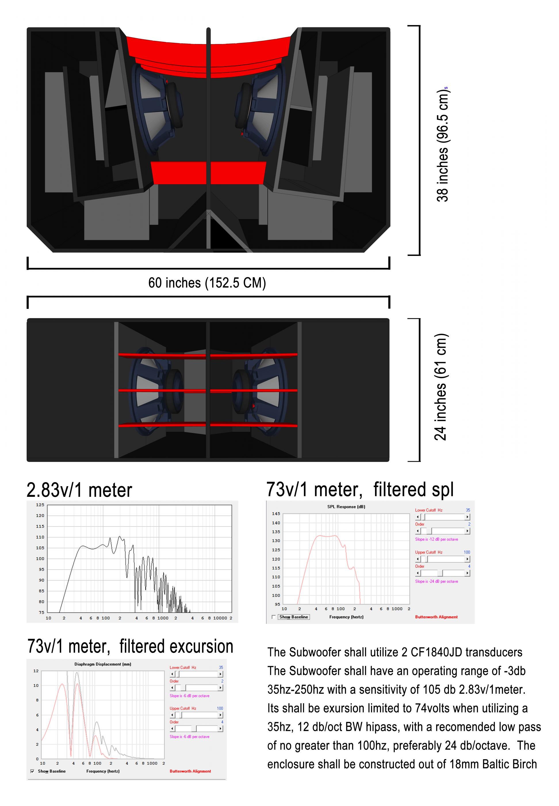

So Celestion recently hosted a speaker design contest (ended yesterday) for their CF1840JD 18" drivers.
now... overall, this driver looks like an ideal 40hz bassreflex dual 18, (volume aroune 375 liters) with a fairly low driver mass, but that seemed a bit too simple to win a contest, so I designed a dual tapped horn in about 4 days.
Its pretty big (no where near as big as a FLH would be for this cut off) but the results are decent, about 2 to 3 db in sensitivity advantage. dimensions (external) are 60w X 38d X 24h. limit is around 73 v.
Anyways... If I DO win... I'll probably just build bass reflex boxes, but it was a fun exercise in speed of design/fold with an unknown driver. 🙂

yeah I kinda figure i'm doomed though cause IDK if Celestion will want to ship a prize to the USA lol.
Interesting design, even if it's big. But why 2.83 volts 4 Ohms? It is two watts not one. It would make more sense to provide sensitivity at 1 watt so 2 volts 4 ohms.
Was just looking for info on this driver and found this thread. As an update, the contest winner is here with an f3 of about 45hz:
Build This! Dual Subwoofer - Celestion Speaker World
