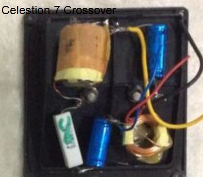

I have a set of Celestion 7 speakers. They are the 'original' models and not the ported MKII's (from what I gather this is the main difference). Not the best I know, but it is what I have to make do with... for now. They seem to have a certain harshness, particularly on female vocals. I can't quite explain what it is. It's quite... edgy I suppose. Sort of... a ringing noise. It seems like she is (in this case 'Hungry Lucy', 'To Kill A King'.. particularly the chorus) screeching / shouting, at points, at what I would consider 'normal' listening levels. I can't seem to tame it with an EQ (which is flat except 63Hz and 31Hz, which I find need boosting a bit for these speakers).
The speakers have a metal domed tweeter (by metal domed I mean it is silver, I dont know the actual material) and a 6.5" plasticy feeling woofer. I was just wondering if adjusting the crossover might do anything to tame this harshness? Perhaps it is just 'cheap' drivers and I can't really do anything about it?
I have drawn the current crossover, but I don't know the values of the inductors, sadly. The drivers are unmarked, so I don't know anything about them other than the tweeter is 6.5R at DC (multimeter measurement is the best I can do) and the woofer is 7.8R.
From what I gather, without the resistors it would be a very basic 2nd order crossover. I'm not sure what the resistors are actually doing though, so maybe it's not. Is it possible to "improve" it without proper specs? 🙂 The caps are electrolytics... and they must be at least 10 years old by now I should think. Perhaps just replacing these might do it some good?

I just scavenged a pair of these Celestion 7 Speakers from Roadside Hard Refuse in Bardon, Brisbane. Cabinets were trashed from the rain. But the tweeters... YEP! Impedance passes at 8 ohms. (woofers look trashed, but usable, as one of the cones seems 'misshapen' somehow.) Crossover, well, I'm about to try it out as a mod in a pair of Accusound 650D or 680 2 ways.
Wish me luck. This is just an FYI post. Thanks for the schematic and details. Yours is the only info I've found so far (and your in Australia like me).
Celestion 7 crossover included in this image.

I just had a little look around and the Celestion 7 seems to be metal tweeter and polycone or paper 7" bass.
The schematic in this thread seems to be the miniscule Celestion 1.
Well, either way, a second order filter.
Possibly you'll end up replacing the basses, and a Peerless 830874 would be a reasonable replacement available in your neck of the woods. Metal tweeters are common enough. You might find something by SB Acoustics like the SB26ADC:
SB26ADC-C000-4 :: SB Acoustics
You'd probably adjust the resistor on the tweeter section for level, but it ought to end up sounding quite good in about 20L.
