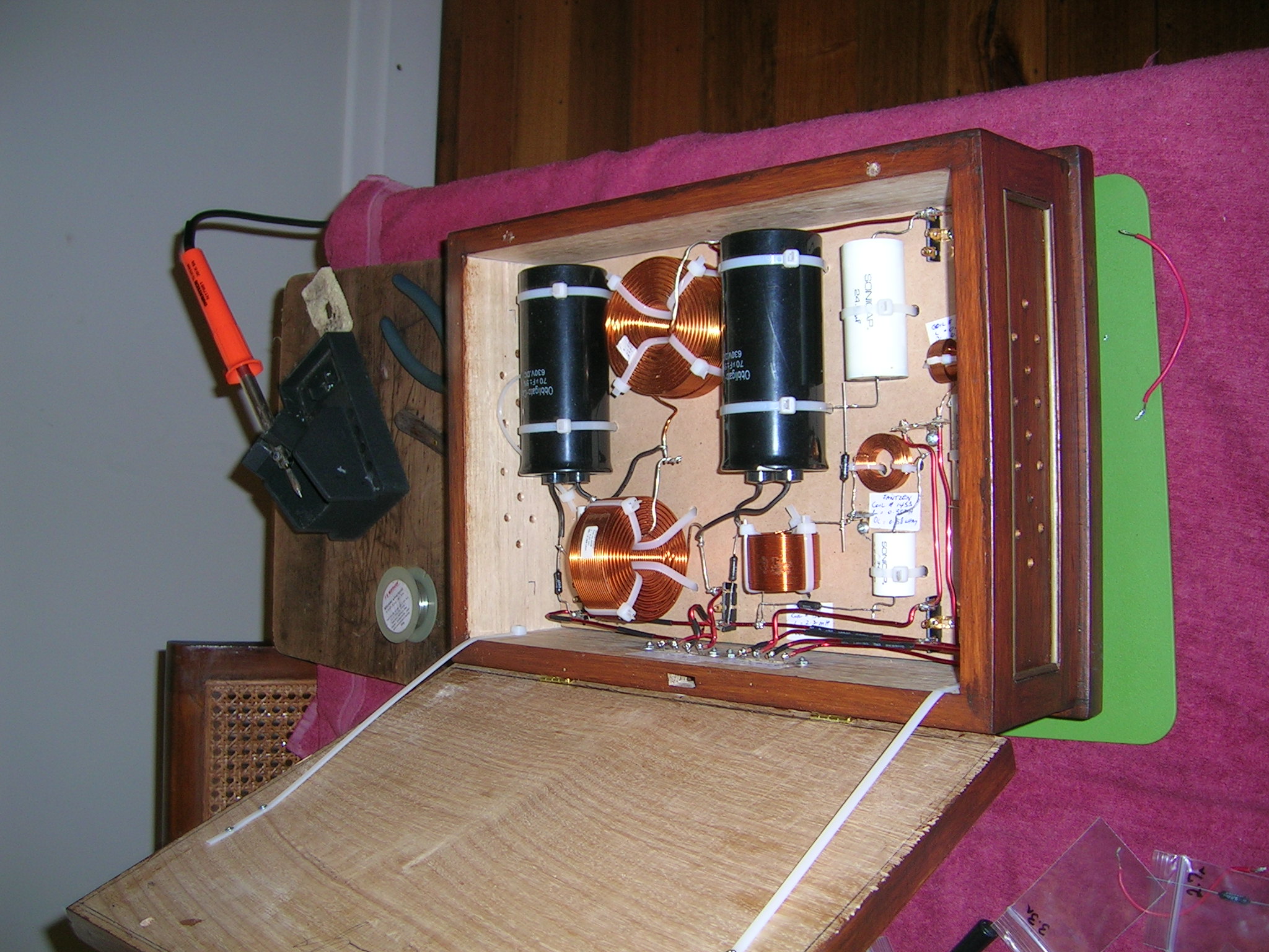

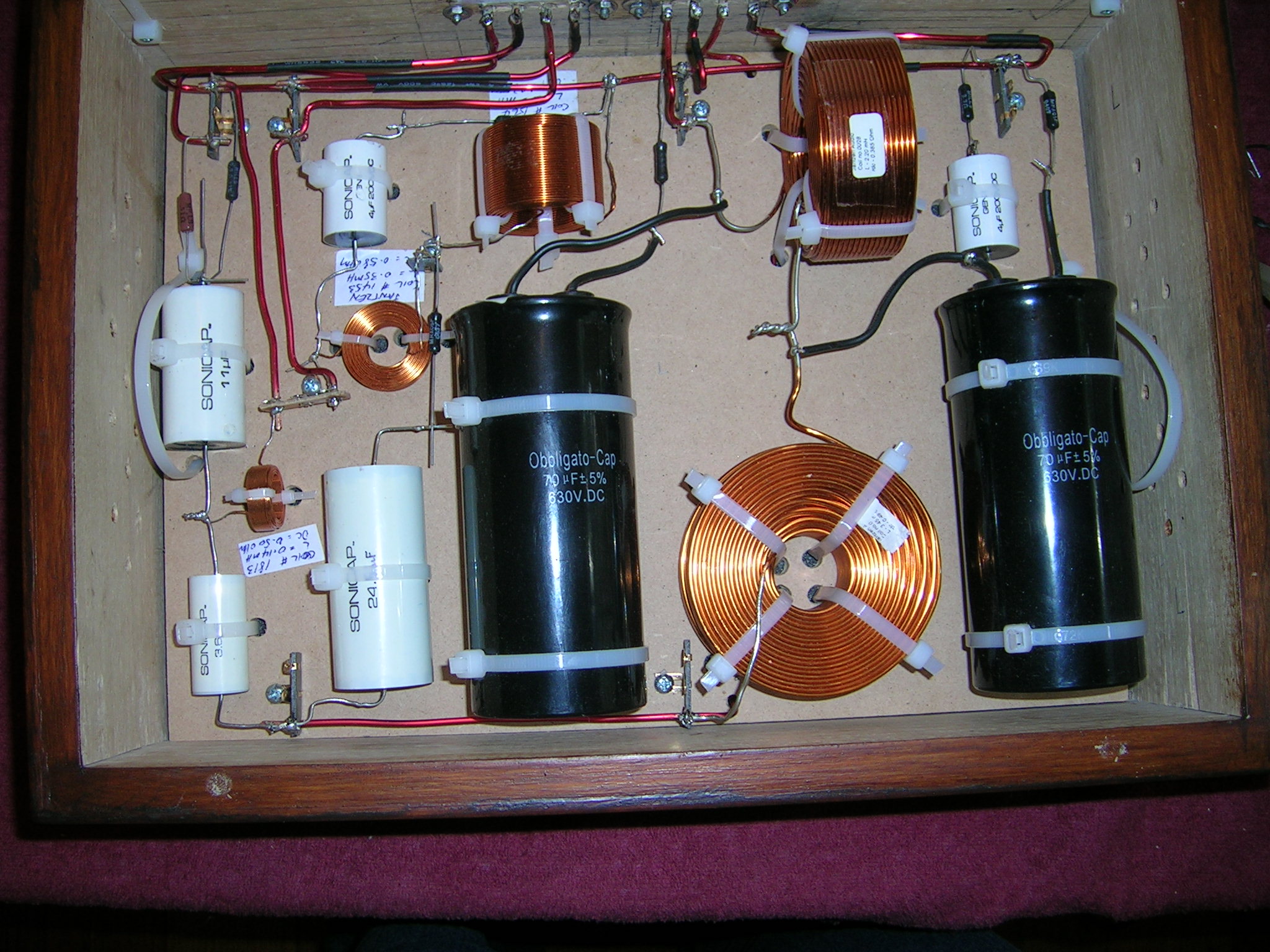

Hi Alan (at al).
Well, after much procrastination (and several weeks down-time with a severe cold – my second in 2 months) I have my cross-overs finished. I plugged them into the system this morning and heard ….nothing. Been so long I’d forgotten how to turn my system on – 7 switches not 6. Anyway, it all sounded pretty good but something wasn’t quite right. Voices, which are usually centered between the speakers, seemed to be at the edges; a sign I think of incorrect polarity somewhere and sure enough I had reversed polarity on one of the MF500’s. So all good now. I’m so surprised that there are no hums, buzzes, whispy bits of smoke and/or burning rubber odours! Over the next few weeks I’ll try to voice them using combinations of the resistors you have recommended together with a variety of differing musical types. My resistor default settings at the moment are:
Midrange = 24.5uf capacitor/1.5 ohm R (alternatives 0.51 ohm or 1.0 ohm) and 4uf capacitor/3.9 ohm R (alternatives 2.7 ohm or 3.3 ohm).
Tweeter = 3.6uf and 11uf capacitors with the 0.51 ohm R/30.9 ohm R LPad (alternatives 0.75 ohm or 1.1 ohm and 24.9 ohm or 18.0 ohm or 62 ohm* (*to be used on its own!)
Alan, while convalescing I ordered replacement capacitors for the bass section of my new cross-overs (not wishing to pull the old ones apart). However, I was only able to get 70uf so I have supplemented these with a 4uf capacitor. So, the line-up there is now:
1 x 70 uf capacitor/1.5 ohm R plus 1 x 70 uf capacitor/1.0 ohm R with a 1 x 4uf capacitor/8.2 ohm R. But I think this last resistor was your suggestion if accompanying the existing 2 x 68uf Solens capacitors and the 1 x 8.2uf Solens I was going to take from the tweeter section of the old Xover. Could you advise me further on this please?
Lastly, thank you for your offer of assistance (Post #1014) to help me build some speaker stands. Unfortunately my wife thinks that 105cm’s is a fine (as in finite) height so, as an alternative, I have built little boxes for the cross-overs that hide under the console that holds all my gear.
Regards to all
Reggie

to Reggie above , + about placement of Inductors , + interim to DennyG
G'day Reggie ,
hah , you got your crossovers assembled sooner than I thought you would ,
and thus sooner than I had time to post about Layout and positions for the new large Inductors.
I did post a little in a previous post about positioning these large Inductors ,
but not all I had intended to ... at least not in any Post I have been able to find now , despite too long looking !
For all readers - placement of large Inductors for minimal Inductive Coupling:-
I previously advised a minimum of 10.5" x 10.5" board if all crossover has to be on one board.
{ Better is to use two boards:- 11" x 5" for the Woofer filter , and use the old Celestion board for the Midrange and Tweeter filters.}
Alternately use 11" x 10.5" or 10" if all on one board.
The new Woofer filter Inductors are so large they need to be a distance equal to or larger than the Diameter of the 3.5mH distant from each other ,
and larger distance away from all the other Inductors so that their Magnetic Fields do not excessively interact with each other.
Magnetic Field interactions are Inductive Coupling and will reduce the filter's effectiveness ,
because the coupling transfers part of the unwanted electrical signal into the next stage , or into another filter's stage , and thereby into the drivers.
To minimize this coupling:-
Put the new 3.5mH in one corner of the new board.
Put the large 2.2mH Woofer filter Inductor in the adjacent corner along the 11" side ,
{ or the 10.5" minimum side } ,
so both Woofer filter Inductors are on one side of the board.
Put the small 2.2mH Midrange filter Inductor in the corner diagonally opposite to the large 2.2mH Inductor.
Put the 0.14mH Tweeter filter inductor in the corner diagonally opposite to the 3.5mH inductor.
Thus the Tweeter filter's inductor is largest possible distance away from the primary source of bass coupling ,
hence very very little bass will get to the tweeter circuit where it would cause the worst audible effect.
Draw a line diagonally across the board from the 0.14mH inductor to the 3.5mH inductor.
Measure and mark the half-way point between the OUTSIDES of both those inductors along this line -
{ NOT the half-way point between the Centres of these two inductors }.
Stand the 0.34mH Inductor on its edge so it is like a Wheel ,
and place it on the line so that it could be rolled along from 0.14mH to 3.5mH and back.
Put some Silicone sealant on that half-way mark , position the 0.34mH on that in the direction I stated above ,
and tightly tie that inductor to the board with a Nylon cable tie.
Use Nylon , not Plastic , because plastic will stretch and loosen over time , but Nylon will stay tighter.
Do NOT use wire to tie the inductor , because wire being metal will become a Core to the inductor and thereby increase its Inductance.
In the position I have described the 0.34mH inductor will be off-centre away from the other diagonal of the board
from one to the other of the two 2.2mH inductors , and that is good for less Inductive Coupling from those.
Put the Woofer filter capacitors between the two Woofer filter inductors ,
and position them Parallel to each other , and so their axis's points from edge of board to the centre of board.
Put the 24uF Midrange inductor between the 3.5mH and the Midrange 2.2mH , and also axially pointed from edge of board to centre of board.
Put the 3.9uF Midrange cap between the 2.2mH midrange inductor and the 0.14mH , closer to the 2.2mH , and again pointing axially from edge of board to centre of board.
Put the two Tweeter filter capacitors one each side of the 0.14mH and near to it , and pointing axially from edge of board to centre of board.
Stick all those components to the board with Silicone sealant , and tie them tightly through the board with Nylon cable ties ,
but NOT the Resistors.
The resistors are small and light weight , thus do not need to be tied down.
They will dissipate their heat better and thus stay cool when held above the surface of the board.
Their wire end leads are strong enough to hold them above the surface ,
so solder their leads to the capacitors leads and then bend the resistors' leads gently and at a distance not less than half inch from their bodies so as to not stress the connections to their bodies.
Bend through no larger than 90 degree angle of the wire lead.
Make a part circle shape with the wire lead if you need to bend it further to hold the body above the surface of the board.
Basically , make the leads to be legs for the bodies of the resistors.
Reggie ,
if you have positioned some or all of your components differently , you can change some of them if you have used Silicone sealant ,
because it can be cut with a sharp blade.
The inductors need to be as I described , including the 0.34mH positioned like a wheel ,
otherwise you will have a degree of Coupling sufficient to reduce the effectiveness of these expensive components you have bought ,
and thereby a less audibly good crossover than is possible.
The capacitors' positioning is less critical , because there is a lot less Fields' coupling through those than through the inductors.
The bodies of the resistors should not be left touching any other component or surface.
The 70uF + 1 ohm Parallel with 4uF + 8.2 ohm is OK if you have this double pair in the circuit location you drew the capacitors/resistors pairs at in your Schematic in #946 on Page 95 ,
and the 70uF + 1.5 ohm in the other location in that circuit ... are they ?
As you have started with the least attenuation to the tweeter , leave that whilst you are deciding the midrange Series resistance.
If the tweeter sounds too bright , then decrease the 1.5 ohm in midrange to 1 ohm , and to 0.5 ohm if necessary , or even to no resistor there.
Leave the 3.9 ohm in the Midrange filter till you have decided all the others.
Basically , the amount of Series resistance in the Midrange and resistances in the L-Pad around the tweeter need to be chosen to achieve the balance you prefer with the woofer now at higher output.
You may have to increase the resistances in the tweeter L-Pad to achieve this.
After all the above is closest to your preference you can experiment with the resistance to the 4uF in the midrange filter.
This resistor not only changes the upper-midrange/lower treble level , but also changes the Vertical listening axis.
It changes the Vertical axis because it changes the Phase response of the midrange filter.
This is evident in the series of simulated response plots that DennyG has posted recently.
If you are not happy with the integration between mid-dome and tweeter at the listening height you are now restricted to with no loudspeaker stands ,
then decrease from 3.9 ohm to 3.3 ohm , and even to 2.7 ohm if necessary.
If none cause the effect you want , then report here which is closest , or between which two resistances is closest ,
or whether neither the 3.9 or 2.7 is far enough outside the range of 3.9 <--> 3.3 <--> 2.7 .
Reggie ,

Initial Reply to #1023 - report of results by Reggie ; Agreement with LucasAdamson
Here is a Copy and Paste , and a re-setting of the spacings of #1023 :
Hi Alan (et al).
Yes, very quick to complete the crossovers (2 months??).
Plus 3 years of planning.
Lessons learned:
(i) do not use 12 gauge solid core wire in a crossover (almost impossible to get silver solder to adhere to it in a reasonable time
(ii) don’t twist leads together and then solder them unless you intend to let them stay that way forever
(iii) don’t try to reinvent the wheel – although only having one set of speaker wires from the amp to the crossover, I have three sets of wires (woofer, mid and tweeter + and -) from the crossover to the speakers.
Anyway. Despite my initial post expressing my joy at not having any teething problems several matters did come up that left me befuddled.
The first was with a crackling sound coming from the right hand speaker followed by the woofer failing.
It took a couple of days to find a bad solder joint.
The second problem was quite strange. After soldering various resistors in and out of the circuit I was listening one night and the music wouldn’t centre itself.
In fact the sound from the left speaker seemed to come from about 6 feet to the left of the speaker.
That took a couple more days to discover one lead of the 8.2 ohm resister attached to the 4uf capacitor in the bass circuit had fractured, right up next to the resistor itself.
Not having any more 8.2’s I soldered in two x 3.3ohm resistors in series. However, the focus then moved too much toward the right hand speaker so I wired in a 1.5ohm resister in parallel to the 8.2ohm resistor in the right hand crossover to bring it down a bit.
My wife says the focus is pretty well centred now but I will order some more 8.2’s.
To answer your question Alan yes, I am using the 70uF + 1 ohm Parallel with 4uF + 8.2 ohm and the 70uF + 1.5 ohm in the other location in that circuit.
As for the tweeter Lpads I am using the 0.5ohm and 30.9ohm.
I’ve found that, for most purposes, it provides me with more treble than before without becoming too obvious.

but to diagnose that I will need to see Plan View photos of BOTH crossovers
so that I can see the exact Lay-Out on each board.
Even if both boards look close to identical lay-out to you , they may not be electrically.
I will explain how that can be after I see the photos ,
because then I can direct you where to look for problems.

Hi Alan. These are pictures of my crossover(s).
Now I know how to upload them I will do better (closer-up) ones if so desired.
Picture 1 is the best. It shows that my layout is almost an exact translation of my schematic (you have to reverse the image to see it). It is laid out in three parts: woofer, mid and tweeter.
The red wire you see is 12awg solid core copper wire that I also used as the speaker wires.
Reading the wires at the (top) of the box from the left you will find: Tweeter (+)(-) Mid (+)(-) Bass(+)(-) Input (+)(-).
You will see that the input positive wire (2nd from right) goes in at the (top) of the board then underneath and emerges at the (bottom) near the big coil.
I'm sorry about my previous posts. They look fine when I post them. Is this present post better?

G'day Reggie ,
yes , your Text post is much easier to read than most of your previous - thankyou !
In your photos' post I can see most things ,
and it seems the Components' grounds are connected to the Input -ive line , which is good ,
and the midrange and tweeter -ives seem to be to that -ive bus also , is that how I see it ?
however I cannot see where the Woofer -ive is connected ... please describe where it is to ?
Now I see what you meant by 12 guage - the AWG12 wire you have used for the buses , { that you also use for l'speaker cable }.
I hope its Insulation is good ..!
It looks like you have scraped off Insulation to connect some of the components' leads to the AWG12 bus .. ?
The 3.5mH coil would have been better in the corner where one Obbligato cap is ,
because there is some coupling between that coil and both midrange circuit coils and also a little to the tweeter circuit coil ,
but leave it for now till we identify the cause of the Image Shift.
As I recommended on the last page , disconnect the 4uF cap and its Series resistor from that end of box Obbligato circuit ,
particularly the cap if it is connected to an Insulation scraped point in the Obbligato's lead - is that how it is connected there ?
Listen carefully to Image locations and Timbres between Left and Right channels , and then post a report here.
I do need to see a Close-Up of BOTH crossovers , preferably as photos side-by-side , and each similar to your first , { Left Side } , photo - no smaller ,
and slightly Closer if possible please.

Hello Alan/everyone.
Almost February 2014 (glass half empty mindset) and, despite a week of 44c temperature, I think I have the crossovers under control. I did as you suggested Alan and disconnected the 4uf capacitor (together with my various ad hoc resistors) from the bass circuit. Result…sound 6 feet from the left hand speaker. So obviously the resistors I added in were masking something.
So I figured my only recourse was to unsolder everything and junk the 12 guage wire. I found some very dodgy soldering connections along the way. I replaced all the solder with 60/40 and the 12 guage with a nice 18 guage solid copper wire. Much easier to solder and I feel more confident about the connections.
Also found that DiyHiFi in Hong Kong had inscribed the Obbligato’s with their value, ie. I had 2 x 70.9uf and 2 x 71.1uf so I have now got 142uf on each crossover and have left the 4uf capacitor off altogether!(?)
Alan, I looked at your suggestion for swapping the big coil and capacitor but in reality I measured only one extra centimetre of separation. I could have swapped them and stood the coil upright which would have given me much more separation but unfortunately it was then too tall to fit in the box. So, it remains as it was.
But I did experiment with the resistor value attached to the mid-range 4uf capacitor. I replaced the 3.9ohm resistor with a 2.7ohm. What happened was that the music lost its sparkle. It seemed to me that the upper mid-range became muted. To test this I played Wishbone Ash’s “The Warrior” and listened to that quiet cymbal part and I could not hear it at all even with my ear close to the tweeter. So I put the 3.9uf back in again and the sparkle was back and I could hear the cymbals from 4 feet away.
Seems funny that such a small difference in resistor value in the mid-range could effect such a change (and one even I could discern) in the tweeter section. I wonder what would happen if I put a larger value resistor in there? I also speculated (but did not rigourously test my hypothesis) that my short time with the 2.7ohm revealed a tiny improvement in the understandability of Laura Marling’s voice.

I hope you have the Obbligatos in with the 70.9uF at the output with the 1.5R ,
and the 71.1uf at the centre of the T with the 1R , for BOTH crossovers ..?
How is the Image now ... centred or how far off centre ?
If still off-centre I need to see close-up photos of the tops of BOTH crossovers so that I can see exactly where ALL the Inductors in and out leads are coming from at the Inductors ,
that is whether at top or bottom of , and in which direction the winding is that each is coming from , for ALL the inductors.

I am happy to take on this task, as it will be helpful for myself to be able to have this information much easier to access when it comes time to work on the Ditton 66 cabinets I will be acquiring. As of right now, I do not have any questions, but here is what my current action plan is.
Right now I have a set of custom-made Celestion Ditton 44s, utilizing a different crossover layout, with the inductors from the HF and LF sections of a Ditton 66 crossover, with Solen capacitors on the mid and treble sections and Alcaps on the bass section. All ESR has been accounted for. My plan is to rip this crossover apart and re-use the parts for my new Celestion Ditton 66s. The version I will be getting is the P.C.C. version, i.e. the "woody" model. My custom Ditton 44s are already using the Seas 19TFF1 with the 0.14mH inductor, so that circuit is all ready to go! The only piece I am missing right now is a 4uF capacitor, however, I save all of the capacitors I pull from crossovers and so I have some old poly caps from the old Ditton 66 crossovers that I can put to good use for the time being until I obtain some new ones.
As of right now, I am not sold on the Solen sound and may upgrade to ClarityCaps, but we will see, I want to get the Ditton 66s up and running with the Solens first and evaluate. The person I am acquiring these cabinets from owns a completely original set of Ditton 66s, original caps and the whole bit, and once I have finished my set I plan to haul them over to his place and do an A/B. I am mostly curious about the Solen capacitors and their change to the sound as well as the 19TFF1 vs. the HF2000. I don't think this has been possible before, and I certainly have not read about this happening in this thread, so I'm sure this will have some value for you all.
Finally, for the mid-domes, I have found a pair of MF-500s. I understand there are some differences between these and the MD-500s, however, I am going to get them and use them regardless (with a 24uF capacitor), I think the results will still be stunning. From what I could read the MD and MF drivers are not so far apart from each other that they could not be used interchangeably. If I am incorrect in this regard, feel free to fill me in. Regardless, worst case scenario is it takes some crossover tweaking to get it to properly work with the Seas 19TFF1. I am fine with this.
I would just like to thank everyone for their contributions to this thread, especially to sba for his measurements, alan for your extensive knowledge and for tonedef2 for getting this all underway. I am hoping to be reading this thread again to learn about refurbishing the MF-500s. It seems that no one has done this, or very few have successfully achieved restoring these drivers, so I am going to step into this foray and see if I can do it myself. I am not at all intimidated by these exotic parts and have restored many pairs of speakers in the past. Hopefully though I am not getting myself into the deep end here!
Anyway, that is all, I look forward to sharing pictures with everyone once I get the cabinets in. Since the mid-domes are already available, and I have the Seas 19TFF1 tweeters as well as the capacitors required for the recap, it will only be a short matter of time once I obtain the cabinets that these will be put together and singing.
I look forward to any comments anyone may have, but if not, I look forward to sharing this fun project with you all.
Jeffrey
to REGGIE - a Correction ! ; + a reply to jeffrey88
Reggie ,
There is a mistake in my last Post to you ... thinking again I advise to NOT try 4.7uF ,
at least not until you have reported here your listening results with 3.3R , and I analyse that.
You could try 4.7R , but I think it may go too far.
Better would be to try 4.3R , but that is unlikely to be available in your local store ,
however if you measure some 8.2R samples and buy four that measure high you can make two Parallel pairs of total a little higher than 4R.
Alternately , measure some 4.7R and buy two that measure low.
That will give you some idea whether an increase in resistance is the way to go.
If you don't like the 3.3R , put the 3.9R back in and Reverse the Polarity to Tweeter.
Try the Tweeter in Positive Polarity with any larger R than 3.9 also.
Because the Phase Summation between the midrange and tweeter is quite different with the Hiquphon than with the HF2000 ,
the system may work better with the Polarity changed when the higer R values are tried.
I doubt it will when 2.7R is in , but try it if you want to , because this is DIY and one learns by experimenting !
Warning:
you will need the under side of that protruding top-of-cabinet lip covered with a thick sound absorbing material when the tweeter is reversed to Positive Polarity ,
or or will hear prominent lower-treble spike reflections.

Reggie ,
Warning:

CORRECTIONS to my #1038 above
There are some mistakes in my Post #1038.
Obviously my brain was half-asleep yesterday !
The mistakes are in the sections I have included in the Quote Box above , as follows:
Reggie ,
Changing the Tweeter connections to Positive Polarity may work with 3.9R and larger , but I think it not likely.
Where it is more likely to work is with 2.7R .
You heard the loss of treble with 2.7R in , thus a Phase cancellation , hence swapping the Polarity of the Tweeter may fill that in ,
but it could add too much and cause a small peak in the response there.
You will have to try it and listen , and it will be Vertical listening height sensitive.
If you do prefer the 2.7R with Tweeter Positive , then that is the R value which may benefit with an increase in the capacitor to more than 3.9uF.
Try with a selected low price 4.7uF as I described in my Post #1036 .
That would reduce a small peak caused by the Phase addition.
If you prefer that to all other options , then you can buy a better quality 4.3uF , or even 4.7uF , Sonicap.
First try 3.3R there , a Jaycar 5 watt wirewound will suffice for the experiment if you didn't buy a Mills ,
then decide whether to try between 2.7 and 3.3 , or between 3.3 and 3.9 , or higher than 3.9R .
Jeffrey ,
I posted a Link to a UK seller of ClarityCap and Mills resistors , quite forgetting that you are in Canada.
The above brands are available from Parts Connexion in Canada ,
however , if you are intending to later buy 3.6uF and 11uF for the Tweeter filter , then you will have to buy SoniCap Gen I to get those exact values ,
so better then would be to use SoniCap Gen I in the midrange filter section also for Tonal consistency across the audio spectrum.
There is 4uF and 24uF , and 25uF , available, Buy the 200 volt versions as the more expensive 400 volt versions are not necessary for your application.
SonicCraft also sell the Mills MRA-5 resistors.
Sonic Craft High-End DIY Audio Parts
The remainder of my Post #1038 is correct.
