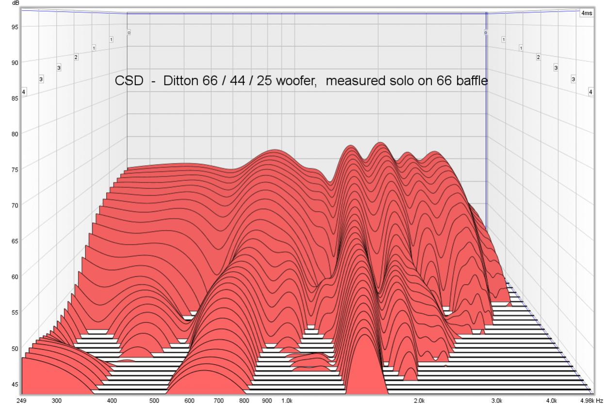

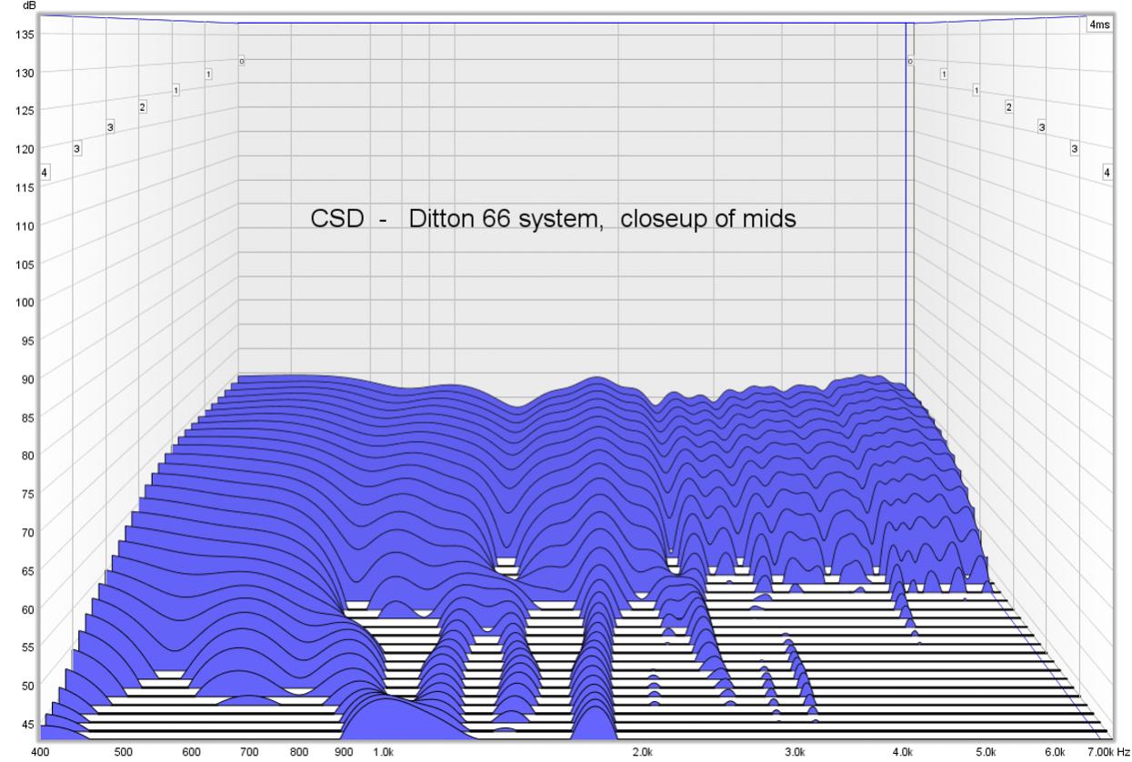

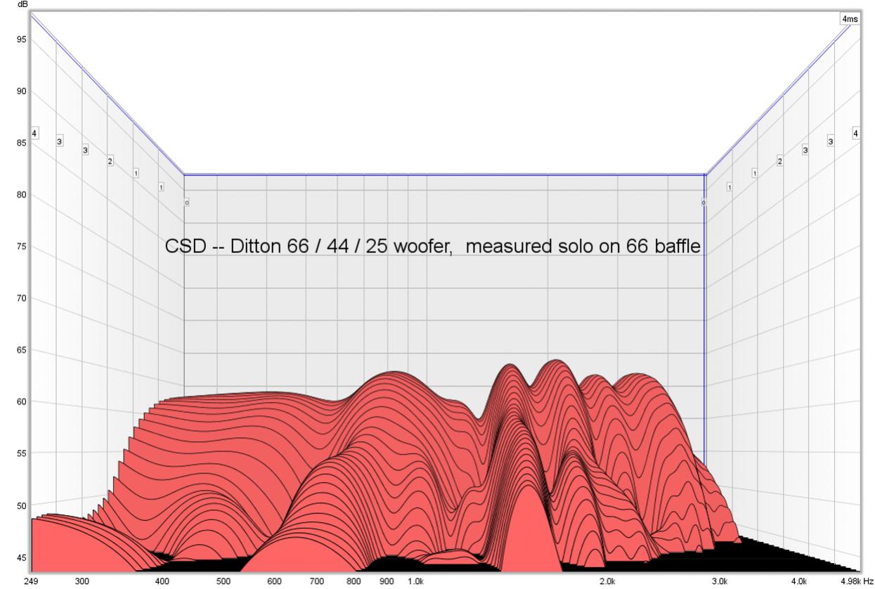

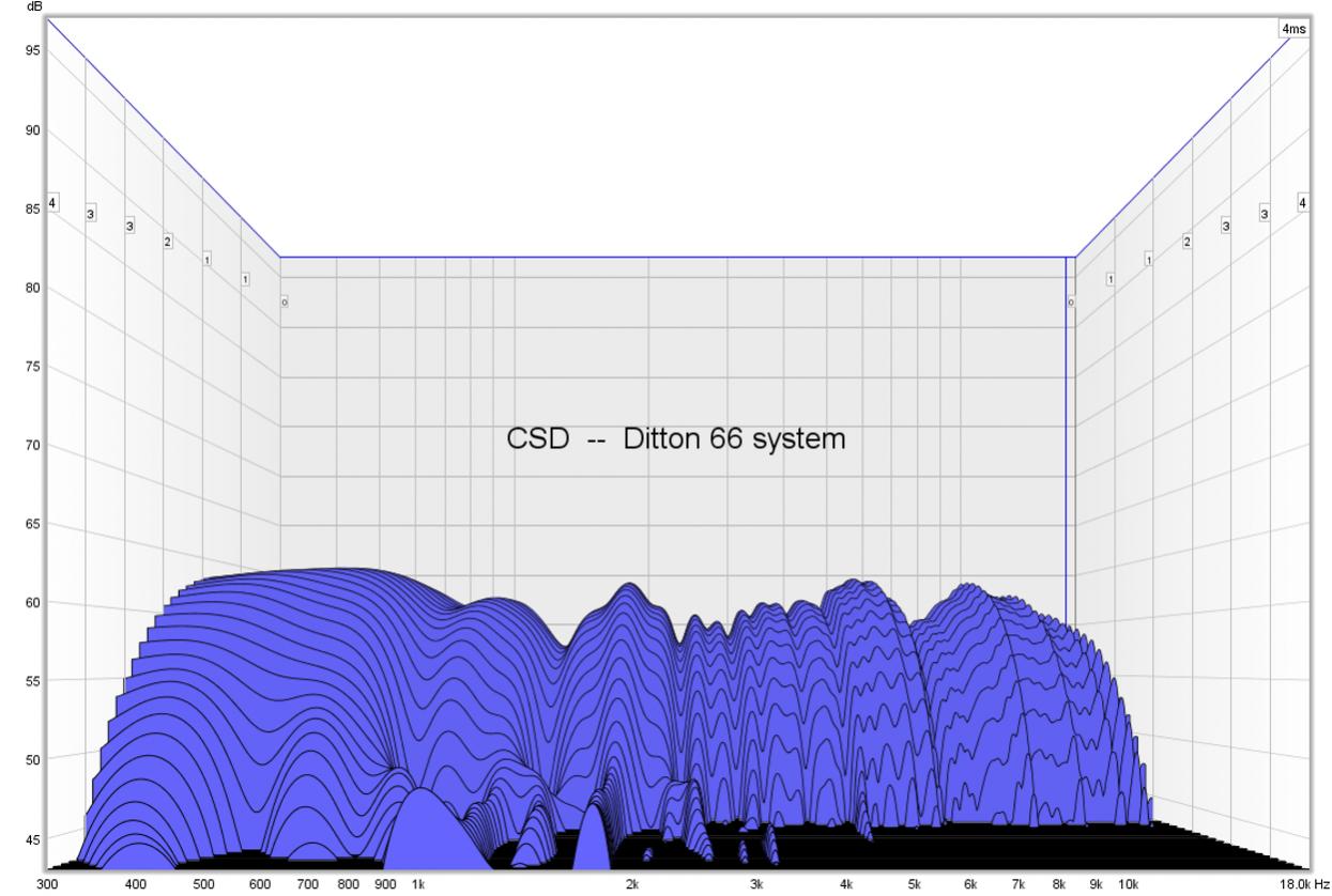

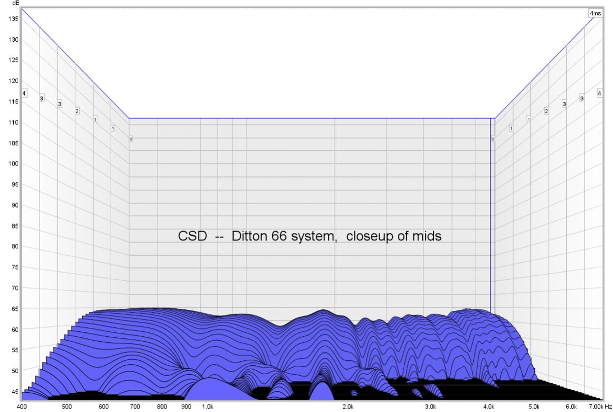

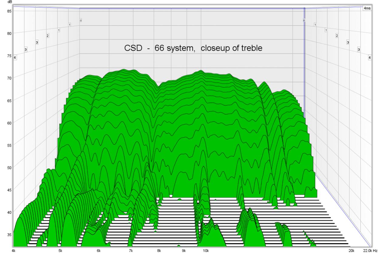

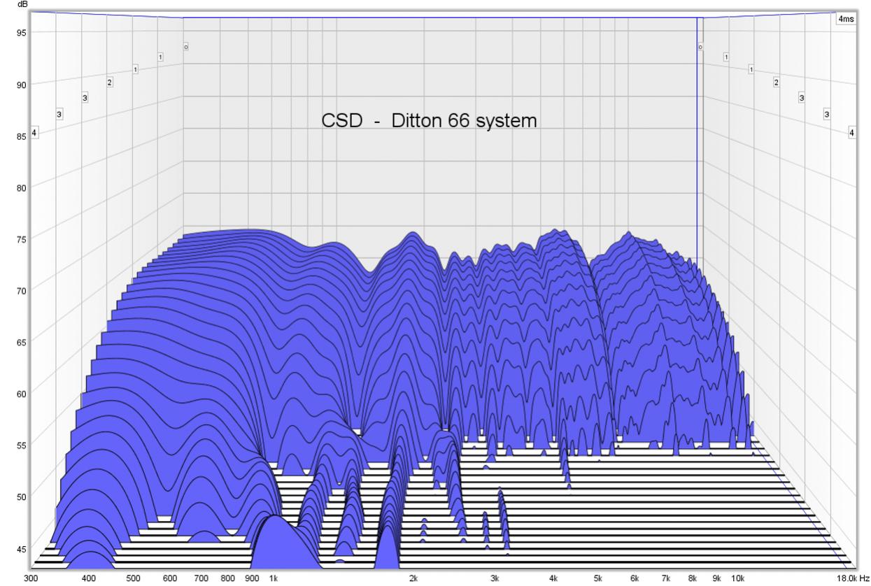

Measurements wrt sba #884 above
OK, I've re-read both of J. D'Appolito's articles.
From #884 above:
link = http:// ...... dappolito2959.pdf
This is very good to describe basics to readers new to measurements.
I refer particually to Page 3 - read carefully about the limitations of the measurement technique, etc ...
Also, in his mention of Diffraction effects disappearing off-axis,
I add that the magnitudes of the On-axis diffraction effects will usually reduce when measured Off-axis,
however there often occurs additional diffraction effects when measured Off-axis.
Refer to FIGURE 12 and you can see some if you carefully compare the Off-axis with the Grille Off plot in the FIGURE 11.
Back to FIGURE 11 - those Diffraction effects are caused by a Grille Frame, however any raised edges around the front baffle of a loudspeaker cabinet will cause similarly sized effects
- in particular with Celestion 66 that top of cabinet lip -{which I have several times mentioned in this thread}.
The reflection from that lip is too close in time to effectively gate out,
because if the gate time is set short enough to close before the lip caused reflection arrives there will be some loss of resolution of midrange signal data, thus some degree of error in the then displayed measurement.
Even when no raised edges around the cabinet, there is diffraction - simply from the 90 degree angles of front to sides of cabinet,
however the magnitudes of effects of those are less than from raised edges.
An Experiment:
If you want to try to visualize 90 degree angle diffraction, turn on the water through a Hose to high pressure,
then point the stream to the edge of a corner of a building.
Vary the angle from end of hose to edge of building till you see maximum effect.
See how the stream of water breaks up into an arc of many streams which splay over a wide angle around the edge.
If the pressure of the water could be got high enough that arc would widen further and include some spray back towards the hose.
In this example higher pressure = treble frequencies' sound.
Water pressure though a garden tap and hose cannot be got high enough to cause some reflection directly back to the end of the hose,
but treble frequencies' intensity is high enough to cause some reflection back towards a front placed microphone or listener.

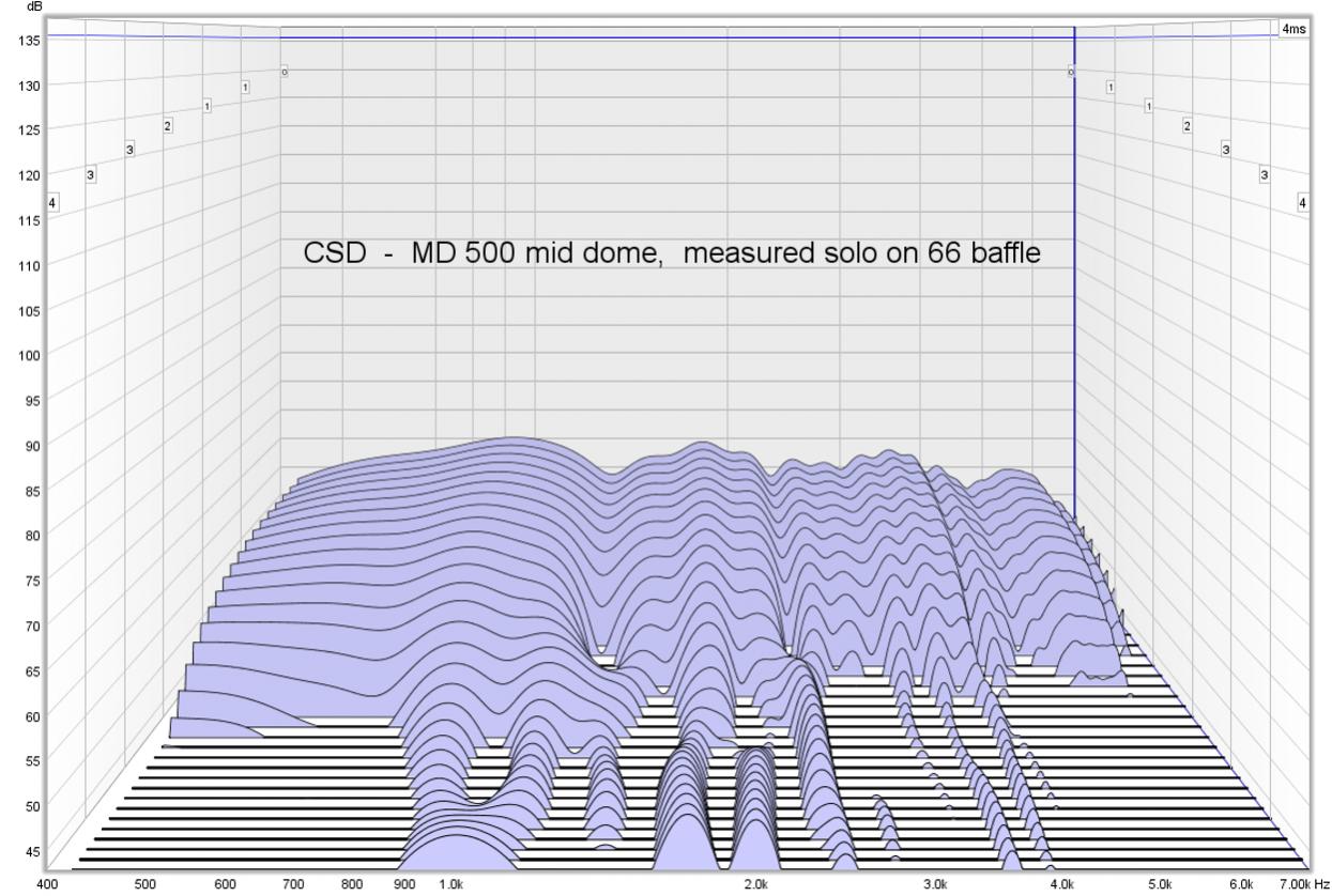

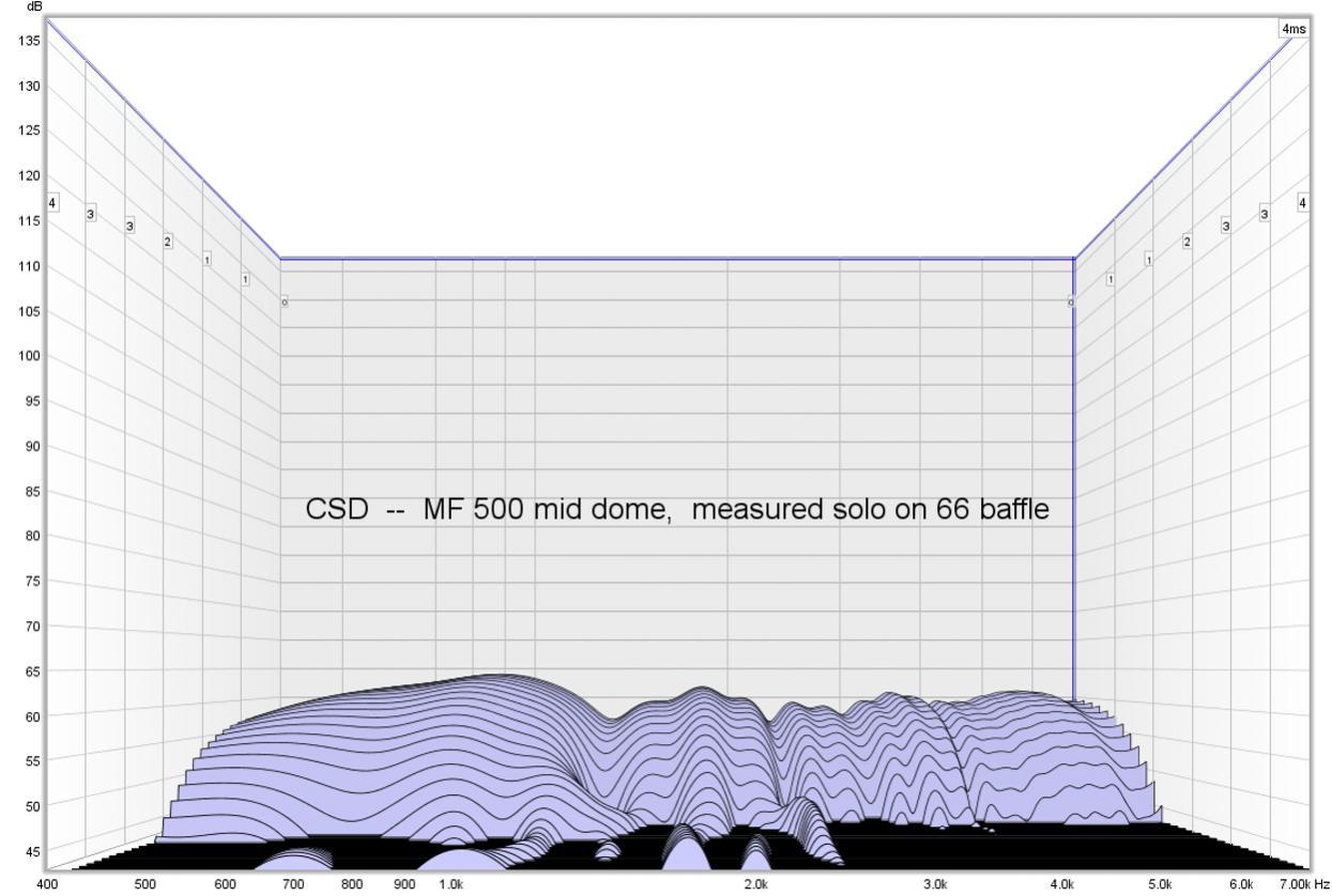

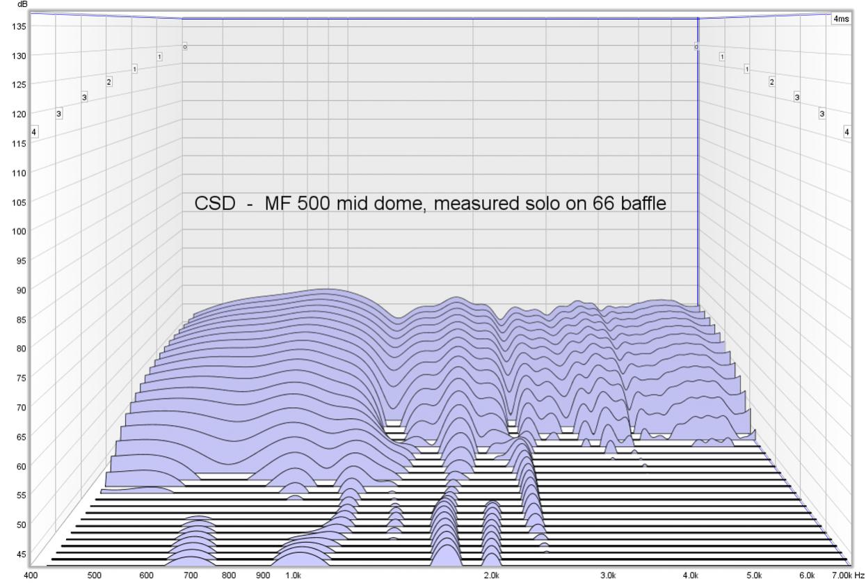

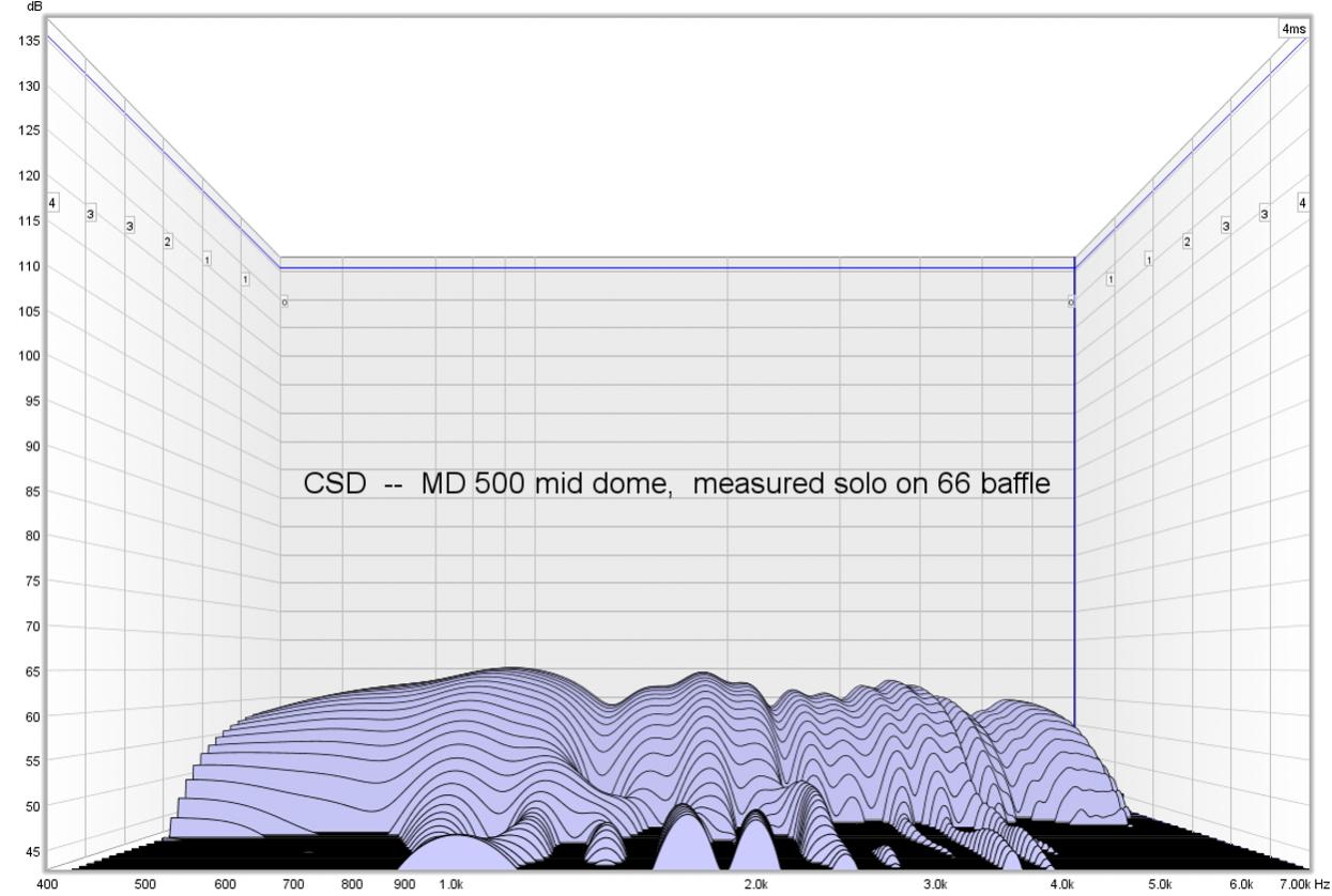

Page 4 is CSD measurements - if any of you have computer programs to do those,
and then refer to Page 5 and further.

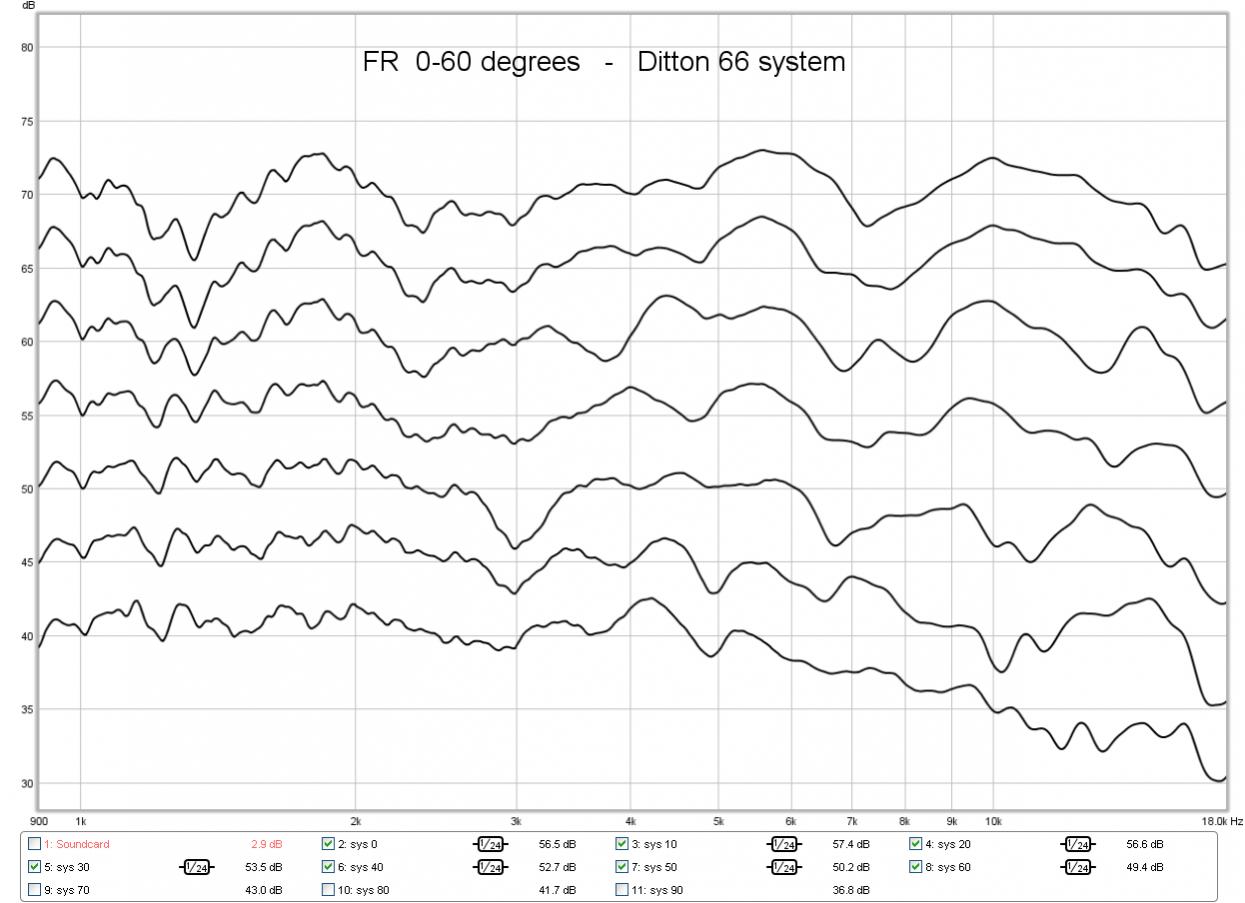

NOTE: the data in FIGURE 10 is to be compared to that in FIGURE 5, and not to FIGURE 7.

The "AudioXpress - June 2012" article:
Relevant to what we are doing in this thread - examining the drivers and crossover - the 1st and 2nd pages are sufficient.
Denny,
you can do some measurements that are not extreme Nearfield.

CSD measurements - if any of you have computer programs to do those…
The free program REW will do CSDs. Using my data from two years ago I generated some CSDs. The 20db range and 4ms time parameters follow D’Appolito‘s examples.
From the D’Appolito article--
"Resonances appear as ridges moving forward along the time axis…
Detection threshold for resonances: very narrow resonances (high Q) must be about 10dB above the average level to be heard, whereas very broad resonances need only be 1 to 2dB higher to be detected...
Diffraction effects can also produce response peaks and dips. These peaks and dips may persist in the CSD and be confused with resonances. Fortunately, diffraction responses are angle dependent and can often be isolated by looking at off-axis responses. Off axis response plots are more useful for identifying diffraction."
"Resonances are inherent in the speaker response and will persist at all off-axis angles… Diffraction responses, however, are angle dependent and tend to disappear off-axis.”

Waterfalls of the woofer--
CSDs - Ditton 66 woofer, solo
Waterfalls of newer model mid dome--
CSDs - Ditton Md 500 dome, solo
Waterfalls of older model mid dome--
CSDs - Ditton Mf 500 dome, solo

Waterfalls of the Ditton 66--
CSDs - Ditton 66 system
FR & IR plots--
FR & IR - Ditton 66
Waterfalls of the treble--
CSDs - Ditton 66 treble
FR & IR plots--
FR & IR - Ditton 66
