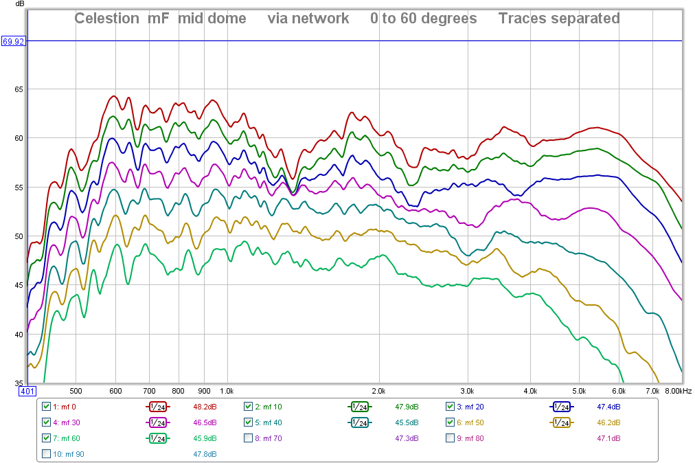

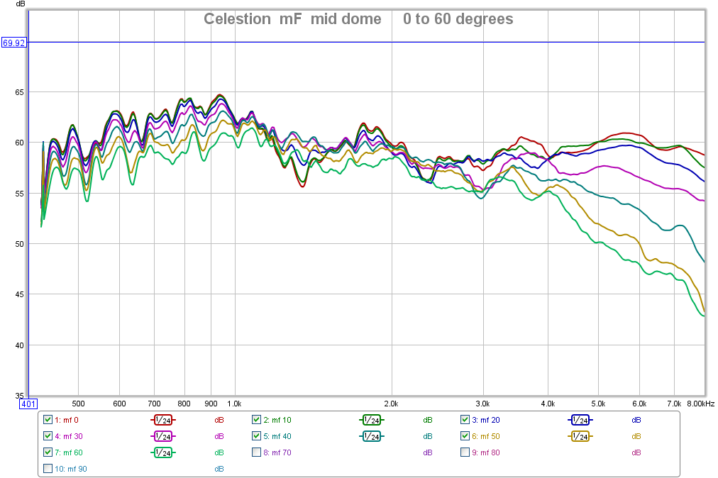

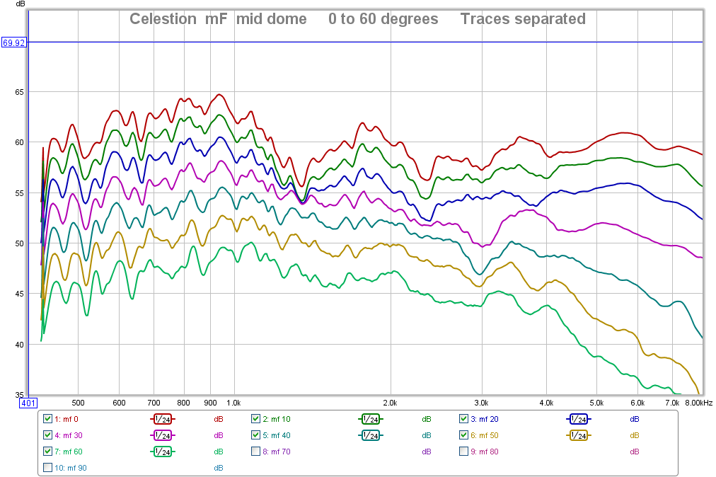

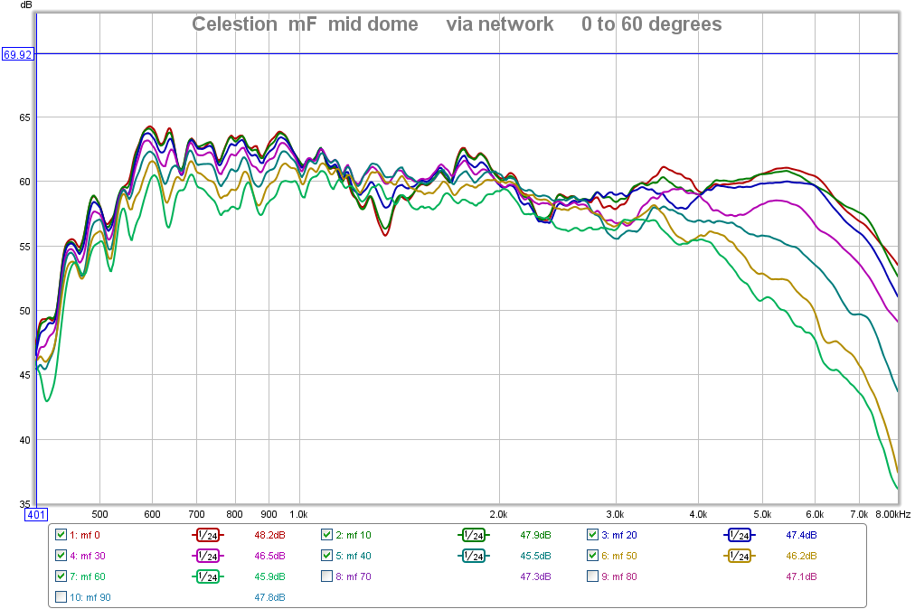

Alan,
That’s an insightful and clever solution !
And not reported ‘till now… While trying to solve that problem I found another. The mic’s phantom power supply / preamp (a Behringer tube mic100) was creating a significant amount of distortion. At least that’s what the audio analyser program indicated when I expanded a test beyond just the soundcard and included the cables, connectors, and finally the mic preamp itself into the in-out measuring loop.
After a lot of investigation I still don’t know the cause of the original problem, but a new soundcard installed on a different computer seems to work okay, so I‘ll use that setup. For the distortion problem I replaced the Behringer with a Rolls MP13 mic preamp, which also seems to work okay.
I don’t expect any major surprises from re-measuring, just perhaps a little more detail and accuracy. I also wonder how much the Behringer effected the distortion measurements. We’ll see! It was reassuring to see Celestion’s B&K plot.
Here’s some of the data you were wondering about. The colors here are synced to the original impedance plot, post #394.
I have two remaining md 500s (green & purple), and two mf 500s (green & orange). The other two mf 500s, (yellow & blue) were traded away.

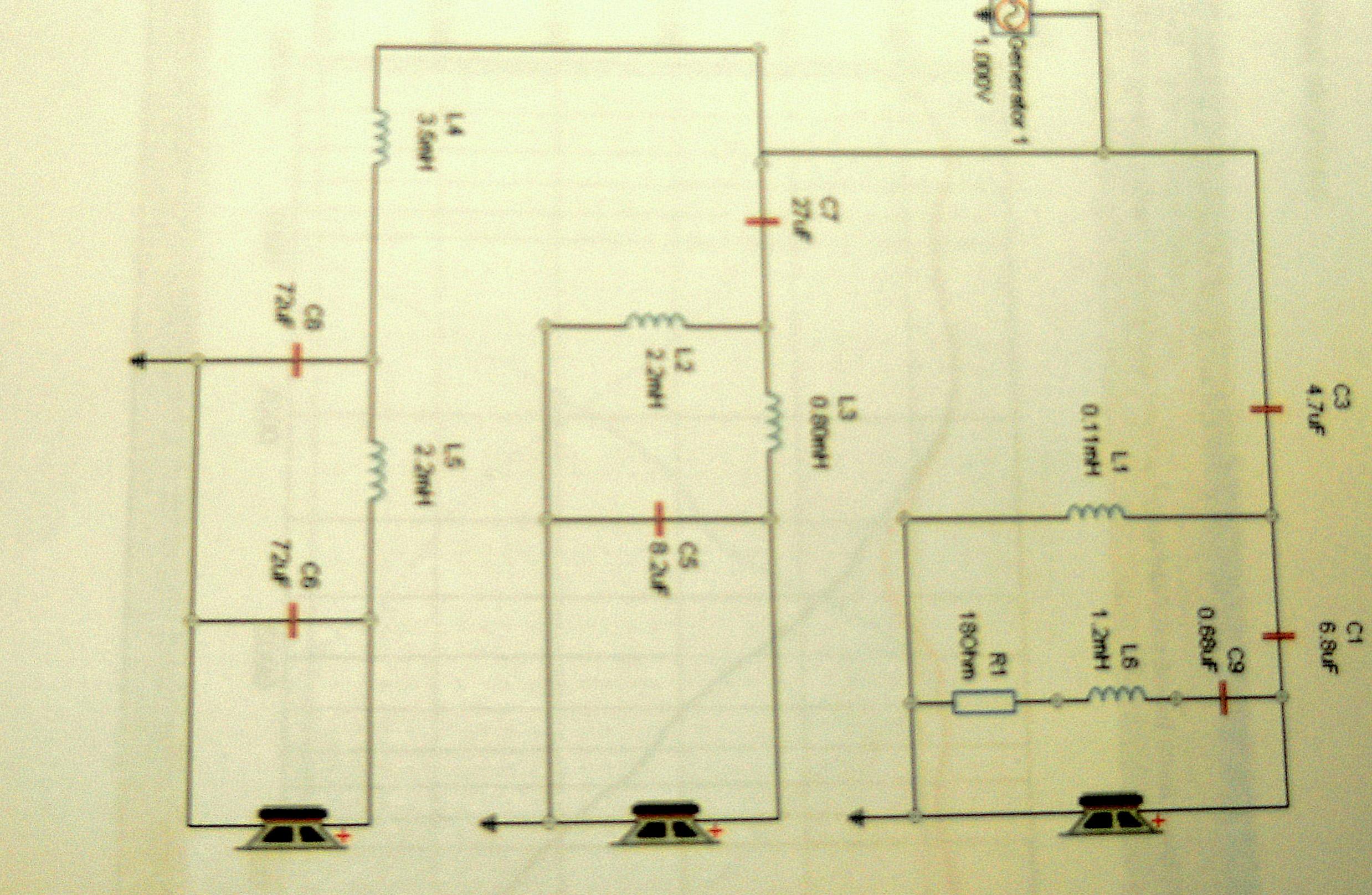

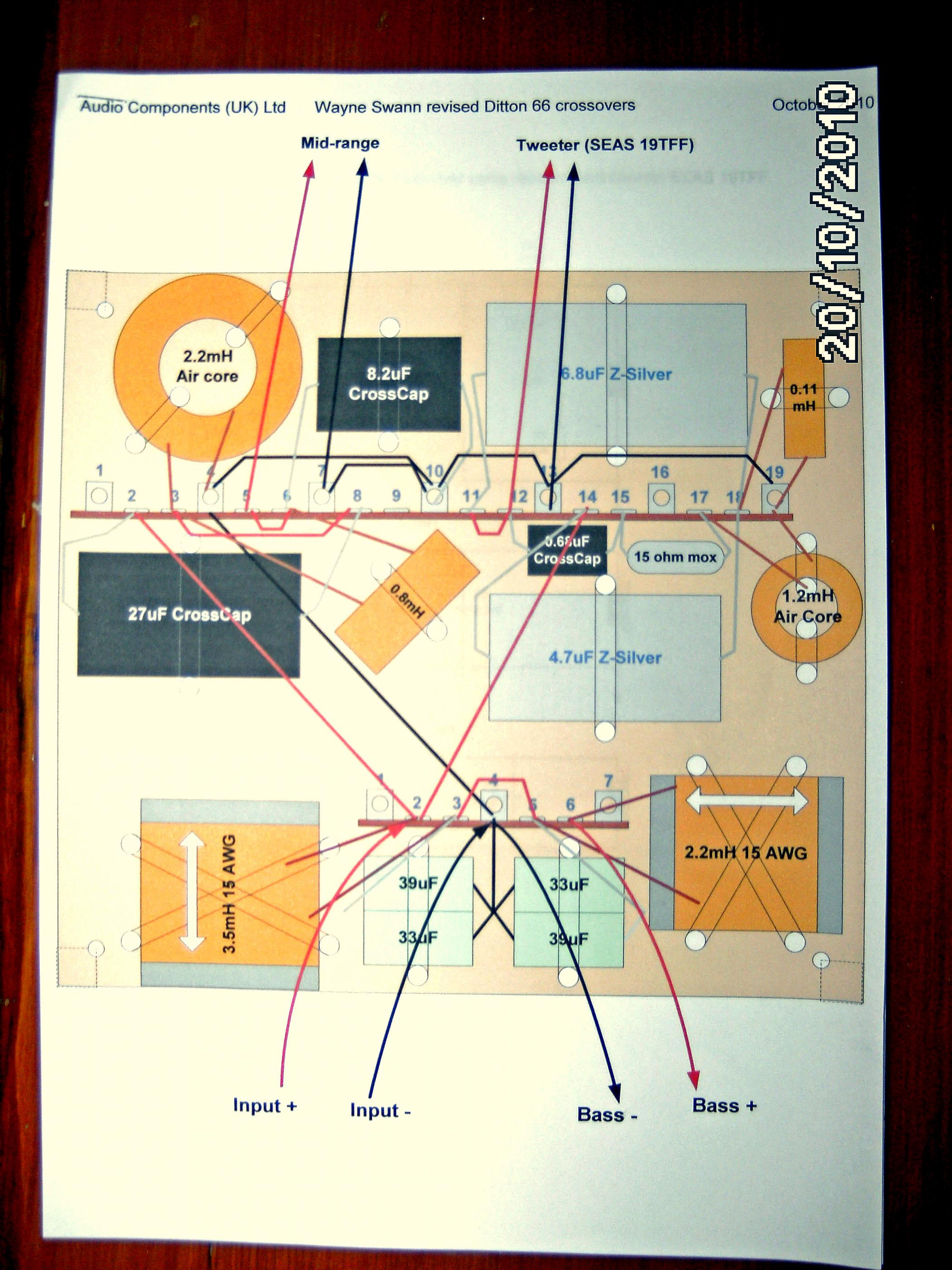

Finished the xover update . 82 ohm in parallel in the mid filter, and the 27 ohm in parallel in the tweet filter.. 0.5 r that was in series is gone. listened to mozart and am satisfied that all is as good as its going to be. toned upper mids down a bit, (I think)
No room left on PCB's for any more additions.

Hi Doug,
Good so far ... I presume you have now heard the SEAS tweeters better ..?
With the 3.9uF at input and 6uF at output of the treble filter there will be loss of treble in the region just above the crossover point,
because Celestion designed that crossover to remove the excess in the lower treble region of the HF2000.
HF2000 does not have a flat frequency response - it had higher output at the low treble end of its pass-band,
and the 6uF cap in particular was chosen to substantially reduce that.
The SEAS you bought has Flat Response through all of its useable pass-band,
thus with those crossover caps there is too much treble removed from the low end.
Ideally both caps should be changed, but you may be lucky and like the sound sufficiently with only one cap changed,
AND there is an experiment you can try before you buy anything:-
Do you still have the old treble capacitors which you removed when you installed the ClarityCaps ?
If yes, then which type are they:
- the very old type - black cylinder 2uF ?
- the intermediate period type - pale bluish-green 1.5uF and 1uF caps in Parallel connected bundles ?
- the final period type -olive green caps in 0.68uF + 3.3uF and 1.5uF + 4.7uF ?
I can describe how you can connect some of these to try restoring the lower treble balance to hear,
before you decide whether to buy another new capacitor in Parallel with the 6uF ClarityCap at output,
thus, what do you still have ... or any other capacitors ?

Design for new crossover matched to the SEAS 19TFF1 Tweeter
Please find attached two diagrams showing the proposed new crossovers for my Celestion 66's
Regards
Wayne
Regards
Wayne
Not this way for 66 sound !
Hi Wayne,
how/where/why did you arrive at that combination of components for a Celestion 66 crossover ?
(1a) - this will NOT give a clean modern version of the Ditton 66 sound,
because of the significant changes to the circuit, especially those to the low-pass filter section of the midrange circuit.
(1b) - why have you proposed that change to that part of the filter ?
(2) - it will sound excessive and forward in the midrange, because there are no attenuating resistors in what is a very Resonant circuit there.
(3) - the mid-dome may be damaged, or at least have its life reduced faster over time when the speakers are played loud, because of the 27uF capacitor.
Despite there being 30uF in the first version of the Ditton 66, Celestion reduced that to 24uF for good reason - to not permit excess low mids to drive the mid-dome.
(4a) - it will sound compressed and weak in the bass when driven hard, because of those cored inductors you have indicated.
Why are you changing from the original air-core inductors ?
(4b) - are those small-drawn caps in the bass filter plastic film or electrolytic ?
(5) - tweeter response is hard to predict straight away, but I'll study the circuit and reply further when I've evaluated the treble filter.
(6) - are those horizontally placed L1/.11mH and L3/.8mH inductors also solid-core of some type ? ...
and if so, why ?
(7) - it is a waste of money to buy the expensive Jantzen "Silver" caps if they are put into a circuit which is not optimised for balanced coherent sound.
Expensive capacitors cannot improve a flawed circuit design.
You can of course buy the components, and build this crossover - that is your right, and perhaps you will like it, but many have gone down similar paths and regretted it.
It looks very unbalanced to me, thus I'm interested to hear your reasons for proposing it ..?
Hi Wayne,
and if so, why ?
Crossover Design
Please see Attachment.
Hi Wayne,
Ask these things:
Hi Wayne,
very interesting, but the provided explanations omit some relevant matters,
especially about the Bass performance !
... however, before we get to that, I recommend you ask your circuit designer the following:
(1) - why is the C9 - L8 - R1 network in Parallel with the SEAS tweeter tuned to 5571 Hz ?
I would have thought it should be tuned to the tweeter's Fs, which is about 1600 Hz ... for which C9 would be about 8.2uF.
Perhaps there is an error there ..?
(2) - regardless whether the C9/L8/R1 network is correct or not, L1 is a very low value, and in combination with C3 and C1 will cause a lot of loss around the 5kHz region.
Why has that been done ?
(3) - despite the mention of Impedance Correction for the MD500, there is not any impedance correction circuit included for it, and especially not at the low frequency end where such could be most beneficial.
Why is it not included ?
(4) - the annomolies in the upper midrange Frequency Response of the MD500s - are these YOUR samples of MD500s, or other samples ?
As sba showed with his measurements, these old mid-domes do have annomolies, AND those vary between samples, thus whose Samples are shown in your measurements ?
(5) - in the midrange filter, L3 and C5 will cause substantial loss of output in the region just below 5kHz, thus when combined with the seeming large loss in the same area of the frequency spectrum caused by L1/C3/C5 in the treble filter, I think it likely there will be a hole in the frequency response there - a very audible one.
Perhaps there is an error in the calculations, or in the printed results - ask that to be checked ..?
(6) - the Resistors I recommended are NOT there to degrade the performance of the new capacitors {to make them sound like old capacitors},
they are there to keep the midrange in coherent balance with the treble and bass that is audible in this loudspeaker.
The 66 is a Balance of Compromises, and some of that I explained in various places during this Thread.
All loudspeakers require a Balance of Compromises, and if you want to update the sound using the old ABRs and woofers and mid-domes you will have to use another type of Balance of Compromises , otherwise some parts of the frequency spectrum will not be coherently in time with others when music is played ,{as distinct from steady state test tones}, - in other words, it can sound like a wobbly mess.
Enquire Points (1) <---> (5) inclusive first, and Post the replies, and then I will discuss the Bass issues ... if there seems to be any sense in proceeding with this design.

New crossover design
Hi Alan,
The crossover configuration is optimum for the actual drivers in the baffle at 2m on and off axis.
Some adjustment to balance may be required due to the reflective characteristics of my living room, speaker location and my personal preference. So once I have listened to the result I can then make a judgment and changes can be made.
Regarding the mid-range damage due to the change of C7 from 24uF to 27uF – this will not cause damage to the mid-range driver. Calculating the difference in effective attenuation at the lower crossover frequency (500Hz) between the two capacitor values give a 0.54dB difference - this is barely audible at this frequency (about 1dB is audible) and will increase the mid-range diaphragm excursion only slightly i.e. about equivalent to increasing the volume on my amplifier by about the same amount. 27uF is used because it gives a flatter response anecholically.
I would be interested in your views regarding the bass section.

Hi Wayne,
Hi Alan,
Cheers
Wayne
About the midrange drivers:
Hi Wayne,
are the plots' measurements of YOUR particular MD500s, or from other samples ?
Hi Wayne,
Hi Wayne,
Hi Alan,
They are mine.
Regards
Wayne
