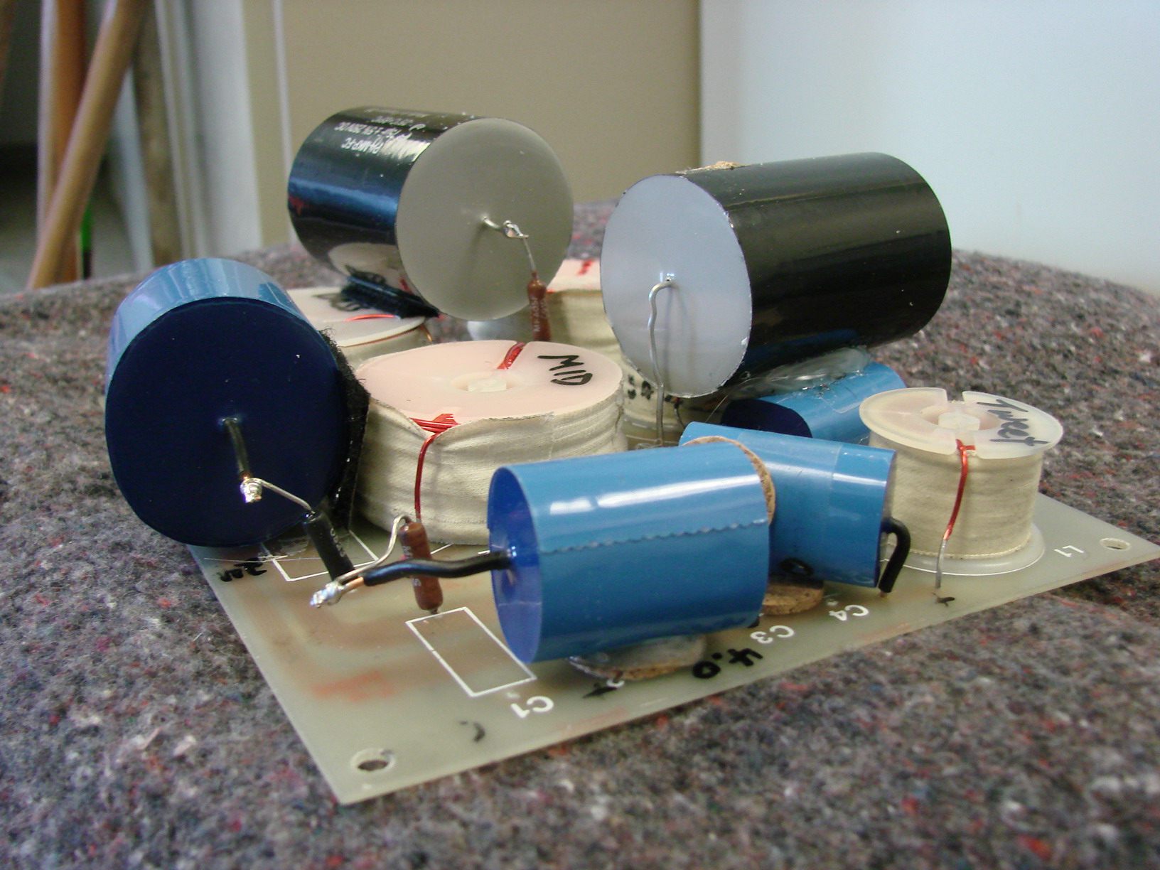

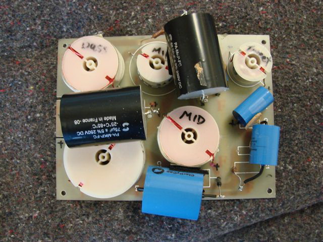

ESR Resistor Locations?
This is truly an informative post, I’ve spent the last few days reading through its entirety. Being totally new to all this, it has been quite the task trying to grasp all the information being posted.
My Celestions were purchased new by me in 1980 or so and have been a great sounding speaker in my view over the years. Although, as of late they seem to be lacking and given their age, are probably in need of a refurbish/update to the crossovers. All drivers appear to be OK and in good working order.
My crossovers are the PCB versions, so my plan to update is as follows…
Replace caps with Solen 250v PA series as outlined…
C1, C2 = 6.2uF
C3, C4 = 3.9uF
C5 = 3.9uF
C6 = 2*36uF for 72uF
C7 = 24uF
C8 = 2*36uF for 72uF
May consider a 68uF @ C6 and 75uF @ C8 ??
ESR Resistors, Mills MRA-5 as outlined…
C1, C2 – 6.2uF = 0.5R
C5 – 3.9uF = 3.3R
C6 – 72uF = 1.5R
C7 – 24uF = 1.5R
C8 – 72uF = 1.0R
What I do not totally understand and has me puzzled, is how and where to physically place the ESR resistors, given the compactness of the PCB crossover layout.
Eg. For the 2*36uF caps at C8, I need to raise them above the 2 inductors, using the caps legs to support themselves. So how should the 1.0R be placed; as part of the leg supporting the caps and will it be stout enough to support the caps over the inductors?
As I stated, I’m new to all of this, so any help, explanation would be greatly appreciated. If anyone with the PCB version crossovers, has some pics they could post of their updated crossovers, that would be awesome.
Thanks, Dave

Hi Dave,
I thought I had posted details somewhere in this thread about the placement and mounting of both the capacitors and the resistors ...
but if such is not here-in, then go to the thread titled:
Crossover nightmare!!!!!!!
started by lorienblack .
It is about Celestion Ditton 44, which has a very similar crossover to 66.
I posted some things in there which may be relevant to other things you are wondering about also.
{There is stuff in there that is irrelevant - I think you will easily identify and be able to evalute or ignore.}
Best is to make new, larger boards to mount the components on, and hardwire everything
- directly connect the components to each other via their own leads, and to a centrally located Ground terminal for the returns to -ive.
There are some photos of large board constuctions in this thread,
but if you want to keep your pcbs, then first look through all the thread again,
because it is very time consuming to type detailed explanations,
and currently I have very little time available for DIY,
but I will look at this thread again in a few days to see what you have found, and what you may need to know next.
For questions that may arise after you read the other thread, post here, not there, if they are 66 related.

Moermusic...
Thanks for posting those pictures of your crossovers, man are those caps ever HUGE. I was considering doing an extension to my PCB, to hold the caps I got to replace the 72uF or really take the plunge and build a new board to house everything. After seeing your pics, it made my Solen caps look tiny, so I went ahead and just used the PCB as is. It all turned out better than I thought it would, all the caps fit nicely on the board, with a few new pinholes drilled and I piggybacked the 2 36uF (for the 72uF), similar to how you have yours, over the inductors.
Thanks again for the pics... gonna go listen to some music =)

Moermusic...

66 Caps
Those are a Solen 68 & 75 cap. vs using 2 36's in parallel. found all that I used on page 39, post 384. Now to find Alans stuff re SEAS tweeters. Till next we talk. Doug
