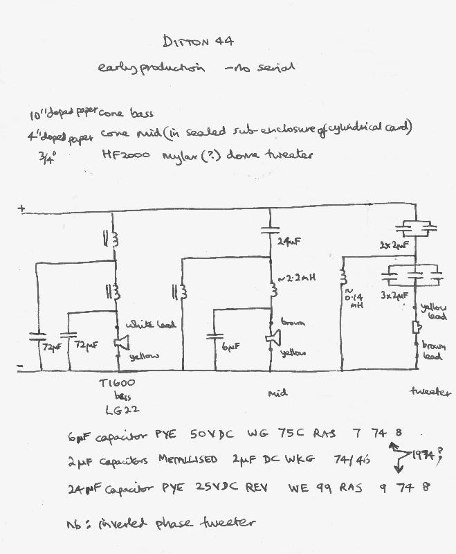

Before Christmas I posted I had acquired a pair of eBay blackie 66s. These duly arrived in full working order, with all drivers working and no unpleasant noises. I have spent a month listening to them with various different amplifiers and ***** them as follows. They are rather poorly balanced and somewhat lacking in high frequencies with a somewhat overpowering mid range. The bass is firm when driven by the right amplifier - my 211, but hopelessly flabby and overpowering when driven by parallel 300b amps. I tried a quad 606 but the 211se gets the best out of them. Overall, pretty good for a 30 odd year old speaker. The crossovers have had a couple of caps changed (well done too!) and utilised 28uf for the mid. 2 off 12uf an a 4uf all in parallel.
Anyway, after a months assessment I decided it was time to measure the crossover components and as expected from the contents of this thread, all the caps are way out of spec. Most measure way over so I suspect they leak heavily. I replaced the worst with assorted caps from my parts bin which immediately improved matters. As a result I have ordered new polypropylenes. I decided to use close tolerance 1% Daytons which have the advantage of being available in the correct values without mixing different values. I've used them before and they sounded OK to my rather poor ears. They are cheap too. I'll report back when they arrive. I have read this entire thread and found it very helpful.

Hi Phil,
the Dayton caps should be fine - I have heard the basic Bennic capacitors, which Daytons are, many times.
Yes, the advantage of the +/- 1% tolerance.
30uF // 40uF summing to 70uF is close enough for the 72uF locations, in particular for the cap closed electrically to the woofer.
Three of 25uF in parallel summing to 75uF would be fine in the other 72uF location, if you want to compensate for a little less in one part of the filter by using a little more in another part this is the way to do it with absolutely minimal detuning of the filter.

Hello Alan,
The Daytons arrived this morning and I have installed them. the values chosen were 3uf *2, 4uf ,25uf - based on the fact it had 28 before. For the 72uf I decided to order 75uf caps with 10% tolerance and make the best of the four that arrived. As it happens they all measure between 72.5 and 73.5 so thats close enough. Initial audition suggests a great improvement - much more than I was expecting. It seems to have toned town the strident mid range and greatly sharpened the high frequencies. As high as I can hear anyway which is about 13kHz. I will wait a while before I decide to install resistors to get a true picture over a large range of material.
I have not come across cathode coupled windings before and I found it most interesting. The 211se has no cathode resistors or caps, the cathode being strapped to ground, but the 300b does have cathode bias, which probably explains what I heard. I had assumed the problem with the 300b amps was poor impedance matching as they are very good with other speakers. The 300b amps will probably end up on eBay.

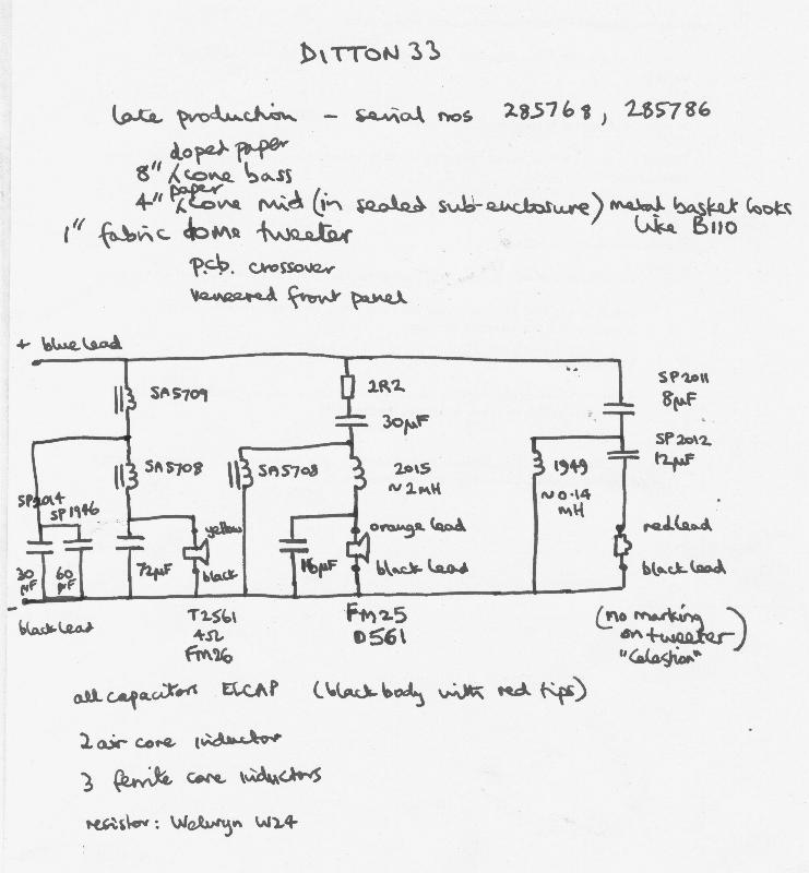

Tweeter Polarity in Ditton 44
Very interesting harnfield ... 44 versus 66 tweeter connections.
As an initial suggestion, try changing the Polarity connections to the tweeters in your 66s, that is from the current Reverse to positive tweeter terminal to the caps' line, and negative tweeter terminal to earth.
Any preference of one way to the other ?
What do you like or don't you like about the change ?
I won't load your anticipations by saying what you might hear, other than to try a somewhat different listening height, if comfortable to do so, or if you have short sturdy speaker stands to try.

I'll type some comments inside the Quote Box, following each of your points, ---->
Readers can easily see the relative sizes of the Dayton and Bennic caps from Phil's photo, and judge whether a 75uF will fit on their x-over board between the inductors.
----> Well you are lucky, though I think with the 75uF caps they may be close to the nominal spec. because few, if any, other Companies will be buying 5% tolerance 75uF caps, thus the best within the 10% spec. are also sold at the cheaper price, and you got some !
For the smaller cap values I'll bet all the 10% Bennics are outside +/- 5%, because the within 5% ones will have been selected and sold to re-sellers of 5% Bennics, {there are some}, and the very closest to nominal value will likely have been selected and potted in white and sold to Dayton for their 1% caps.
----> That's because you have a Nylon strung guitar from which there will likely be no Harmonics above about 13kHz and you have conditioned your hearing as result of playing it !
{heh heh}
Interesting, because from what harnfield has reported it seems the Blackie era HF2000s may be strong output between 5kHz {with this x-over} and approx. 10kHz and then slope down a little in frequency.
They probably still extend to 20kHz, but at -6dB with reference to their below 10kHz level.
I am guessing, but I think HF2000 may have been intended for use as high treble specifically, with a x-over designed to roll it in above 13kHz where the HF1300 starts to drop off significantly.
That is, HF2000 similar in application to the old Coles Supertweeter.
I see Coles have a CE 4001 supertweeter now, and I wonder what the shape of its Frequency Response plot is ...
hopefully harnfield has been able to get a Plot from Coles, and can tell us, or Post it in the thread ...
Any luck harnfield ?
