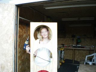

What do all those letters mean>? I do not think I could get along with someone like that. A true infinite baffle can not been seen in the listening room. My girl joins me in my passion for good sound.
