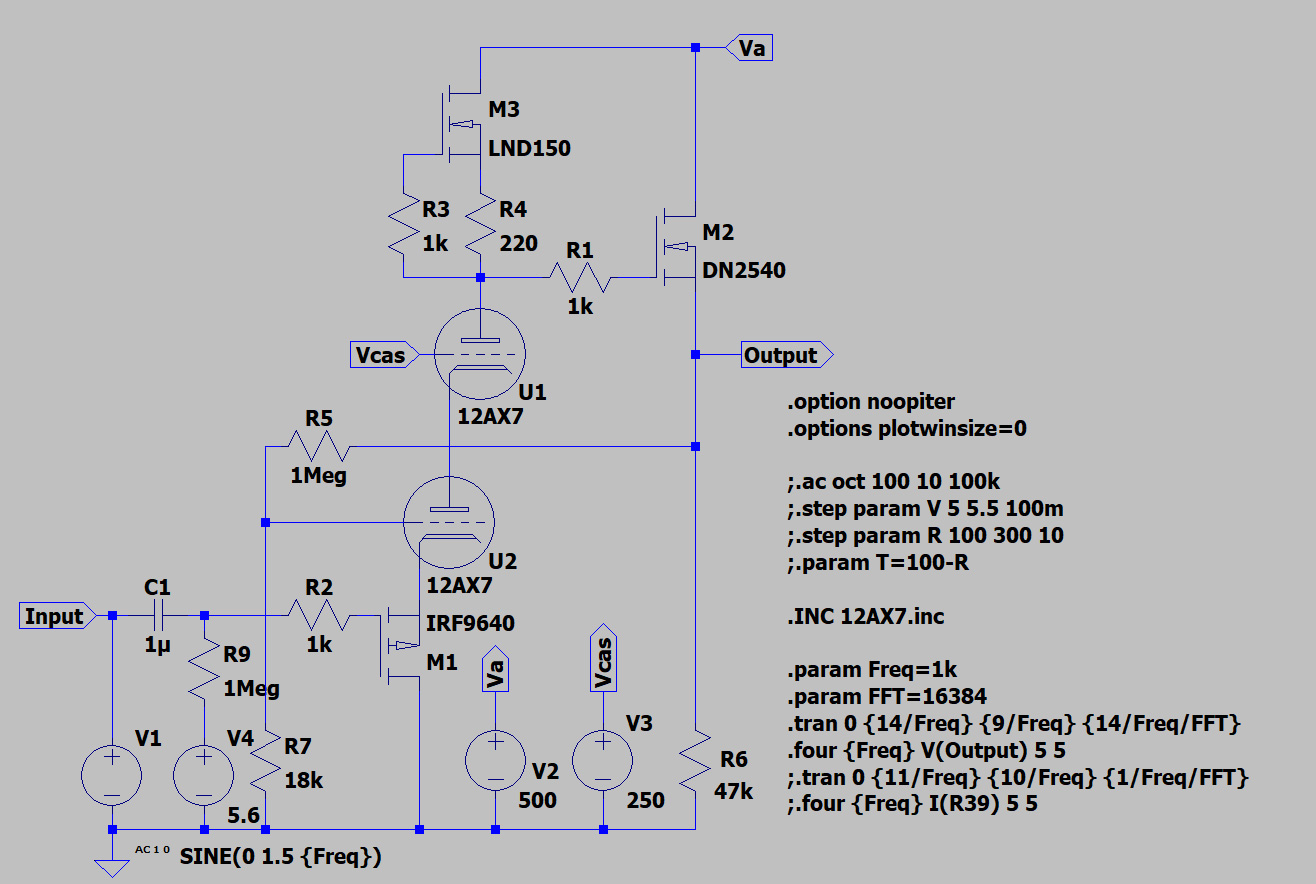

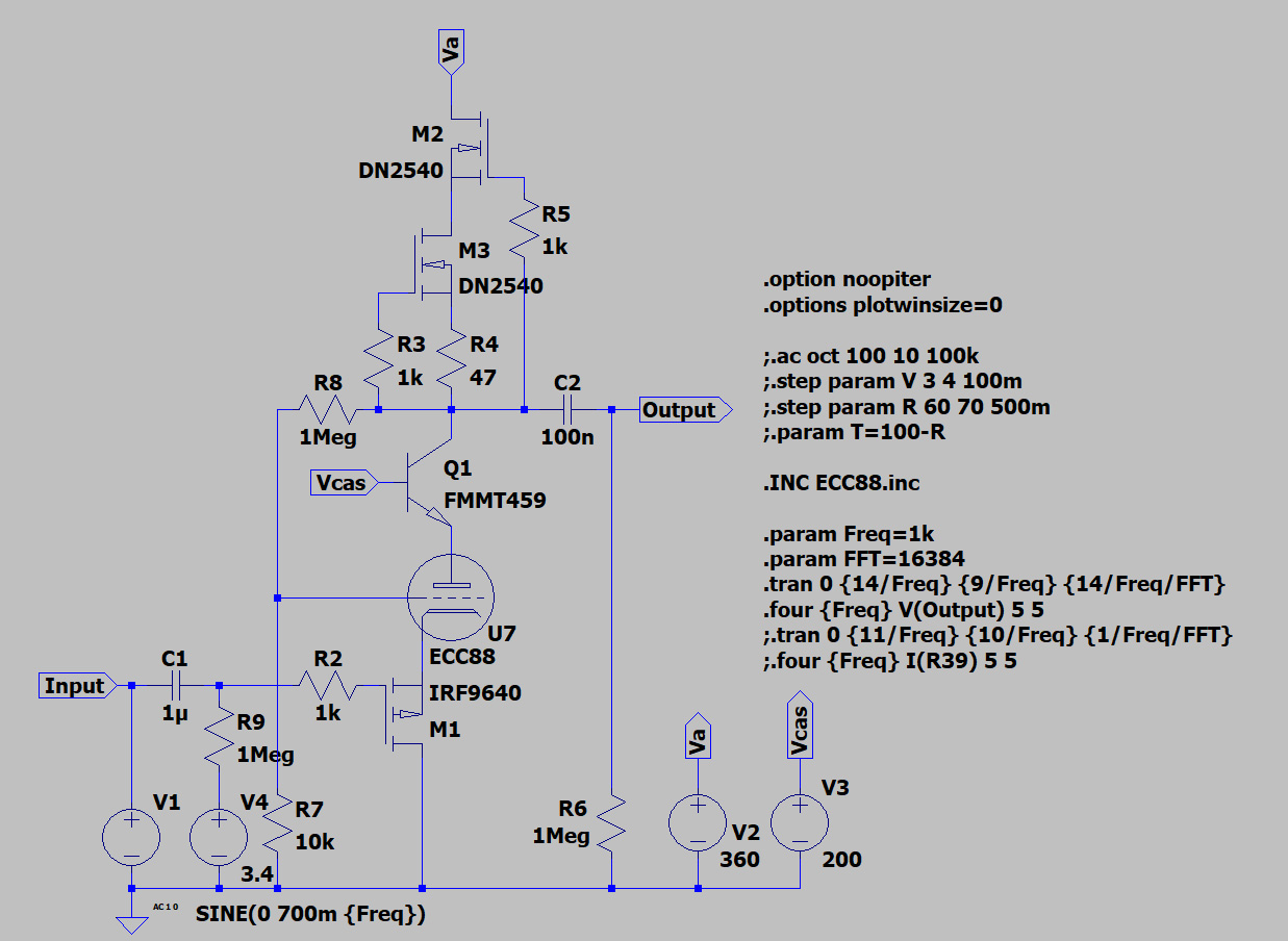

CED/UNSET/CORONA-like ECC88 hybrid cascoded driver
Yes, I'm also sure that different tubes of the same kind will give different results too in reality. I need to define a BOM of other possible variations as well, then order all the needed from mouser.
The layout will be important too, because input and output are in phase.
