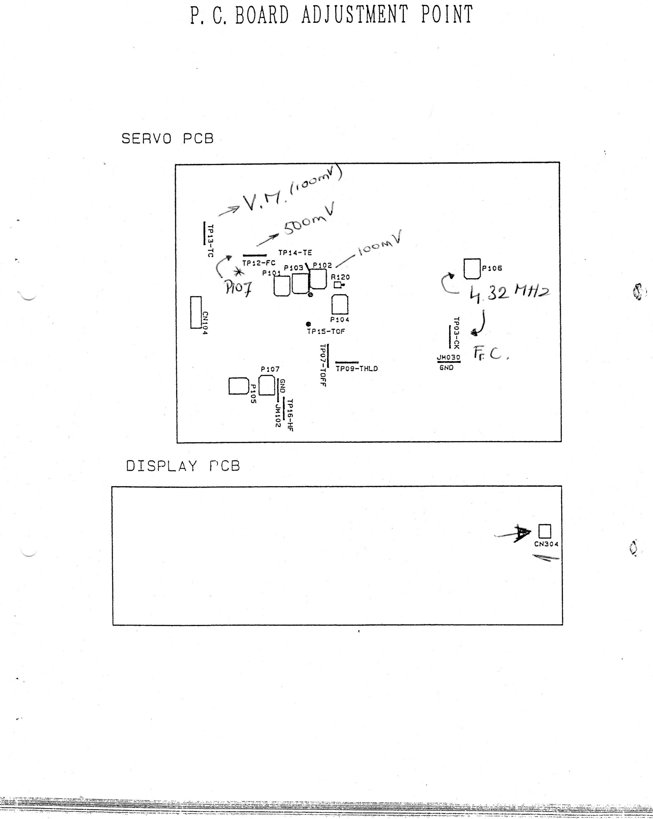

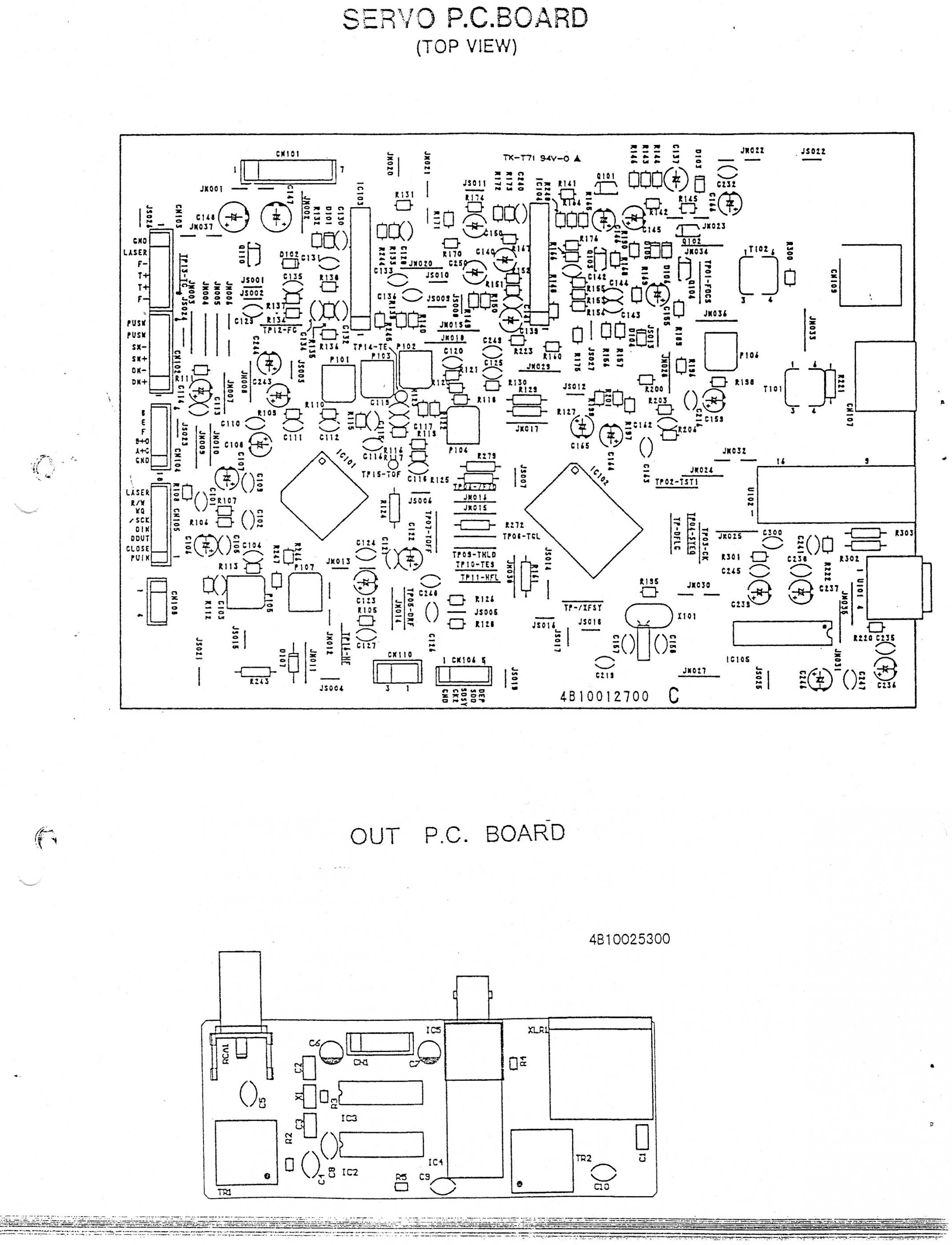

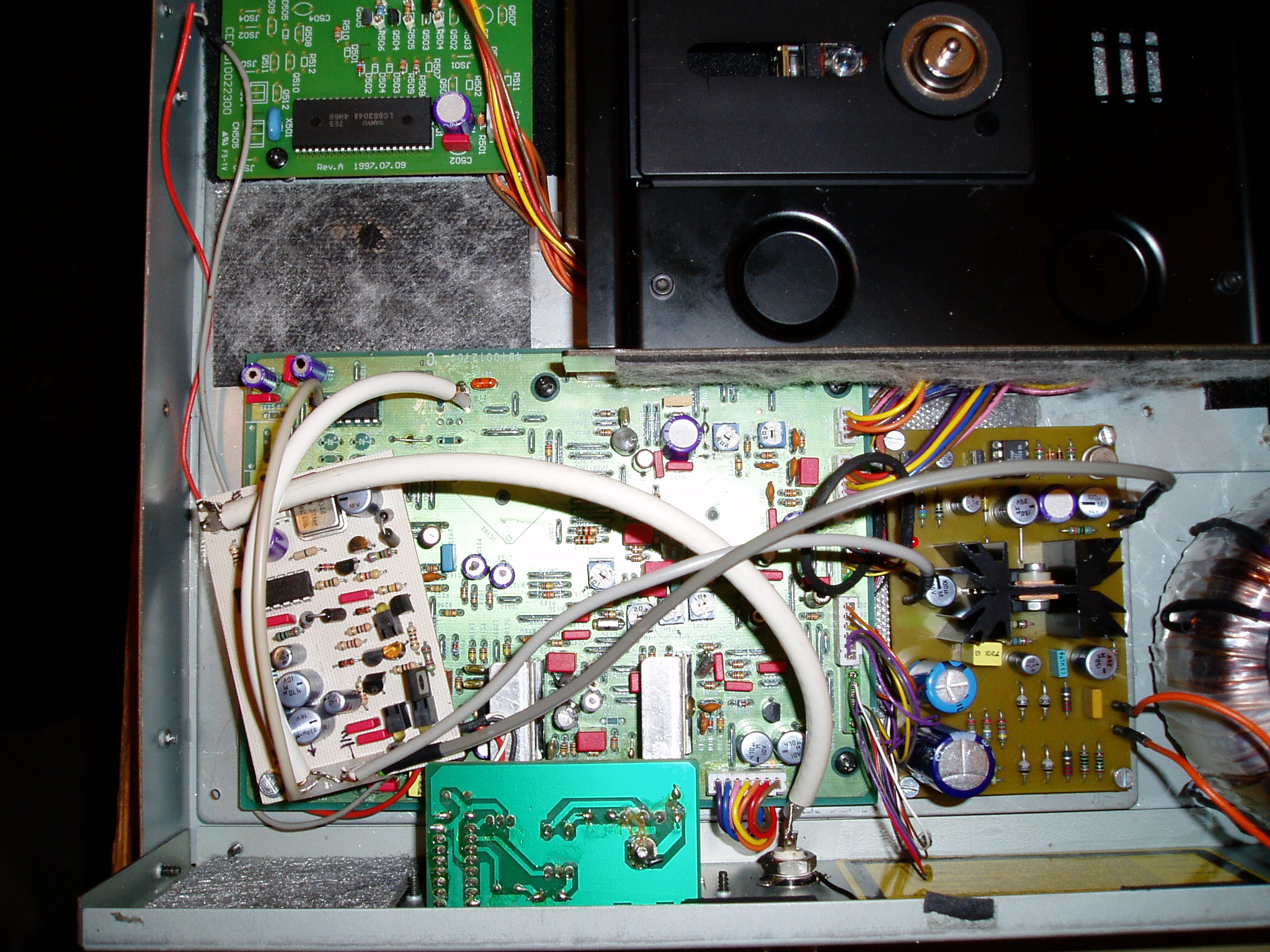

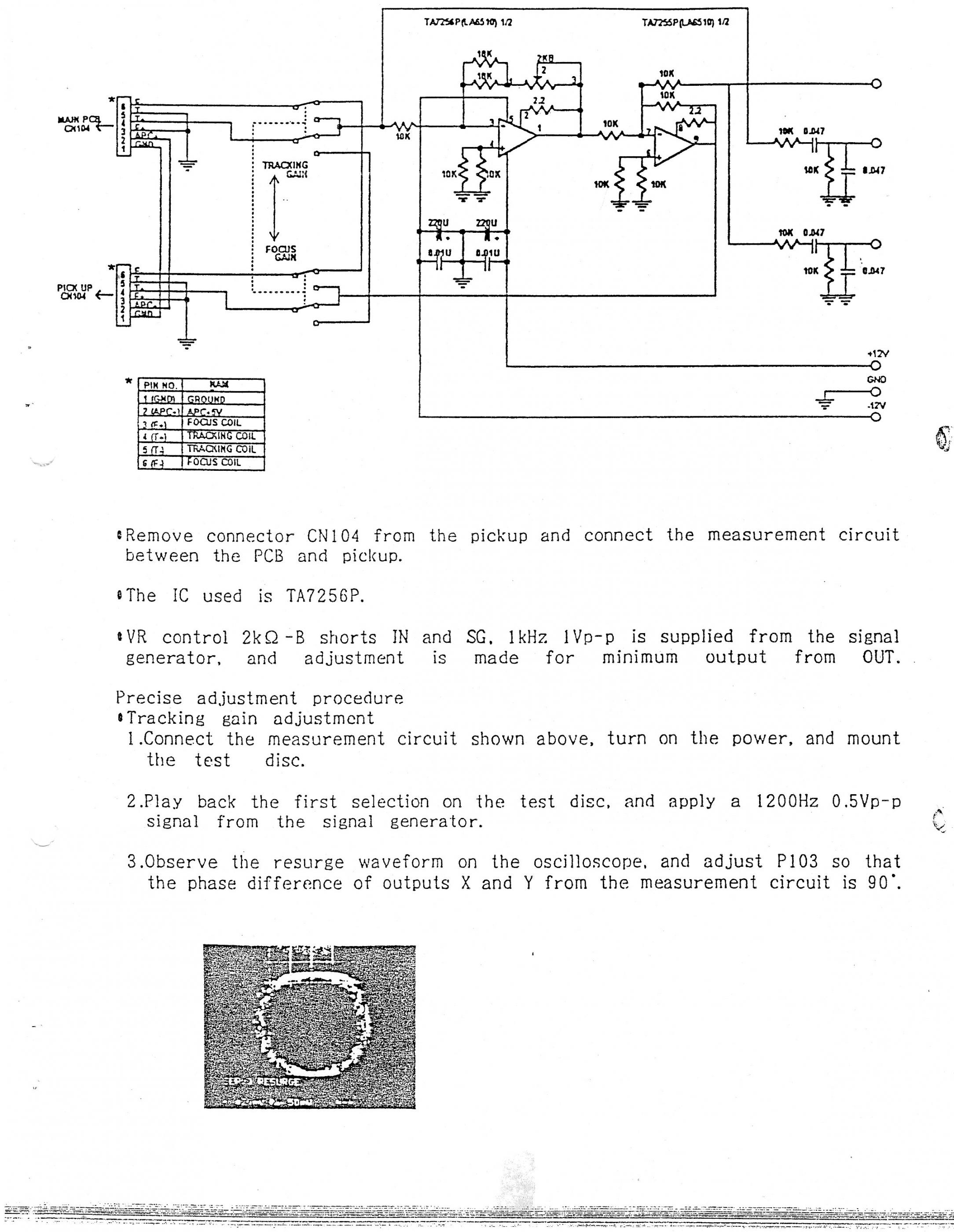

Hello , i need help from you guys if any one have this model and could take a photo of a main board with adjustment pots , i find some picture on net but with poor quality .
THX in advance

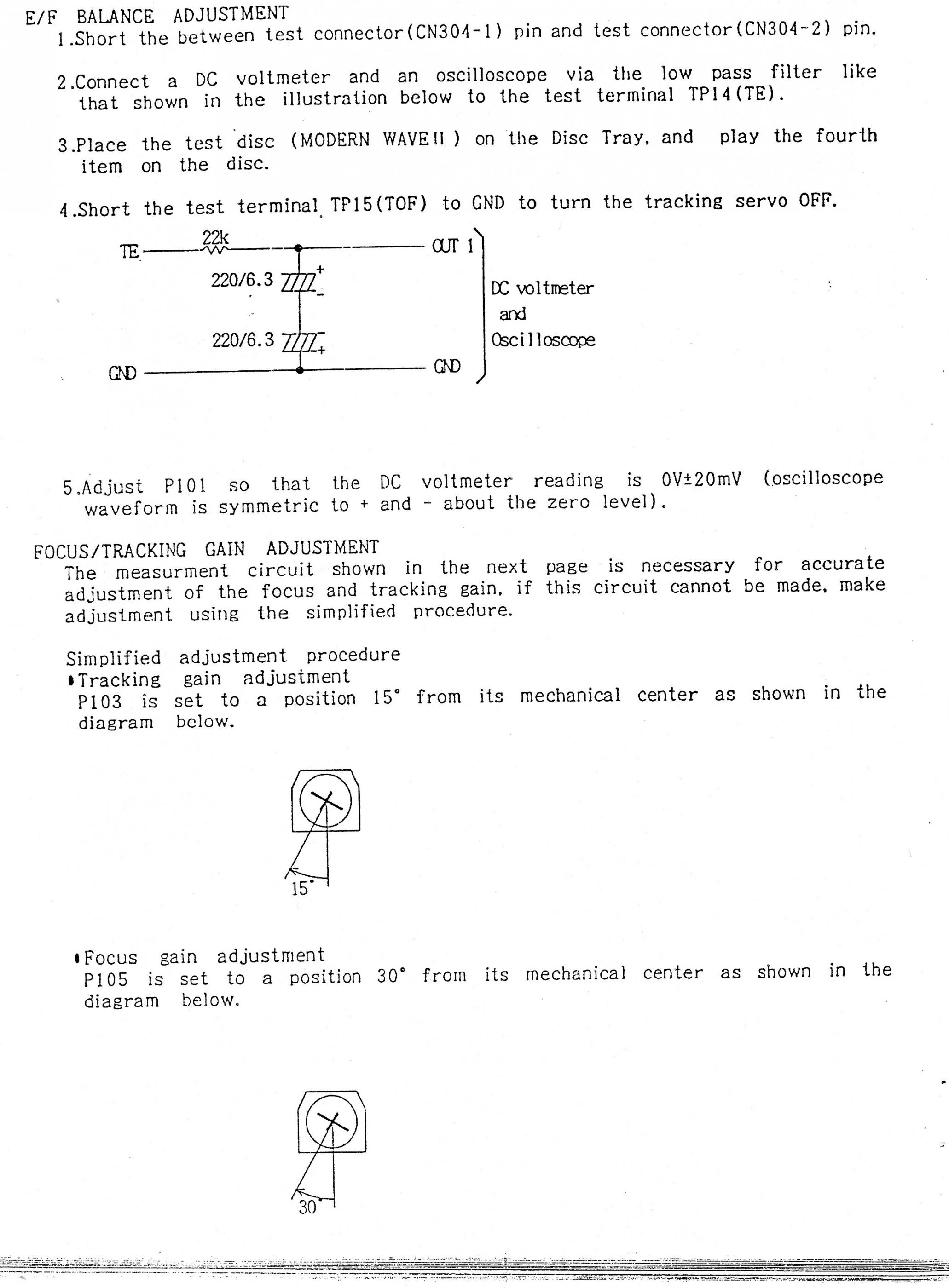

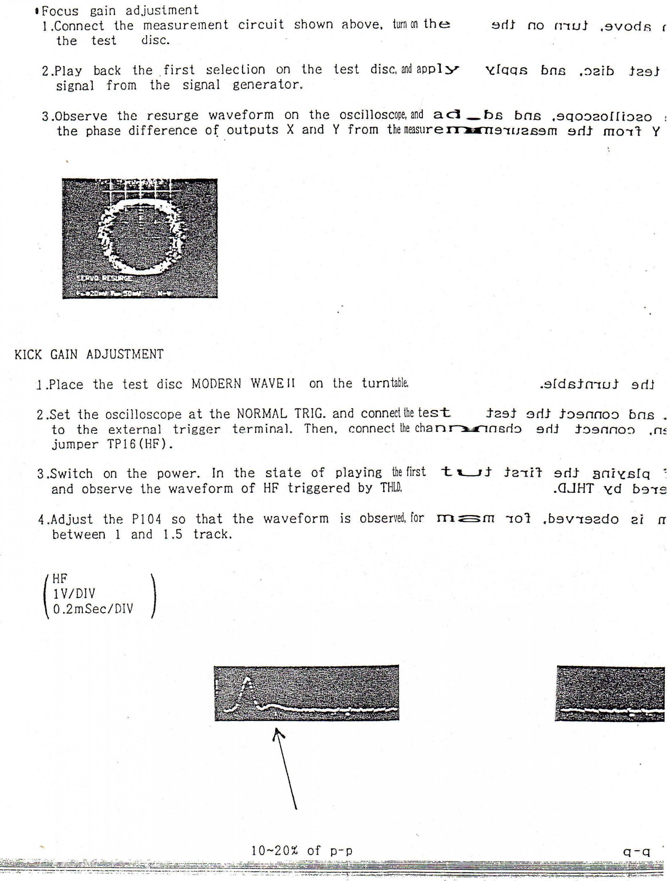

CEC Adjustment Procedures
Mainboard adjustment for CEC TL5100, TL51 an TL1X
Oo thanks a lot a big thanks .
regards Zoran

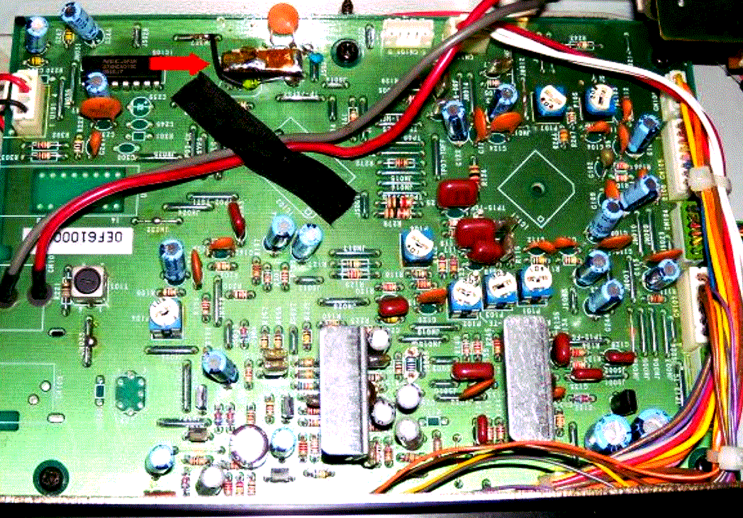

I will have to update this.
I know it (was) stretched, but I have asked CEC Japan (I wrote an email explaining situation) to send me service manual - and they did (within couple of hours).
Just to add more value, a person who sent me documents is Mr. Ken Ishiwata (yeah, I know, but, never the less, receiving an email from Ken Ishiwata...).
Anyway, a huge bonus and thanks to CEC Japan for providin technical support.

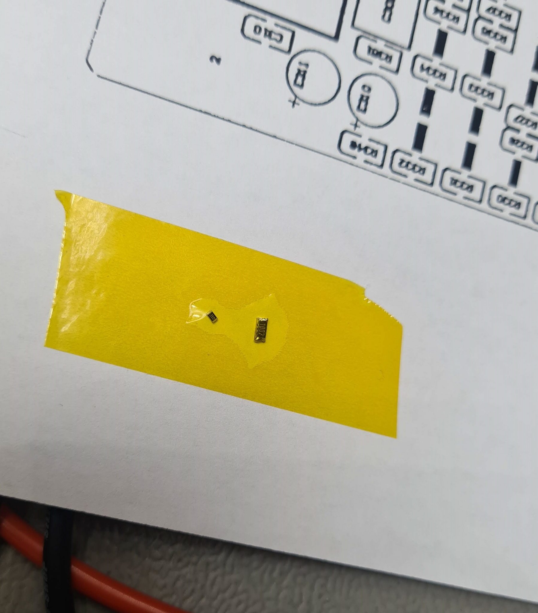

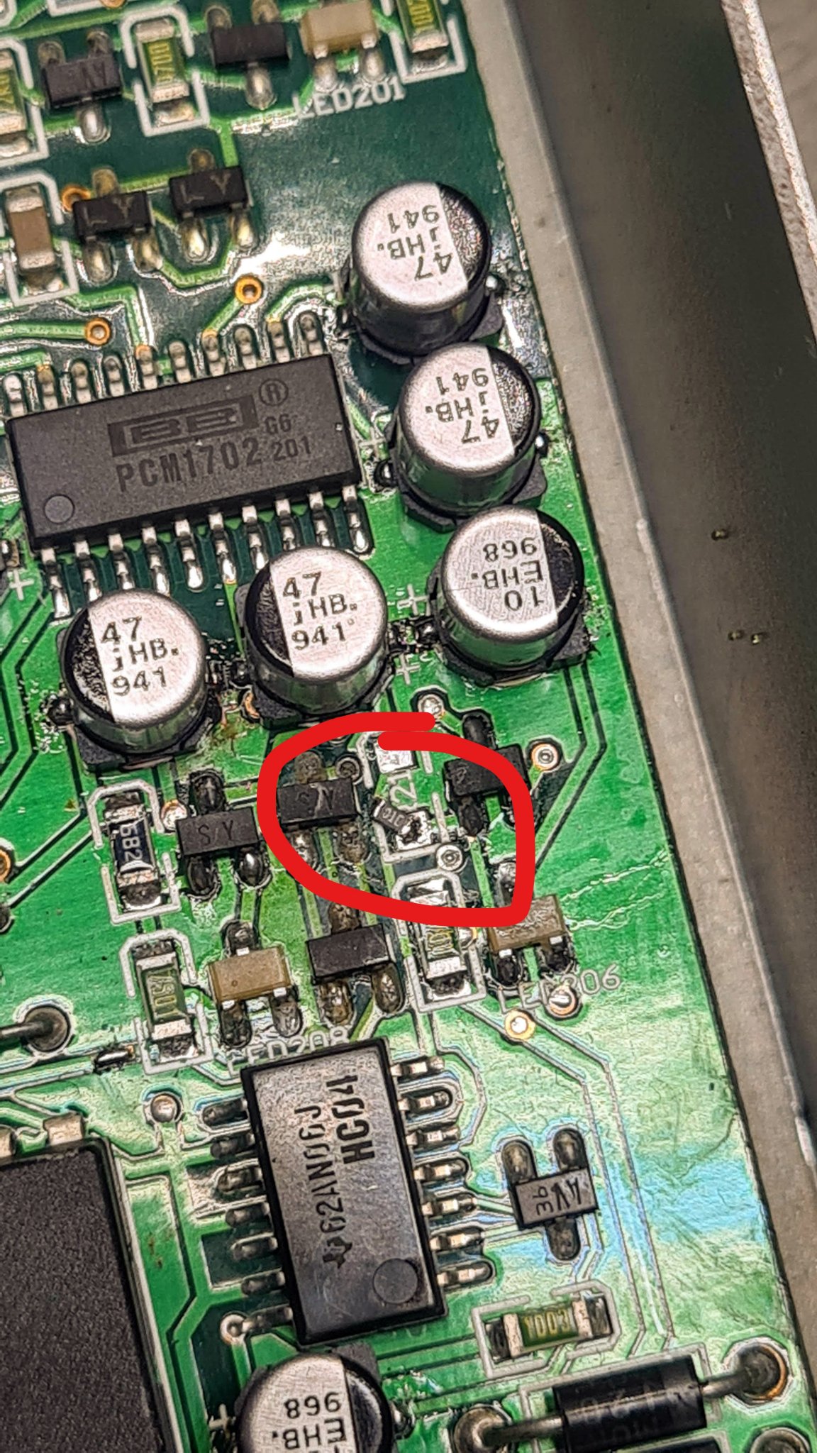

However, service manual is an old scan, and exactly page (25) that I need was really bad, but it gave me clue how things are arranged, and -5V rail was out. With little trial and error, bit of soldering and desoldering (NOT by me), fault was in 10k SMD resistor. We had no such on the shelf, but SMD that was a lot (A LOT) smaller than original, so it went, and CD works again 🙂.
On attached photos there is comparison of new and old "part" and new one positioned on board.
BR,
T.
