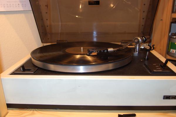

I just picked one up at a thrift shop. It spins like a charm. Little information is available on the web. I guess this was a little bit more sophisticated model when it was at sale. CEC today is making those belt drive cd transports.
The arm is apparently loosely based on the SME designs. I like the headshell. I imagine it fights resonances reasonably well and installation of a system is really straightforward with it. The turntable has no stop mechanism. The platter is aluminium that really rings and thus needs a rubber mat. Speed switching is via a lever that guides the belt down the pulley. Noticable is the anti-skating solution that applies more force towards the middle of the disc.
I like it better than my former Dual CS503-2. My system likes the medium mass arm better than the light weight ones.

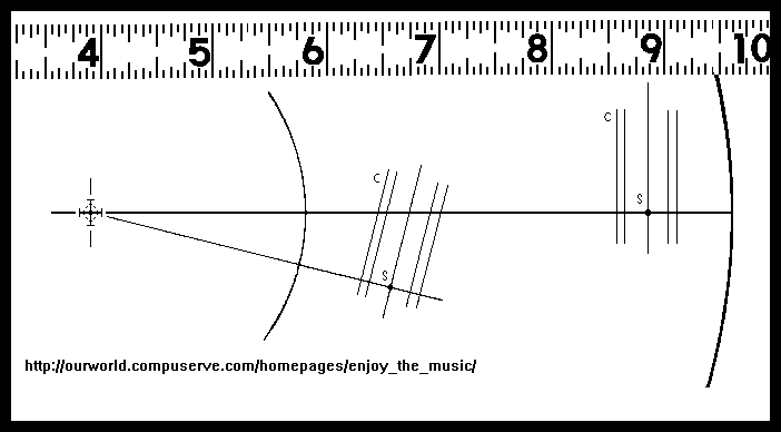

Take it into Sound Hounds and have them align the cartridge… the CEC arms (most Japanese turntables at one time were built by CEC) had a wonly alignment … or find a good, free alignment protrator and do it yourself.
dave
dave
No need for Don and the Sound Hound crew for this table - it's working perfectly.
Thanks for those protractors. I've been using the Stoopit ones over at vinylengine, and they have been working fine.
