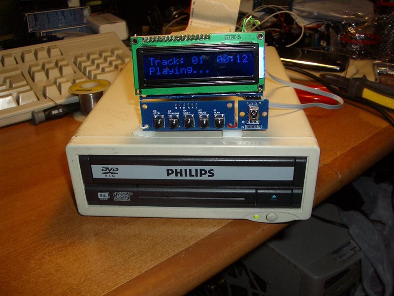

OK, here's another one that doesn't work.
I just picked up a Sony AW-G540A CVD/CD Rewritable laptop drive. Same problem. Plug it in, turn it on, and the disk starts to play and the >> and << buttons work, but if I hit the >/" button, the display stops functioning and the display stays the same even if the disk is changed.
Huang, anyone...any thoughts or suggestions?
--Buckapound
Sorry Buckapound!
Don't match...Change another CDROM.
Regards
Huang
Well, I have the Teac coming. Maybe it will work.
I did just try hooking up the controller that has not been working with the laptop drives to a full-size Pioneer DVD drive, and it works perfectly. So it's definitely something about many of those small drives that is causing your software to crash and lock up.
I'll report when I get the Teac and maybe I will have better luck. These things are pretty cheap but at this point I don't know how many I will have to buy before I find one that works. Not how one would like to proceed with a project!
--Buckapound.
Teac CD-224E laptop drive doesn't work either.
Drive spins up, but controller display just stays on "Checking IDE." Adapter board has pins soldered into master drive configuration and other drives I've tried were at least recognized.
Suggestions? I'm beginning to think this controller is just not going to work with laptop drives.
--Buckapound

At last, I can report some success with a laptop drive, a Samsung/Toshiba TS-L462, after striking out with Teac, Sony and Plextor drives.
This one seems to work fine and is playing music. Looking through this thread, the only other success was with a Samsung drive, so I guess that is the direction until we have some other data points.
Project un-stalled!
--Buckapound

... with Philips all os ok! 😀
