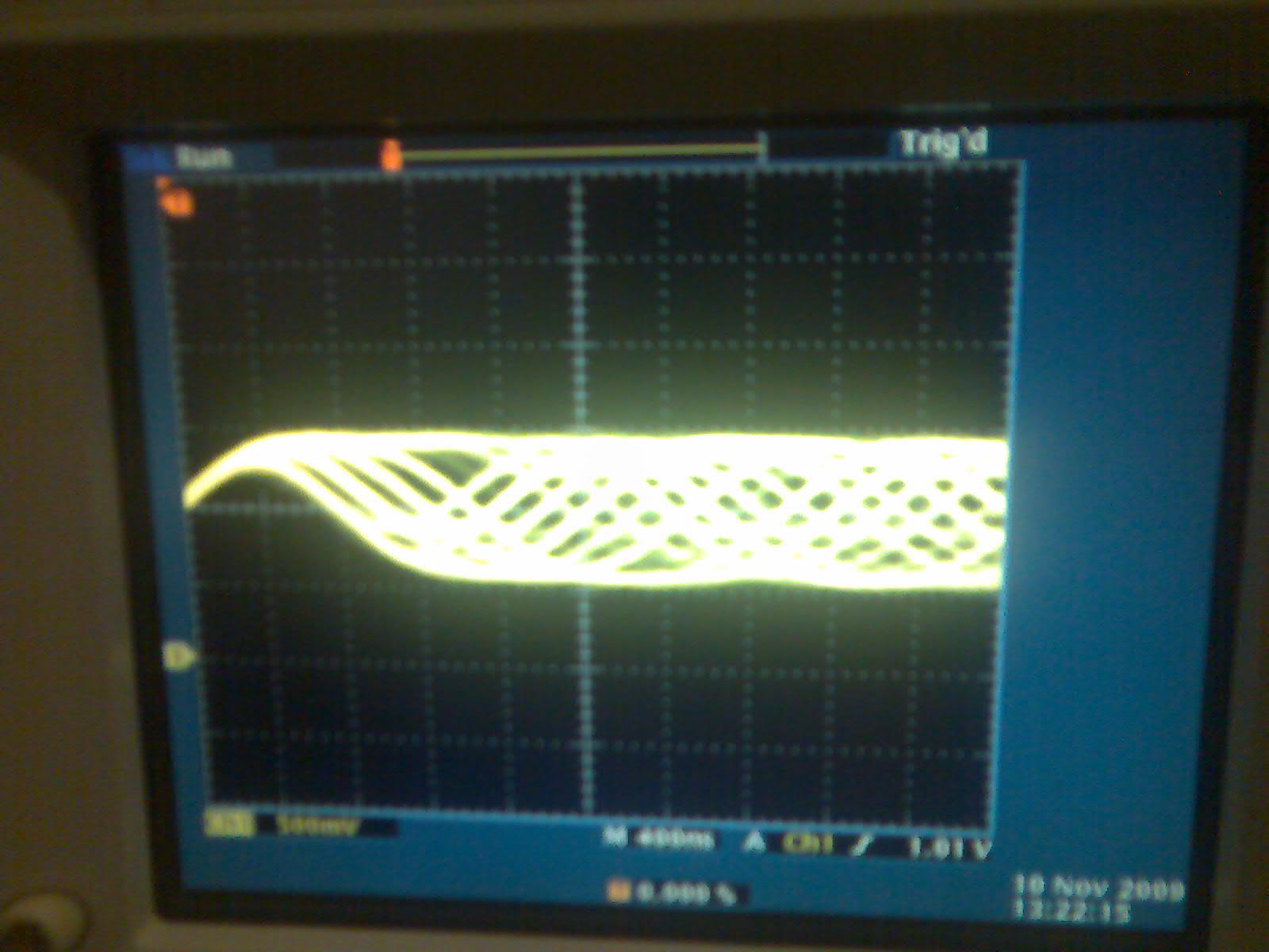

Ok, I've checked some TP and levels seems to be ok. The RF signature is in the pictures. I don't know if it's a good signal or not, is the first time i troubleshoot a cd player.
Is the RF signal of good quality? Service manual mentions 1.2Vpp (+0.2 -0.4).
The signal I get is 0.8Vpp and has an offset vs gnd of 0.5V.
According to the service manual the Vpp is fine, but I'm not sure about the offset (it's not mentioned).
Any advice?

Hi jurijvi,
It is possible the amplitude is a little low.
1.2 Volts peak to peak is typical for Sony (and many other players), you say it is nearer 0.8, and your pictures show around 1 volt if you are on 0.5 volts per division.
So you have to be sure on that... I take it you are on the correct test point etc.
As to the "quality" of the signal... the "diamond" shape at the center has to be clear and well defined with minimal jitter which will make it look "blurred".
There should be minimal "bounce" in the signal too... if it rises and falls that's a sign the disc isn't sat true on the platter.
The DC offset is normal.
I would look again at the amplitudes.
What is the pickup type in this player ? Most KSS series pickups have the laser current marked as the last three digits of the pickup serial number so 45213392475 would mean 47.5 ma current. There is usually a low value resistor on the laser drive circuit on the PCB that you can measure the volt drop across and calculate the current. If it's high by 10% or more that is a sign the laser has deteriorated.
Low amplitude can be caused by internal contamination of the optics too... particularly if it's from a smoky atmosphere.
If you can measure the "tracking" error signal somewhere while it's playing ( the DC signal across the tracking coils on the pickup) that may give a clue as to whether it's mechanical or not. If the voltage suddenly starts to rise that means the lens is moving to correct a positional error and that the sled has stuck. Use the scope on DC to measure.

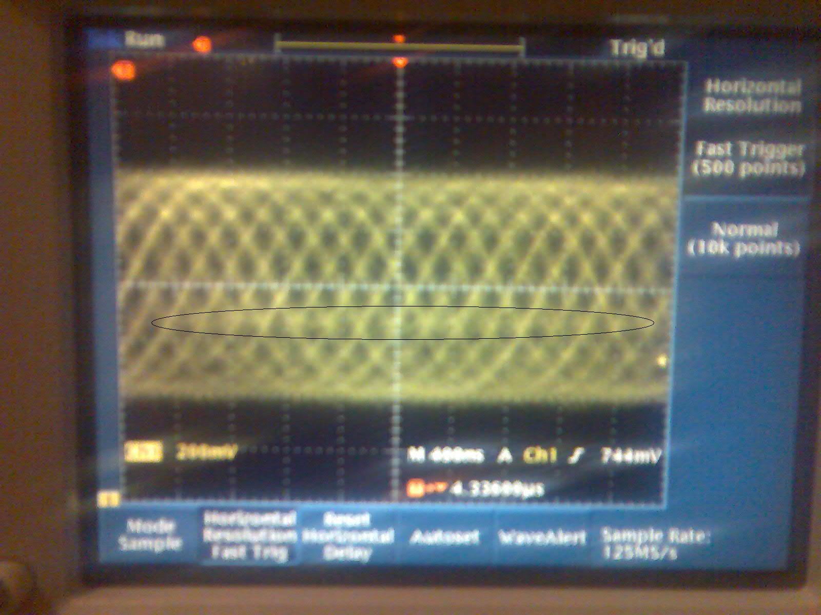

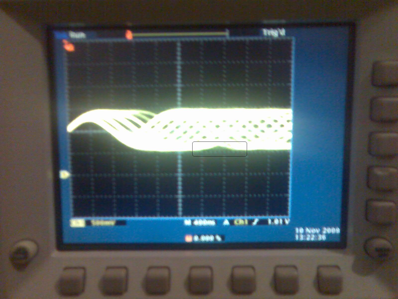

thanks for the reply. I've taken a clearer snapshot of the RF (the TP is clearly marked on the pcb and the service manual).
The amplitude of the signal is clearer. I confirm it's around 800 to 900mVpp. I've sharpened the capture and the diamond looks fine, however I've highlighted a part where the signal is not that clear. I believe there are fluctuations in amplitude.
In the previous snapshots I've also highlighted a hole in the signature.
From what I can see while probing the signal, the waveform is not “that” stable.
Just to recall, the skipping occurs randomly, and not always.

Hi jurijvi
If it is a KSS240 as George says then these are troublesome... I think it was something to do with the suspension mechanism of the lens. Used to change a lot of these years ago in music centres etc.
The "hole" in the RF may be a "local" disc defect and is just showing a lack of reflected signal. Time wise it's microscopic and concealed by the error correction.
It is all pointing to the pickup as the problem at the moment.
