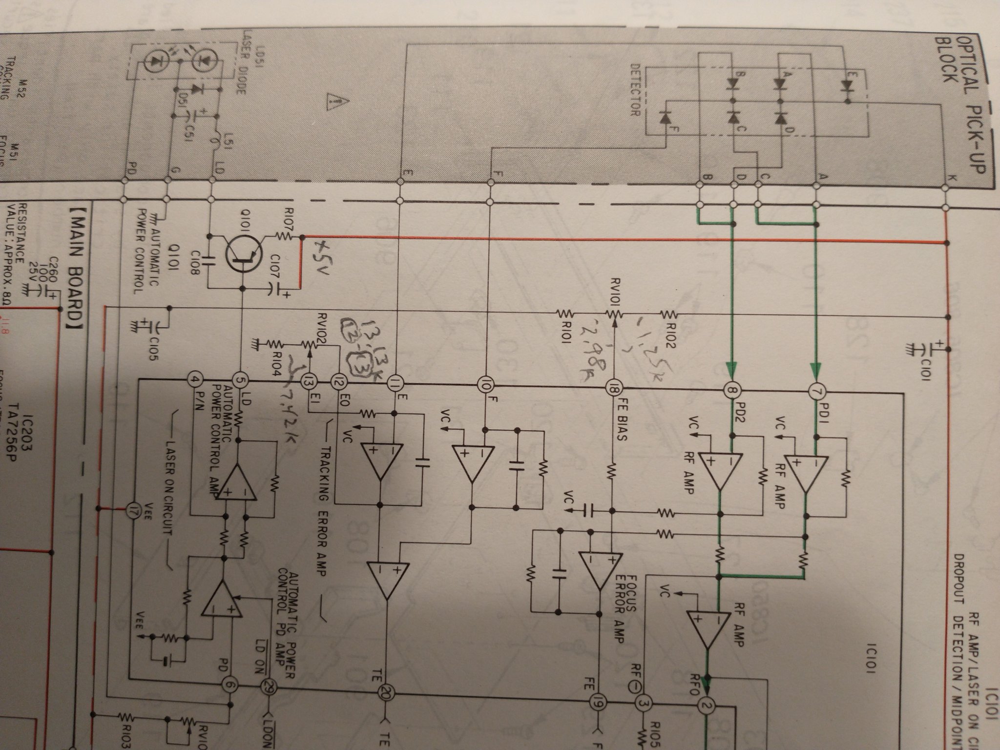

I'm trying to fix my loved Sony cdp-605es CD player and ran into problems. I have the service manual and have swapped out the laser. The player spins but won't read the TOC. The manual does not cover the focus error amp bias nor tracking error amp bias adjustment. These are two trim pots on the RF board (the 3rd is LD power which I set correctly).
Anybody have ideas on how to adjust these two? I tried the tracking error and gain adjustments on the main board per the manual but it didn't make much difference. I recorded the resistance of the error amp bias pots but wanted to know if there was any info on setting these before random adjustment.

Hi pedrickj,
I haven't taken the time to look up the manual.
If your unit uses a KSS-210A / KSS-150A, did you remove the short on the head?
If it uses a KSS-240A, the replacement head could be bad. I've seen many of those. If the head was cheap, do not count on it!
If you bought a "substitute head", well good luck with that.
The player will work with the trimmer pots set to the original positions unless it is a really crappy head. So adjustments are NEVER TOUCHED during troubleshooting. Yet everyone always messes with the alignment first because they don't know any better. So, put each control to it's original position exactly. E-F Balance is very sensitive to it's alignment position.

Since the juke box worked before there was to grounding solder blob to remove. I do have most of the test equipment needed - an analog 2 ch oscope, old heathkit frequency counter, antiststic workbench etc. I am a retired aerospace eng. so I should have the needed skills to attempt this transplant. I worked through the service manual and extrapolated to set the LD current based on the service manual of both these players. Neither one addresses the two pots on the RF board which set the op amp biases. Seems weird as there are access holes to adjust these two (plus LD power) while the unit is operating. The manual states how to adjust the focus/tracking gain which are separate adjustments on the main board. Seems like op amp error bias needs to set before the gain though.
The reason I suspect that those two error biases need adjusting is that the LD power written on the two optical blocks differed by quite a bit. The old one was supposed to be 63 mA and the "new" one was rated at 51 mA. I was thinking 23% difference might negate the "should generally be replaceable without pot adjust" advice I actually did see in some other thread here.

Hi pedrickj,
Perfect! Thank you.
Okay, the two numbers on the head are laser currents for a specified output level. This is to be measured and never, ever adjusted. You are allowed a 10% increase before the head is officially condemned as unusable. Those differences are expected. The lower current indicates a more efficient laser diode (and I prefer those). So install the head with the lowest percentage increase. That will be the better head of the two. If you don't have a laser power meter you cannot confirm output levels, but you can be pretty confident it's okay if Iop is within range.
There should be three offsets, some later machines use a servo (never as good as a careful setting). Most of what you need to do can be done by looking at the RF pattern (Eye pattern). Set your scope for 0.5 usec / div and 0.5 V/div, maybe 0.2 V/div, you may have to browse to find the RF test point if it isn't labeled. It is at the output of the RF amp (I to V converter). Tracking offset is typically setting 0 VDC at the tracking coil drive output, focus offset is similar at the focus coil drive output. E-F balance is critical, this adjustment can make the CD player not even read the TOC (Table of Contents). Find the slight dent in the rotation of that pot for a starting point. It should read at that point. Then carefully and slightly adjust that control for the best eye pattern. What I do is look at the RF envelop recovery from a scratch and adjust so the beam is on track. I use "Pierre Verany" disc #2 for this. It is a precise adjustment. Other methods involve turning off the tracking servo and adjusting the effective DC level of the resulting search waveform for zero, but it isn't nearly as close.
Tracking and focus gain adjustments are simply setting the gain at a point where the servo output has the lowest low frequency component (gain too low) and lowest HF component (Gain too high). Your scope is set to about 500msec on the corresponding servo output to the coil. This procedure differs from most manuals, but it works the best.
I have not had a chance to look at your manual, so some of the adjustments I referenced may not exist. If that is the case the adjustment is servo controlled. Don't worry about it.
Critical adjustment point, and this is mechanical. Turntable (disc table) height. This is another critical adjustment and needs to be very close to bang-on. Your manual should hopefully list this value, if not measure the jukebox unit. Tables can slip downwards on the shaft and cause bg tracking problems.

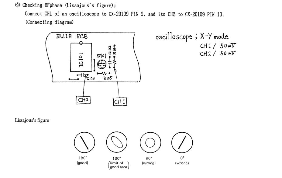

Is the EFM pattern you refer to the "EF Phase Lissajous's figure shown in the attached (from the cdk-006 manual)? The circuitry differs in the 605ES so I will have to try and figure out the test points if that is correct.

Hi pedrickj,
1.25 Vp-p sounds like the RF level is fine on the face of it. Most CD players operate around the 1.2 Vp-p level for Sony heads. Of course some manufacturers differ but the majority are in this range. That and the stopped pattern is clean enough by the looks of things.
The servo adapter varies by manufacturer and even model. I have several of these test adapters, some are simply filters. What I noticed is that the gain settings vary with the CD, and also the filters are not required unless you have to prove the setup to factory procedure. The other thing that was clear was that the adjustment procedures tend to set the gain at that point where both LF and HF noise is at a minimum. The gain setting method I gave you is valid and avoids wasted time and equipment to arrive at a more than acceptable setting.
E-F balance is basically setting the E and F diodes in the pick-up matrix so that they guide the main beam on the centre of the track. When the track is interrupted, the beam should naturally pick it up again on target. The E and F beams ride on either side of the track with the A,B, C and D diodes falling in the centre. The E and F diodes are used to detect the track edges, and their error signal goes to the tracking servo. The main beam hits the A through D diodes and that is used for focus and actual data, in the form of an RF signal. It isn't digital yet.
I have never, ever heard of a Lissajous figure (display) being used to balance the E and F diode outputs. Normally they simply kill the tracking servo gain and centre the resulting hunt waveform. My method agrees with the normal procedure, and it is more precise plus easier to perform. Faster too. Something else to consider, it wouldn't be the first time an alignment procedure in a manual is completely wrong! Your common sense here will save your skin.

So you have a good eye pattern, stable. That means all servos are locked. Good. The EFM signal should go into the DSP where information is then sent to the CPU, and the DAC section (probably digital filter next). Look for activity from the DSP into the CPU, you may find an open connection or shorted signal. You know the CPU should be working on some level as it executes commands from the keyboard. If there is a servo controller, make sure it is running, it would (if exists) go between the DSP and CPU.
Some logic is working, that much is certain. Your problem isn't common at all.
Sorry you aren't close.
