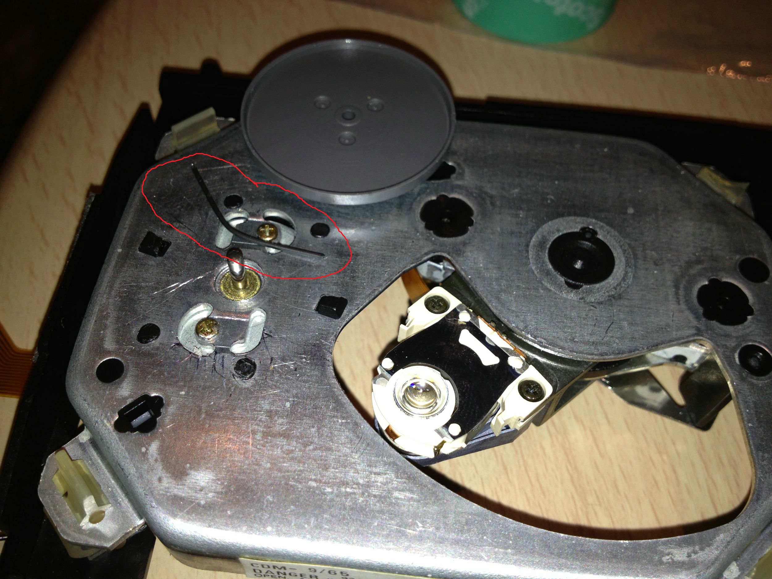

I have the same issue with my CDM 9/65 - I've replaced the gear, cleaned the laser and turned on Aura cd50. The tray is working now, but every time I put in any cd, I get an Errr on the display. The laser is ok and moves and the motor spins. One thing that wasn't mentioned here is that it makes 1 or 2 turns and then it rapidly spins in opposite direction. However if you slightly hold the cd or the clamp above, it reads and plays fine. Is it the same motor issue? 😕
I removed the plastic clamp to remove the motor and was a bit confused with metal stick (outlined with red color, pls see att). Anybody knows what it's for and how should it be assembled now?
I, too, was confused by the metal stick !!
I think it is a 'friction' device to prevent the platter from moving on the motor shaft.
After much time spent trying to replace it, I gave up.
I threw it away !!
The motor worked perfectly without it.

Can I ask how you removed the Disc Platter from the Motor Shaft?
And what is the correct height one needs to set the Platter back on the new Motor's Shaft? (I'll just measure the original but wondered if there's a printed spec'n somewhere)

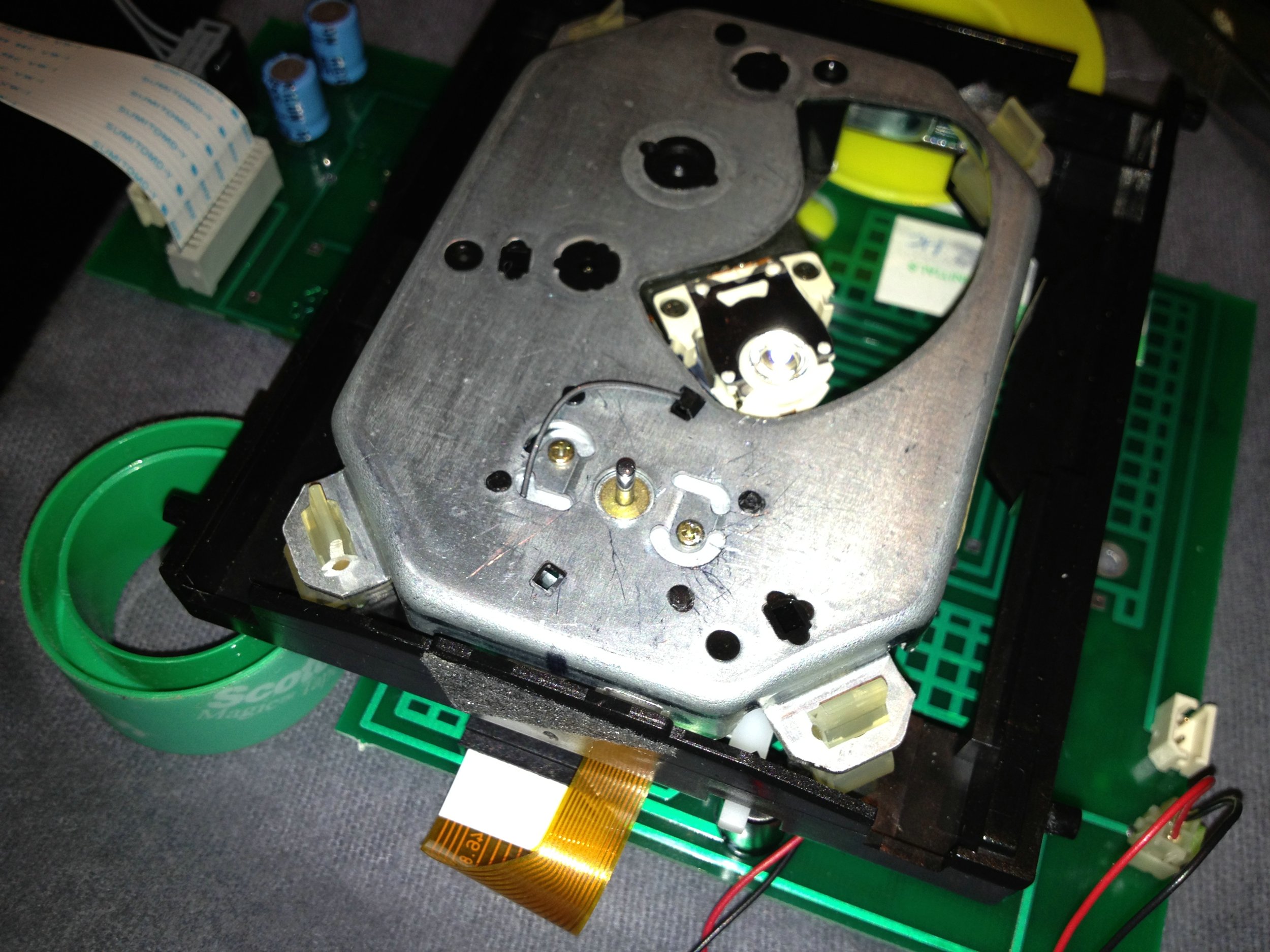

it was quite easy with two knifes attached to both sides 🙂
I didn't measure the original height as it was a hairline or so between the platter and metal mechanism.
Anyway, just have received the new motor (6mm shaft), replaced it and still experience the same issue. Disc makes one or two turns clockwise and then rapidly spins in other direction. However I'm still able to play the CD if I gently touch it, thus making some additional resistance to the motor. It's like it's spinning too fast 😕 What could be cause, any ideas?
I even managed to place the metal stick back, but it didn't give any results as well.
The old pioneers used to require a platter height adjustment, which in laymans terms involved moving the platter drive up and down the motor pulley.
If the Arcam is similar you could just try moving the platter drive along the motor shaft a tiny bit.
