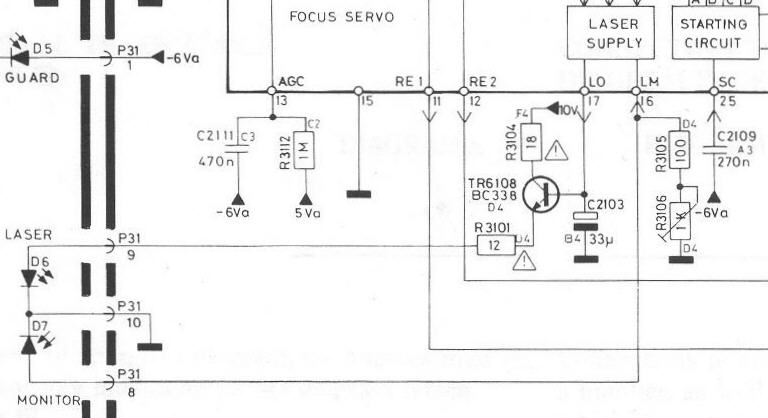

Hello.
I have an old cd philips 460 with inside a Cm2/10.
The player don't read CDR.
I think this could be a problem of Laser 'cause all old cdplayer reads CDR.
So, i think i need to change the Laser's caps, or make some adjustment of laser's pot in cdm2.
This cap should be C2103.
My Problem is that I'm not able to remove CDm2 from the inside of cdp, so i need some instruction, please.
Have you some suggestion?
RR

You need to remove one screw in the middle back and 3 screws of the front panel. Then you little swing the front panel and the mechanism can be taken out.
However, be prepared to change all electrolytics in the player. It is also necessary to watch the voltage on the aforementioned resistor. One of my players went crazy when I little pushed the trimpot -- it had too high laser power regardless of the trim position. Only complete change of caps helped.

Yes, that screw with spring. I have no manual of cdm2-style drawer. Possibly doesn't exist? -- it is self-explanatory once you have it out of player. If you think ergonomical, yes, the adjustment is mystery for me as well. I drilled
hole in the bottom and soldered wires to that resistor in order to adjust having the mechanism in player. I'm interested in the manual of cdm2, please e-mail to ptlo(tht at sign)centrum.cz

Measurement location
I'm sorry to bother you with the CDM2 once again. I would like to check the laser voltage on my CDM2 board, but I can't find the test point. There are certainly different versions of this board (noticed this on a CD150 and a CD150mk2); which explains why I'me completely lost. I would be glad to get some advices. But please note that I don't have the manual, then components numbers and chip resistors values can't be used easily. If it can help, this morning, I've made some large photos of the servo PCB. So, I could send them to anyone who can show me (on these photos) where I should measure the voltage. Thank you in advance,
Henri
PS: my version uses the TDA5708P, TDA 5709P and MAB8441P T012 chips
