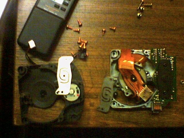

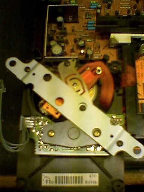

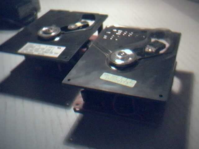

Yes this is logical but since TDA5708 seems to completely unavailable I decided not to spend more time messing with this.
I decided to try another method, I borrowed 2 CD2s from a friend of mine. One of them has CDM4/11 (lucky sod!) which tracks anything and everything - just like my 3 Arcams with CDM4/X. The other has CDM2/10 which behaves in exactly the same manner as mine.
Jean-Paul knows!!!! He said many times to avoid CDM2 and buy CDM4!!!
I have seen CDM 4/11 available at UK£95 +VAT 😱
CDM4/31 is more like £43 + VAT.
The only difference I can see is the 6 way connector for the tray drive, which is easily sorted.
Any reason why CDM4/31 would not fit/work?
Dave
A 4/31 should (!) be a drop-in for a 2/29. I posted on this before, got a 2/29 in a cd650 and a spare 4/31 for it but never tried.
My 650 plays anything, no problems at all. Both transports come with the TDA's on a pcb underneith, but without the servo microcontroller (which is on the main pcb). The manual i have is from a third type of cdm2, now with microcontroller on the attached pcb.
The 2/29 has a hall motor, the 4/31 doesnt ('toy' motor) iirc (don't have them around). So a 4/31 is useless for you, i think. Since the electronics are on the attached pcb, it does not matter that the motor is a different type. The 7210 doesn't mind😉
A 4/11 is only the transport, no pcb. Got one of those for 5 euro, player still attached😉 Also a hall motor btw.
Dont know cd2/10, but i guess now it is like the 4/11, no pcb and hall motor. Which leads to the conclusion that if you swap only the transport and not the electronics for 4/11, and it works, that my previous thoughts are wrong
So best solution; find yourself a player with 4/11. Like i said, 5 euro for an aristona. And you get the TDA's for free😀 😀 😀

Was a bit confused and re-read all for a moment. Seems all the versions mentioned here are with pcb; 2/10 (since it is in a 650) and 4/11 (since you mentioned pcb in the first posts (oops, overlooked) and 'my' 2/29 and 4/31 (see the pic).
Since the 4/11 from the 5euro player is without, i guess the pcb has nothing to do with the type of cdm mounted above. Next question is then if all pcb's with TDA chips are equal for all of the above transports. Probably are a bit different (hall motor or not), but not on the connections towards the rest of the electronics in the player.
So maybe you can swap your 2/10 for all types. Probably possible for easy servicing (except for the one in my servicemanual; servo processor is on-board and you dont need two in a player😉
Have a look here:
http://www.diyaudio.com/forums/showthread.php?threadid=12389&perpage=10&highlight=&pagenumber=1
Seems the 4/31 is indeed with toy motor, as i mentioned in that thread. But for 7 euro's...😀
I have been playing with EAC to try to make a CDR that is better than the original CD. I finally got to the point where the copy is extremely close (much better than using Windows Mediaplayer).
After straining my eardrums to detect these tiny differences I decided to try the CDM2 CD2 versus the CDM4 version (using CD). The difference is not subtle, the CDM2 version has noticeably better resolution of fine detail and better dynamics, timing etc.
There may be other differences between these two players that account for the improved SQ. However all my other CDPs are similar in terms of resolution and detail if not in tonal balance- the CDM2 version is just fundamentally better (all subjective of course).
Maybe "toy" motors are something to be concerned about!
So my motivation to improve the CDM2 tracking ability is renewed.
Dave
Dave
It sure has!
I had a set up where the same cd player origianlly fited with CDM 4 was fited with CDM1/MKII (almost the same as CDM 2)
It was possible becouse the player wa s designed to take both transports,it's higher brother was equipped with CDM 1/MKII and the main PCB was the same.
So swaping only CD transport in the same player (from CDM4 to CDM1/MKII) revealed the same diffranaces as you describe.
