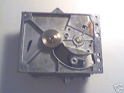

Philips CD 100-104 CDM0 14 b TDA 1540
Philips CD101 CDM1 14b 1540
Philips CD 200,202,204 CDM0 14b 1540
Philps CD300, 303 CDM0 14b 1540
Philips CD 304 CDM1 14b 1540
Philips CD 304 MKII CDM1 16b digital out TDA 1541
Philips CD 960 CDM1 16 b digital out TDA 1541
Marantz 73 CDM0 14b
Marantz cd 74,84 CDM1 14b
Marantz 94 CDM1 16b digital out TDA 1541
CDM 0 steel, motor DC
CDM1 Aluminium, motor Halla
CDM1 Photo

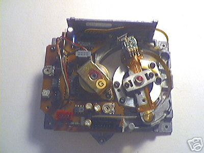

What are the pots for in CDM1 ?
I have a CD104 which was not working and unfortunately before I realized it was a problem with the upper board, I screwed the pots.
Which one is laser power ?
Bernhard said:What are the pots for in CDM1 ?
Ward gave me an exelent answer on this question some time ago. Depending on version, the value of the pot is different. I have seen 1K and 10K (CDM-1) and 6K8 (CDM-0). The outline of the board I have drawn is different from CDM-1.
Be carefull not to turn the pot too high.
http://www.diyaudio.com/forums/showthread.php?threadid=21005&highlight=
