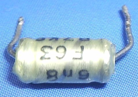

What are these silver-coloured caps? Electrolytics?
Not electrolytic. They are high precision 1% types, polyester or polystyrene I think. They are used in the servo feedback loops - where they make the player behave totally erratically, and in the de-emphasis network where they make an intermittent roaring sound.
I look in phillips cd 880 manual & the value of these caps is 3.6nf @ 160volts. They are 1% polystyrene caps. I looked for a source for these & can't find anywhere. Everyone lists in pf which would equate to 3600pf. The closest i see is 3900pf. Do you know a source for these? Would 2 % polypropolene work if 1% polystyrene can't be found? Thanks Domald

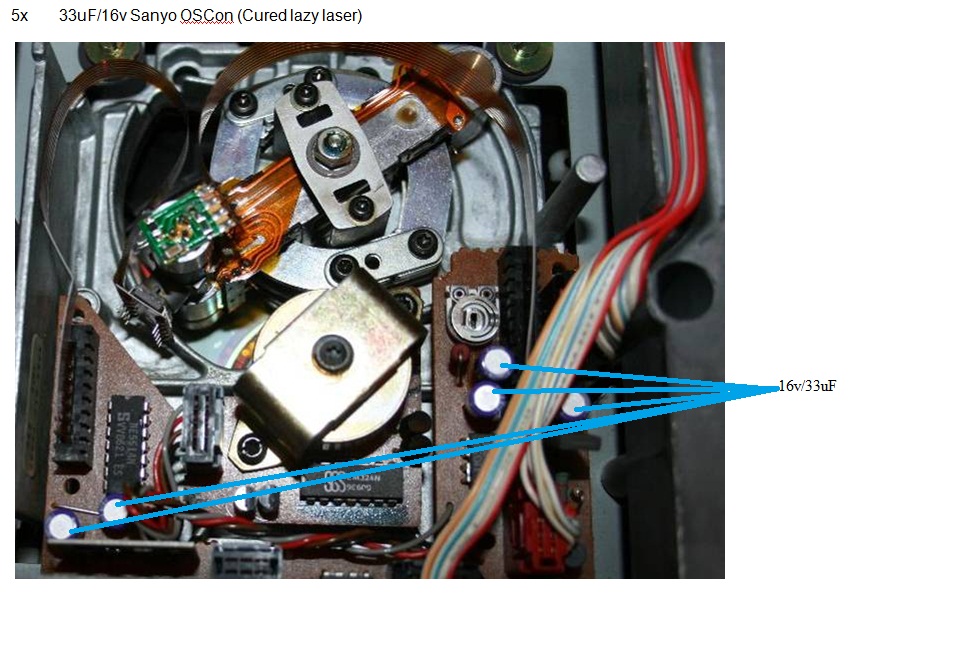

If its similar to the MKI version, there are 5 16v/33uF little blue radial elcos.
Mine was not reading disks, i replaced these 5 elco's with Sanyo Os-Con of the same value and the deck's as good as new now. This is a fairly well known problem given the age of the transport.
Also, I beleive (as stated in a previous post) that the laser can be taken from a cdm4. You will need the SM and a scope to set it up properly tho'. Also, the lense in the original mech is glass and the 4/19 used a plastic one.
I've don't think outright laser failiure is very common on these decks.
Pic showing the caps on my transport
I could never find them anywhere either! I used other standard value types of 2% or 5% tolerance in parallel or series combinations, that I measured first to find a very close match.
Eg., 3600pf you could make up from 3 x 1200pf in series, and 1200p is an easier value to find. And then if one of your 1200p is a bit on the high side, compensate by picking the others on the low side, so the total come to a good match.
