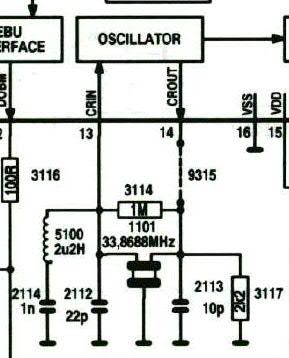

I've been modding a marantz cd 48, marantz version of philips 751, ealier version of 753.
I'd done some cap replacements etc. and it was sounding good so I decided to fit a new clock which is where it all went wrong. The cd doesn't spin at all when it powers up and screen shows no disc so I assume the clock signal isn't being picked up?
The standard clock circuit is in the picture, I removed all the bits
3114
5100
1101
2112
2113
2114
3117
and connected the clock to the CRIN pin 13. Did I remove too much?
I'm using a flea with a tent xo. Flea seems to be producing 5v correctly and I can trace continuity from output to CRIN, don't have an oscilloscope to check the clock output though (but it's a new xo).
Anyone got any suggestions?
Pete

You can check the DC voltage at the clock output, that should be about 2.5V. Also, check if you have connected the clock to the original crystal input (rather than the output).
best
Guido

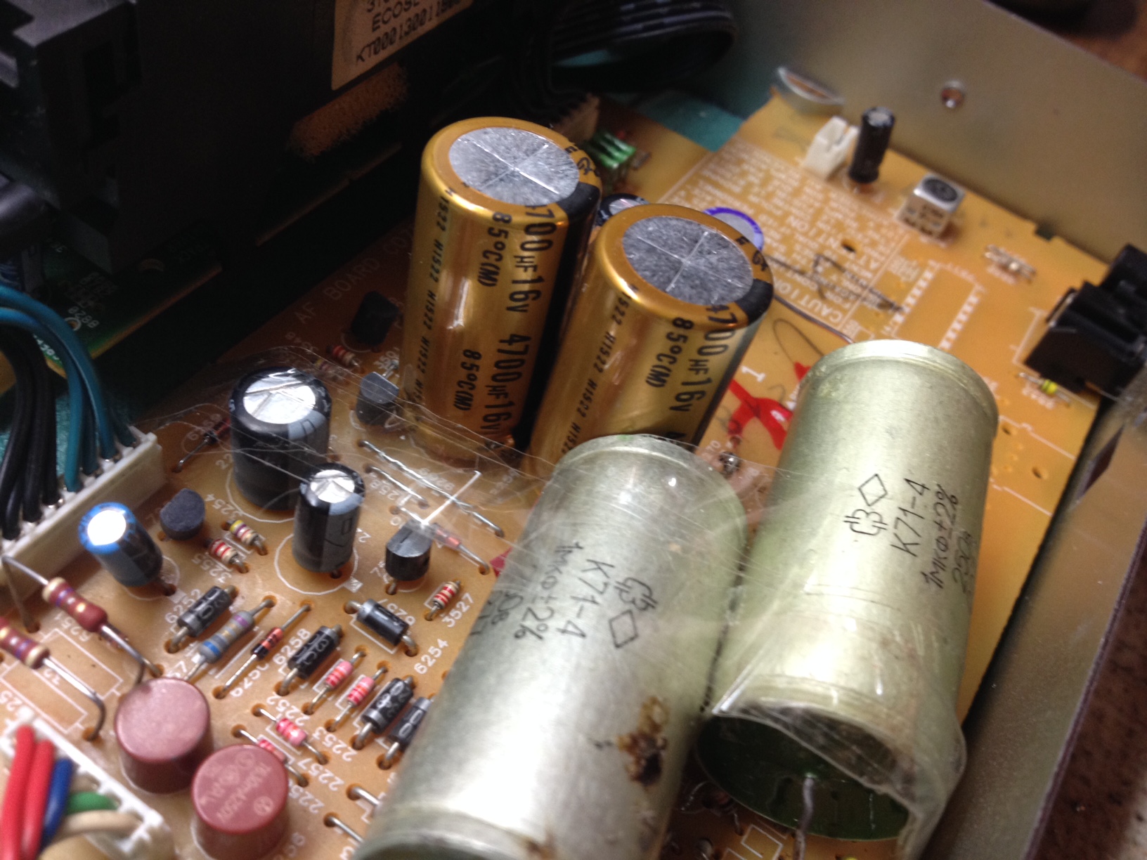

The seller helped me with what to do to mine.
New regulator NJM7805, Opamp AD8599, silmicII and KW ( was worried KG wouldve been too large). Vishay Dale 100Kohm resistors that I had to change, i used CMF55. Left over Jantzen Superior Z caps from a pair of speakers I sold, and my old Eichmann RCA
Looks great! My interior is very modest.
What are listening impressions? Now vs before.
Thanks for posting this.
Alexandre

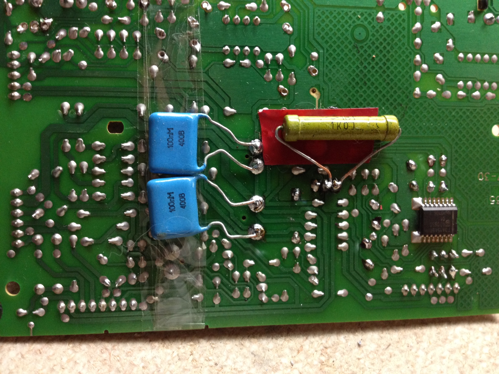

Hello Alexandre,
I see you put bypass capacitor on the regulator and main power caps, and used big mkp capacitors on the output and used two 4700uf capacitors
In stock the Philips was very good. With the mods it sounds clearer, in you hear the finer details on your test cds. Since I was using a lower capacitance capacitor on the decouping capacitors, the seller told me to put 100K resistors on the pcb - part numbers 3509 and 3510. I used 3.9uf and the 3.3 uf on the output capacitors.
Hello Alexandre,
1. The big mkp capacitors are not so big: 1 mcF only. I will go for bigger values, of course. I have smtimes only 10 kOhm ALPS to load the player, which is not sufficient for very low frequencies to pass.
With my mods I do not recognize the gear, which is good and I enjoy listening my records.
2. I see a radiator on the IC7805. Was it hot before? Mine is very hot that prompts me to smthing about it. I think I'll have a dedicated 5V 7805 regulator some where around the DAC as a hook-up wiring pattern.
Alexandre
Hello Alexandre,
I think on the output capacitor 3.3uf is about the minimum I was told. Your mods the sound has improved which is good. I enjoy cds and listening to my records also.
The radiator on the IC7805, was not hot but i added it, it was from my spare V4X amplifer radiator, so i added it. I use the 7805 - NJM7805. They say if given a radiator they can deliver over 1A current.
