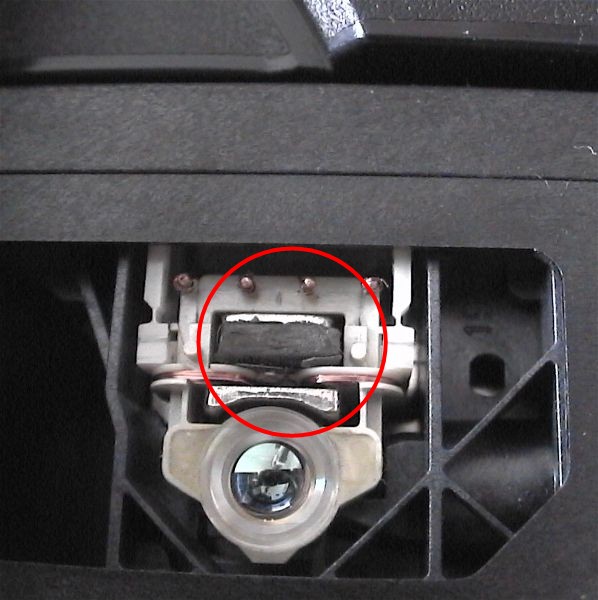

I recently purchased a Marantz CD-63mkII KI which was known to be skipping tracks. Overall it looks in excellent condition with very little dust. When I tried it, it read the album data no problem, but skipped badly when playing, especially on early tracks. It would also freeze sometimes before skipping on. I tried cleaning the lens with a disk (no change) then a cotton bud but this made it far worse, hardly playing at all. After more messing it wouldn't even recognise the disk. I then spotted a small sliver of metal on the cotton bud tip. Using the manual I found on a forum (thanx ALW) I drove the laser out to find metal missing from what I guess is some kind of disk detector next to the laser. I removed the damaged fragments and took the enclosed photo.
In service mode I can see the laser, it moves for focus but doesn't settle (should it?) and spindle and radial seem to work OK. When I open / close the draw the disk does not rotate but I hear the laser clicking under the disk a couple of times before getting Err 02 (FOCUS err). Occasionally the disk will rotate and I then get Err 10 (RADIAL Err).
What do I need to replace? What is this bit anyway and what does it do? I see one option is to replace the whole tray mechanism for about 30GBP, but would it be better just to replace the laser?

the black thing is the magnet. and you can see some fragment seems to be caught between the magnet and the right coil......
try removing it and see what happens.........

Sorted!
Thanks for the advice djQUAN. I stripped the unit down and managed to get most of the fragments out and it now works great.

Amazing. I thought the transport was dead on my 67SE. As I no longer cared if I broke this thing any more, I took it to pieces and found the magnet was kind of messed up too, just like the photo above. After a quick attempt at cleaning, it works again.... perfectly.
And to think I was quoted EUR 100 to get it repaired. Thanks guys!!!
