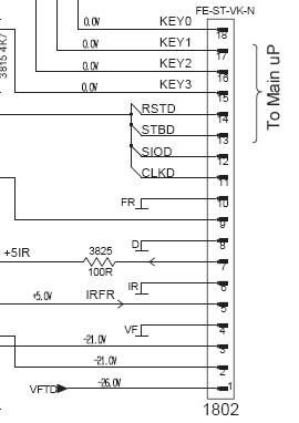

My Marantz cd6000 ose limited edition is no longer working.
Fault description:
screen does not display, no power light, none of the control buttons on the front work, remote does no work.
When powered on I can hear the transformer power up.
I have had a multimeter on the back of the front panel at the point which the "ribbon" connects. The following voltages were measured.
Top row of pins 0v 0v 5v 5v 0v 0v 0v 0v 21.7v
bottom row of pins 0v 0v 1.2v 5v 5v 5v 5v 21.7v 26.2v
Does anyone have the service manual for this model to check the values?
Has anyone experienced this problem before?
Has anyone got any ideas where to start to find the problem?

Hi.
Alongside the transformer are 2 small round devices. Fuses !
They supply the +5v and the 10v supplies.
Check them with your meter - they are a little undersized

Hi.
The voltages look OK
[ see diagram of connector]
top row is even nos.
bottom row is odd nos.
26.2 = pin 1
andy
hi.
Next, you should check the voltages on the ac supply to the front panel. this is easiest at the ends of resistors 3118, 3119
Also check the voltage at the regulator 7119
The output should be -26v
Andy
