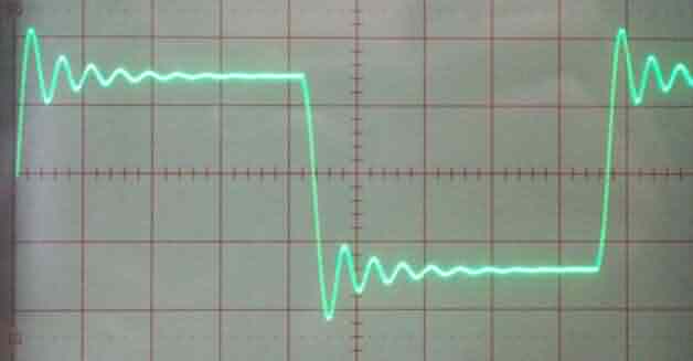

Re: Ringing
Elso, this is not true for many NON-OS players because of the sharp filters. My old Denon DCD-1000 had rather typical step response for 20 kHz, 7th order LC-filter, no pre-ringing of cource since it's an analogue filter, and than some ringing.Elso Kwak said:Hi Circlotron,
If you go to non-oversampling you will get a <B>PERFECT</B> square wave even without the slight wiggles.
I did not say this is the cause for the better sound of NON-OS though. If you use Bessel low-pass filter after the DAC the fidelity of the waveform is preserved.
Werner is absolutely correct. What looks like pre-ringing and post-ringing is, in fact, not ringing at all!
Ringing implies some response to a signal which was not part of the original signal... Often times, it's the result of overshoot error in feedback systems, or some energy trapped in a passive component and oscillating around, thus producing some little wiggle that was not part of the original signal. But what we have here is not ringing! Those ripples are are supposed to be there! They are a perfect non-bandwidth-limited representation of what was recorded on that CD!!!
The observed "ringing" (this is a really improper term to apply here) is actually exactly what was recorded on that CD, but the numeric sample values don't show it, because the data on the CD is band-limited to 20kHz. However, when we reconstruct these samples as an analogue waveform, the digital filter tries to reconstruct a perfect squarewave, since that's what the samples describe. The only problem is, the sampled data bandwidth was limited to 20kHz, and so the information recorded on the disc does not contain the square wave harmonics above 20kHz.
As anyone with an education in signal theory knows, a squarewave contains harmonics to infinite frequency. If we chop off the harmonics above 20kHz, presto... you get a squarewave with this funny-looking pre and post- "ringing". Lop off all the harmonics, then yes, you'll be left with nothing but a sine wave. But, Pedja, we're not losing all of the harmonics, just those above 20kHz.
For a more interesting trial, record something like a 11.025 kHz squarewave on a CD, and see what you get out the analog side. Better yet, record an 18kHz squarewave / sinewave (doesn't matter) and play that back. Then you'll really see the difference between oversampling and non-oversampling DACs! (take note, Elso!)
So, take a perfect squarewave with sharp corners and listen to it. Since you can't hear the harmonics above 20kHz, you may as well get rid of them. If this is done with mathematical perfection, you'll get a squarewave that looks funny with the pre- and post-ripples, but it will still contain exactly the same audible components. Identically. Precisely. No phase shift, no amplitude errors, nothing. Play that back through a non-OS DAC, and the subsequent analogue filter, and you will have all sorts of amplitude and phase errors, even with the touted Bessel alignment... although what you see on a scope screen may look a little prettier. Just ignore it, it's only psychology - human perception of what's "right" or "wrong", and sorry to tell you folks, but this stuff isn't intuitive. In this instance, your instincts are wrong.

Ringing
Hi HifiZen,
I was talking about a 1kHz squarewave. Forgot to mention that. Right in the middle of the audio band. Also I am not saying that the sound of NON-OS is better <B>because</B> of the lack of ringing.
I simply made a DAC in my Sony with the standard CXD1244 digital filter and AD1865, and I made a NON-OS DAC in my Sony omitting the digital filter. The difference in sound was really <B><I>jawdropping! </B></I> This has nothing to do with instincts. Kusunoki offered a explanation for the difference in sound. I am not a expert in digital filters.
I do not agree with you about a bandwith limited squarewave having ripples. It depends HOW you bandwith limit it in other words it depends on the lowpass filter method. Again my third order Bessel lowpassfilter with the crossoverpoint at 10kHz leaves the 1kHz squarewave as it is; perfect.

FACT: Digital filters are no more responsible for the "misnomer" pre-ringing, than analog filters are. Sorry, but that is not disputable, that is the truth.
FACT: "Pre-Ringing/Ringing" is just a result of a bandwidth limited representation of a square wave. However, if you do the filtering with a linear phase filter, and I don't care if that is in the analog or digital domain, you will find that the ringing magically (okay mathematically!), goes away.
This is just simple signal processing theory. What seems to have been confused on this thread (and many others), is the difference between "what" is being implemented, and "how" it is being implemented.
If you make a non-oversampled DAC and put on a 3rd order butterworth, chebychev, elliptic, or any other non-linear phase analog filter, you will get ringing, even though no digital processing has occured. Only with a linear phase bessel will you not get ringing.
In the digital domain, if you oversample with a non-linear phase filter, and then follow it with any analog filter, you will have ringing.
If in the digital domain, if you oversample with a linear phase digital filter, either Bessel IIR, or an FIR filter, and follow it with a linear phase analog filter, then you will not have ringing.
So, for all those oversampling nay-sayers, may I suggest that you implement a linear phase oversampling digital filter (probably with a DSP), and then follow that with a non-oversampling DAC, and follow that with a bessel analog filter. You will get all the benefits on the non-oversampling DAC that you wanted, but will also get the benefits of oversampling in being able to keep the wide bandwith and also eliminate aliasing.

Problem is that the highest frequency squarewave that 44.1kHz sampling format can register is 14.7kHz. Not enough samples for more.
“So the 1KHz square wave will record as a bandwidth limited square wave and the amount of ringing will be dependant on the filter type.”
This is something I can easily agree with.
“You can of course build a DAC without an aliasing filter on the output, and while there may not be audible distortion at the output of the DAC, if any thing beyond the DAC generates IM distortion, then you will end up with system distortion.”
There are a few ways to fight against this, directly (leaving slight and/or prudent analog filtering) or methodically (use of NFB and/or tube amps).
“pedja, the issue I have with the article you posted is that there is no description of the anti-aliasing and reconstruction filters used in the ADC/DAC, and the Ring-Dac is to my knowledge a sigma-delta type converter and hence there are decimation filters that will have effects on the waveforms over and above whatever effects the digital filters the authors created.”
Yup, we can only surmise about them. Sorry, but I did not find a place where is better shown time domain behavior of the digital filters. I’m not sure is my English good enough to understand your last sentence, but if it means what I understand... the only things were changed were digital filters, it is quite logical these differences are up to them. If it is not what you are talking about, please rephrase, sorry.

I assumed you would put that 18KHz square wave into an anti-aliasing filter before you sampled it and hence would get an 18KHz sine wave. Actually if you directly sampled the 18KHz square wave, you would get an 18KHz sine wave, plus a range of harmonics at multiples of 44.1 and 18KHz, as you are essentially taking a signal with harmonics at:
18KHz,
54KHz,
90KHz, etc.
and modulating it with a signal at
44KHz,
132 KHz,
220 KHz, etc.
with all the resultant signals in the 22KHz bandwidth, so just from the 2 sets of 3 frequencies above, you would have 18KHz and 10KHz, but of course there will be lots more. [Sorry for any minor mistakes in my arithmetic, but the concept is accurate.]

Pedja:
y = sin(x) + sin(3x) + sin(5x) + sin(7x)...
You'll see that the more harmonics you add, the closer it gets to a squarewave. As you start to get really close, it'll look just like that square wave with pre- and post-"ringing". Re-write the above equation as a series, and you can show the result for n=0 -> infinite, which will be a perfect squarewave.
In any case, the operation of a sinc filter is not so obvious, and it's effect on a square wave seems a bit dubious (though i assure you, it's not... it just doesn't "look" right). What is much more interesting is to see how a sinc filter works on real signals, and this is one reason I suggested recording an 18kHz tone to CD: playback through non-OS vs. OS (using sinc FIR filter) system will reveal the magic behind the sinc function...
sinx/x is, quite literally, the "perfect reconstructor". In the real world, it's perfection is limited only by the quality of the implementation.

Sure it does. If you have a math program on your computer, try plotting the following function:Chad, whatever is the quantity of the harmonics you remove from the squarewave, removal of the harmonics changes the shape from
squarewave toward the sinewave (i.e. vertical lines became less vertical, and edges soften). Ringing doesn’t belong here in itself.
Bessel filter is good example. With given amplitude roll-off, phase response determines time domain behavior.
Let me add to HifiZen's previous long reply (which was excellent), that the notion of Sinc as 'perfect reconstructor' is not a matter of opinion, agreement, or tone-deaf engineering. It is a simple matter of mathematics, proven beyond dispute by Nyquist and Shannon, long before people were thinking of digital audio for pleasure.
I invite the people who have issues with pre/post ringing to look up the early work of above two scientists, and also to take a look at the time domain representation of the Sinc function (it rings like a bell), and its frequency domain representation (perfect cutoff above fs/2).
It is the convolution of the infinitely ringing Sinc function with the sample train as recorded on the CD that ultimately yields the original band-limited signal.
The only caveat is that there exists no real-world implementation of Sinc: our digital FIR oversampling filters can only approximate this ideal. Some do better than others, and yet others deviate from ideal (Wadia, ...) and a last group thinks to do without any reconstructor at all, believing that the ear itself makes a good enough reconstructor.
But again, in the context of a band-limited input signal, the response to digitally synthesized impulse and square functions is not very relevant.

Yes, if you filter that 18kHz, it would be the same.
No need to understate Kusunoki’s research. Kusunoki himself recognized that with non-os there is a problem with higher freqs sinewaves. You can see it in the page mentioned here. Sinx/x corrections suggested by Thorsten Loesch should solve this problem, in the analog domain.
”Perhaps people have issues with the band limiting, in which case increasing the sample frequency is the single one solution.”
Absolutely.
But again, I can not agree the response on (synthesized or not) squarewave and impulse is irrelevant.

Pedja said:with non-os there is a problem with higher freqs sinewaves. You can see it in the page mentioned here. Sinx/x corrections suggested by Thorsten Loesch should solve this problem, in the analog domain.
Two different things. Thorsten's Sin(x)/x correction is there to compensate for the slight treble loss implied by the zero-order hold nature of a practical R2R DAC chip (aperture). That's all, and it is standard practice in non-oversampling DAC systems like digital video.
Kusunoki's treble 'problem' is there because he looks at a non-filtered waveform, and tries to understand how it would sound (= filtered action).
If you would take a mathematical representation of that ill-sampled 20kHz with all its amplitude modulations, and apply a boxcar filter to it at fs/2, you would end up with a clean 20k sine wave. And guess what the impulse reponse of that boxcar function would look like...
