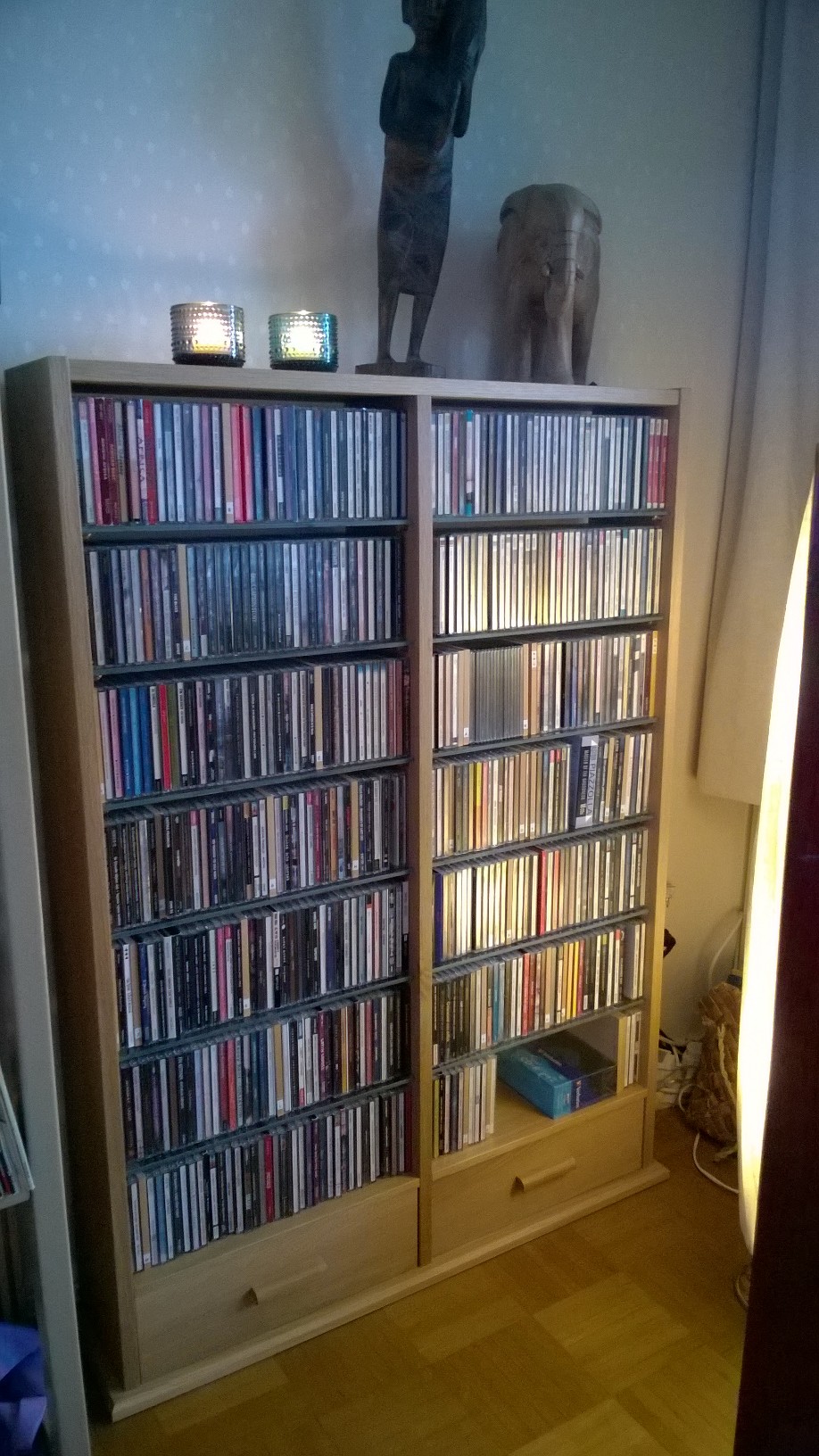

CD shelf finnished
Here's my new CD shelf. Designed it wirh SketchUp and built it using Oak. Fits some 540 CD's, plus some storage place. I think it looks quite good. ;)
If anyone wants the plans, just send me a message.

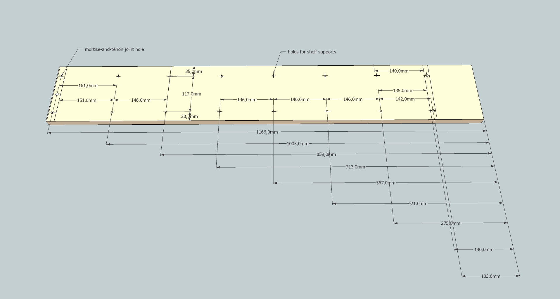

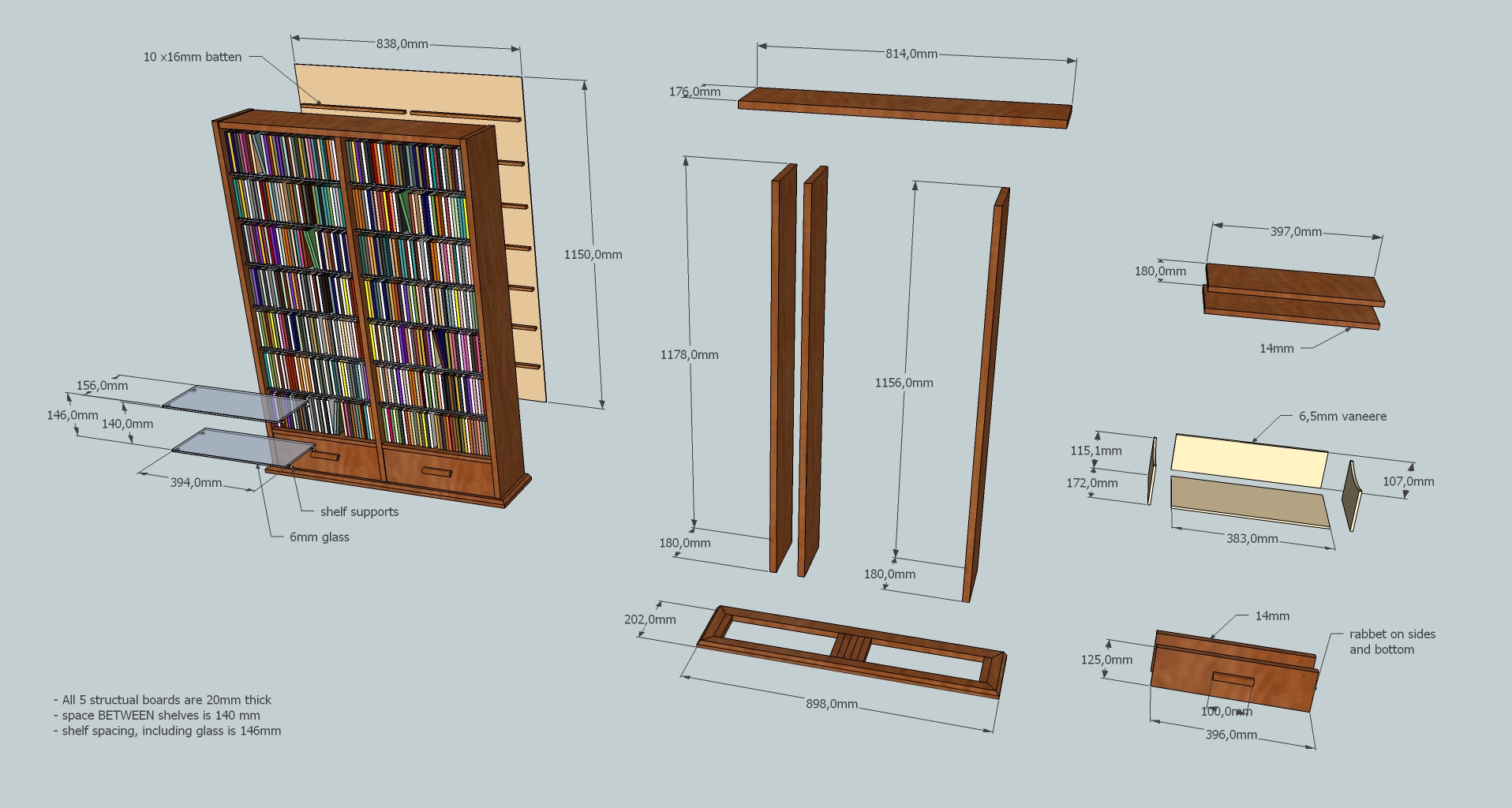

Ron,
I'm not finding any way (without links) to attach the pics within PM, so here they are. If measurments are needed in inchies, that can be arranged. :)
If questions, please ask.
- Jukka

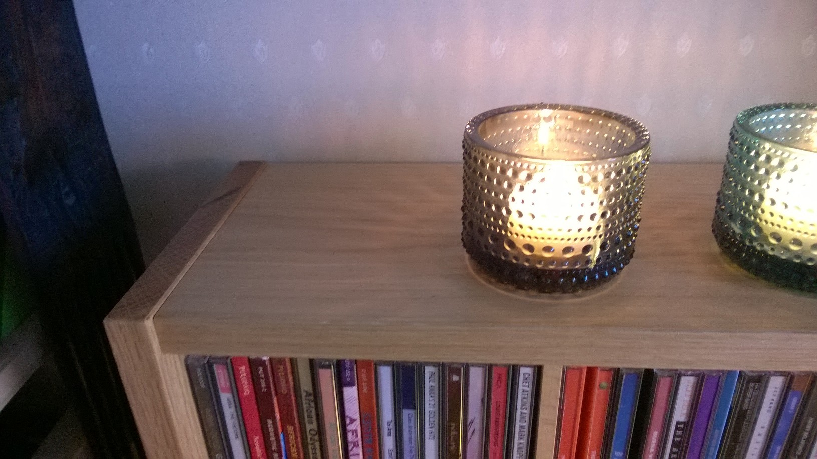

Btw. the top board is deliberately 4 mm narrower than the side boards - and also the side boards reach 2mm above the top board surface. These details bring a little vividness and style to the shelf. :cool:
And also since the top board is 4mm narrower, the middle board has to be tapered the same amount from the top end. I started the tapering 140mm (one shelf gap) from the top.

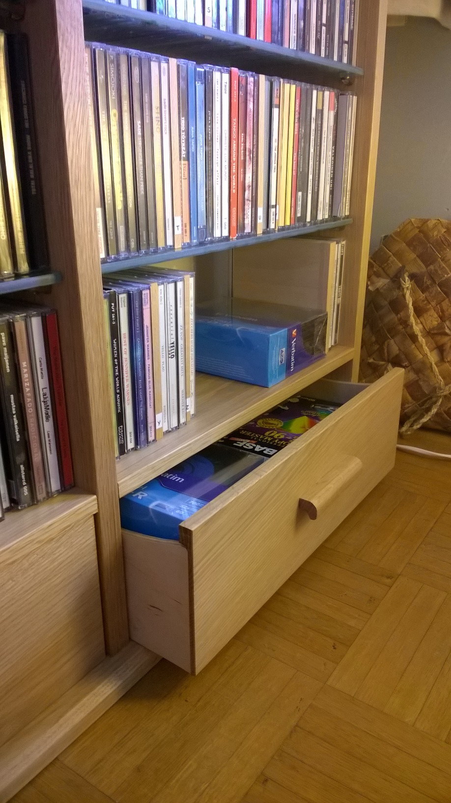

Also the drawers are made to be recessed about 2-3mm. I think this gives them a better appearance than being stationed exactly at the edge of the shelf.
The shelf can also be made less deep if one wants, but I though 18cm gave a balanced look.
