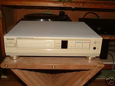

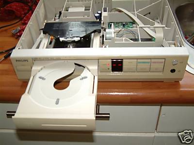

As a DIY hacker, I believe an older transport with a CDM-4 is pretty tough to beat for Red Book. They made millions of them and they seemingly last forever. The old Magnavox models are a great source, easily upgraded and I2S can be plucked off very easily. No NOS for me, I upsample.
