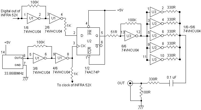

SONY CDROM clock upgrade & relock S/PDIF
I'm planning to upgrade the clock & reblock S/PDIF output for a SONY CDROM. It's chip set is MT1136AE & MT1198AE. The clock rate should be 33.8Mhz. The schematic is base on http://netcity6.web.hinet.net/UserData/prbetech/DSIX_mod/DSIX-1.htm. The oscillator will be replaced by Kwak clock to save money.
Since I didn't have experience to handle digital circuit, I want to get the connection diagram of MT1136AE & MT1198AE. Is there anybody can help me?

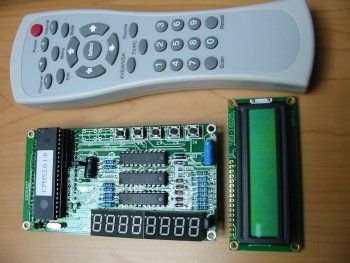

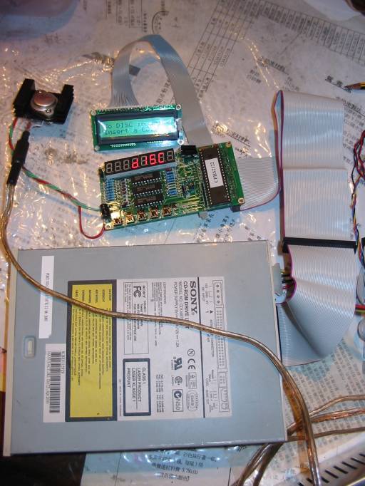

Buy CDROM controller kit
It is a single chip computer broad. It connect to a IDE CDROM with a traditional ide cable. Attached was the photo while I testing the kits' basic function. Some more LCD messages photo can be found on http://albums.5687.net/cdrom_cdp/.
I had registered at the 3cc club before purchase the kit.
The cdrom player will be installed base on the sample of http://netcity6.web.hinet.net/UserData/prbetech/iNFRA/iNFRA-1.htm
