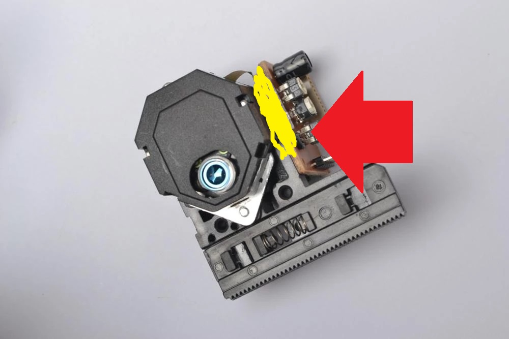

You could try finding a bit of metal instead of the black tac, gluing won't help you need to add mass
EDIT: I found a pic of the metal that was the fix on the arcam
I tried adding two washers to the pick-up: the overall weight increased from 27 to 30 grams (10% increase) but that did not make the slightest difference...
I wonder how much weigth is the Arcam fix adding to the pick-up; the KSS-213C is lighter than the 240 so i was hoping 10% would enough to shift resonance frequency.

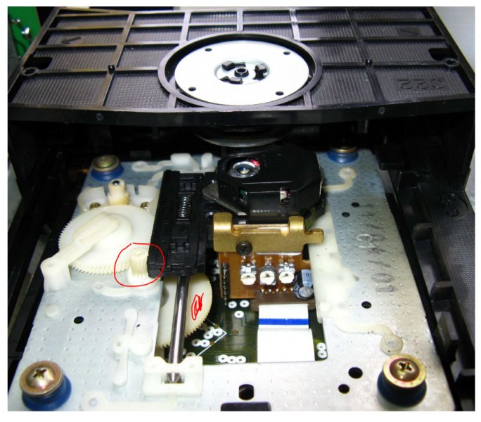

I have another Sony CD player with a similar issue, it is a CDP-M33 using a KSS-240 pick-up and an auto-calibrating servo: with some CD sometimes it start skipping back and forth with no reason; tried two different (working) pick-up's and same problem. I did some test and if I adjust the EF balance pot on the pick-up while the CD is playing, it stops skipping, but as soon as the servo does another calibration, the problem reappears.
On the other hand, a CDP-415 with KSS-240 (still Sony original) and auto calibrating servo board, reads everything with no problems. The servo board is a later version (BU-5DB10B in the CDP-415 versus BU-5DB8A of the CDP-M33) so maybe Sony fixed the problem.
