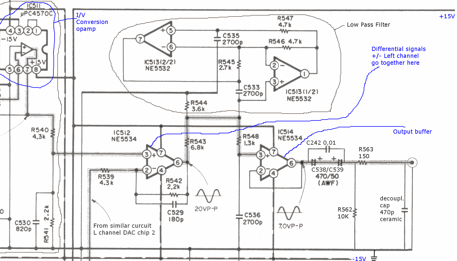

Hi
Taking away the filter and buffer is a really good idea!
Look what I did to my Denon DCD3560 CDP. This machine is among the best transports available, but born with low-end audio parts in the analog section, see diagram showing left channel.
IC511 is the I/V converter (dual opamp using only one of the amps) taking the I-out signal from the DAC chip. The other DAC chip in left channel goes to another similar I/V converter opamp. Those 2 I/V converters put their signals into IC512. IC512 sends the signal into the filter/buffer circuit consisting of IC513/IC514.
What I did was to replace IC511 with OPA627 (single opamp SOI chip mounted on an adapter PCB. Tiny things that I had to assemble under microscope!!).
IC512 was also replaced with OPA627 normal DIL version that fits directly.
All the OPA627s are decoupled with 100nF caps between + and - pins to ground and a 330nF cap over + and - pins.
C533 and R548 are removed and a lead from between R543/544 is soldered directly to the junction between R563/562.
C513/514 are removed to prevent unnecessary power consumption.
C538/539 and C542 and the ceramic 470pF decoupl. cap at the rca output are removed.
All resistors in the signal path are replaced with carbon composite and the small caps (C529/530 and others behind (not visible in the diagram) IC511 are replaced with silver mica.
And Voila! The sound is open, dynamic, transparent, coherent and very much more engaging than before the mods. Even though the sound is also somewhat brighter it is not harsh or rough, on the contrary. Much more silk an less sandpaper.
