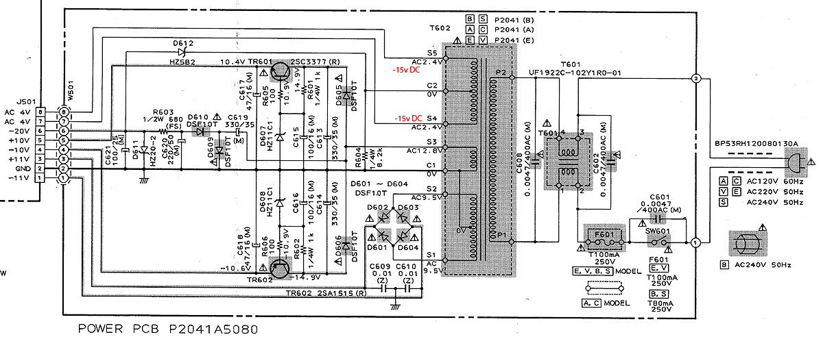

I'm struggling with my old Akai CD-62. After simple cap&opamp replacement at the signal paths, transport stopped responding. Sometimes it reads cd's for few minutes, sound is heavily distorted. After a while it does not respond at all. I checked my replacement parts orientation & compatibility. I also checked solder pads and traces. Couldn't find anything. I removed power supply feed from the main board and checked psu readings. Pin readings are correct, except Pin 7&8. There should be 4v AC voltage, but readings shows 2.4V ac & -15V DC! In the meantime STA341M gets really hot in few minutes. At the schematic STA341M feeds by +/-12V DC, I checked STA341M Pin 1&Pin 5;both reads ~6,5V. Final note; If I connect power supply to main pcb, all dc voltages at the pins goes down.
At first; how is it possible to have -15V dc at S5&S4?
Am I missing something?
I attached PS schematic.
Cheers.

The circuit diagram appears to say that the centre-tap on the AC winding is attached to a -20V rail via a 6.2V zener. I assume this is a heater supply for the display. I would expect to see something like -14V DC here, so -15V is probably fine.

As DF96 says, the PSU readings appear fine. You have to accept your problem is a man made issue and so you need to go over all the work you have done previously. Are the opamps correct (not fitted a single for a dual or vice versa). The STA getting hot may or may not be normal, I wouldn't just rely on that as a symptom though.
DF96 & Mooly, thanks for the replies. In stock form it has M5532 opamps. I replaced them with OPA2134 and surrounding ecaps. Both opamps are dual channel. Anyway, I'll dig deeper tonight. Let's hope I didn't destroyed something!
