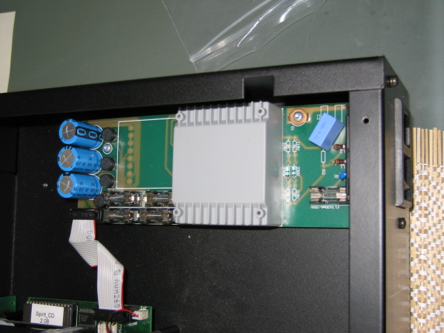

Do you have a schematic for the CD player. Is this bridge part of a linear or SMPS ? A photo of the board layout would also be helpful.

Hi Jon, trying to find the camera-need fixing thus unable to provide a layout of cd board-i don't have a schema for the cd player.
i think moving the transformer/capacitor onto the veroboard would be too much for a newbie like me.
The bridge rectifiers(4)is supplying for all the analogue n digital boards-?linear?SMPS.

I really need to see a photo of the psu before going any further.

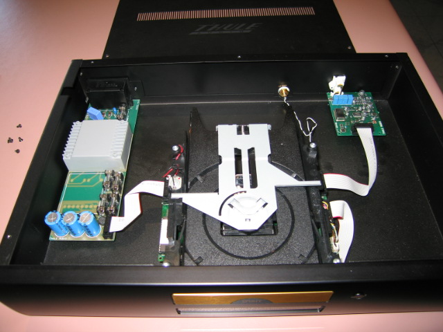

Hi guys, trying to fix the camera for a picture-like they say-worth a thousand words!!!!
i am still not sure what to do-
tubenut-do you have a picture of what you do to replace the bridge rectifier?
i have received the Hexfred TO220 yesterday-can't wait to get my hand to it.
Jon-here comes the picture.

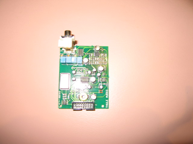

Hi guys, iwould also like to bypass DC blocking caps-are they those blue ones that is next to RCA out?
Any suggestions regard rectifier bridge replacement?-Thanks+++😕
